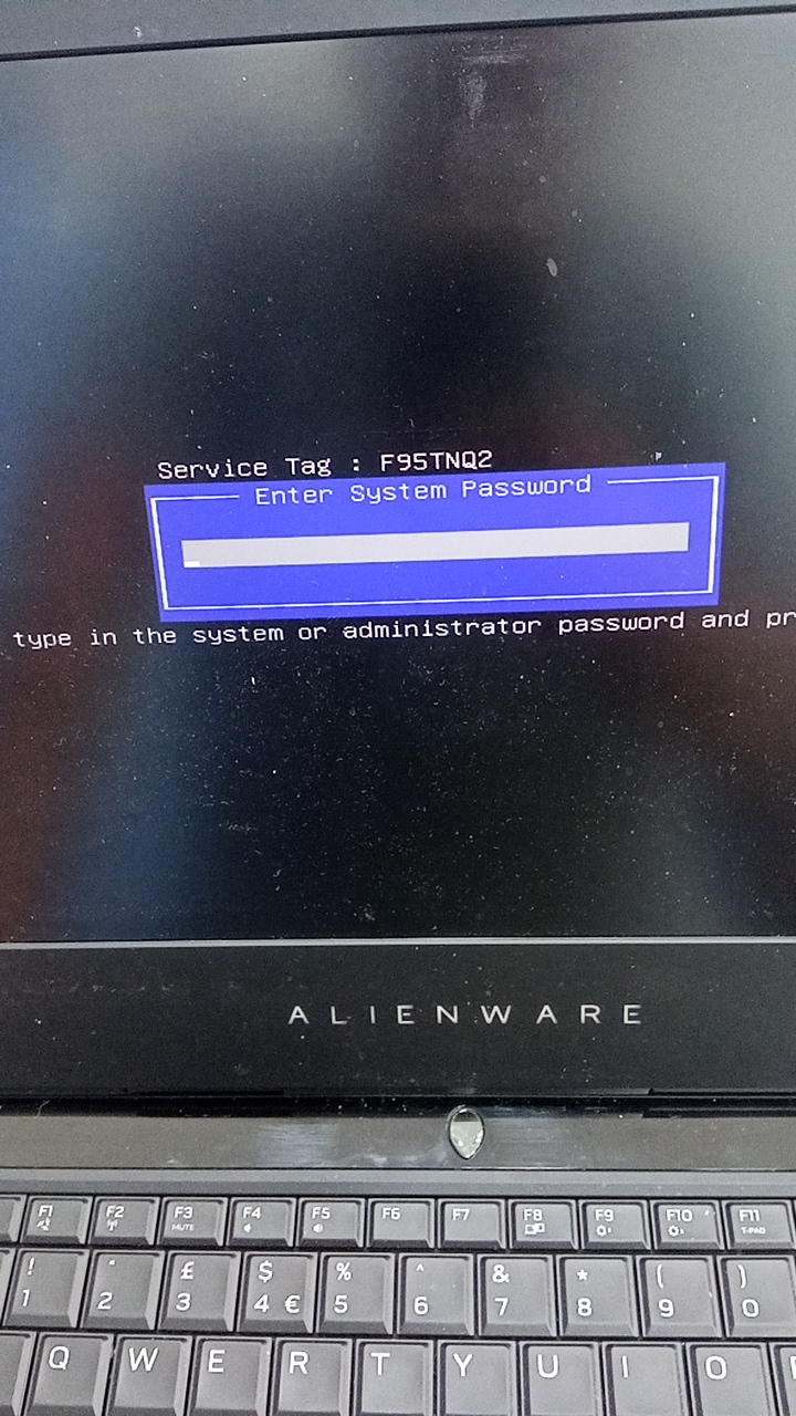

    Hello bro
    I need remove password plz help

      Re: Alienware 17 R5 LA-F552P Bios
      Originally posted by mouhmmc
      Hello bro
      Service Tag : F95TNQ2
      Password : 2EFB12B4
      2 - ( digit )
      E - ECHO ( UPPERCASE )
      F - FOXTROT ( UPPERCASE )
      B - BRAVO ( UPPERCASE )
      1 - ( digit )
      2 - ( digit )
      4 - ( digit )
      In laptop: Type in the system or hard-drive password and press <Enter>.
