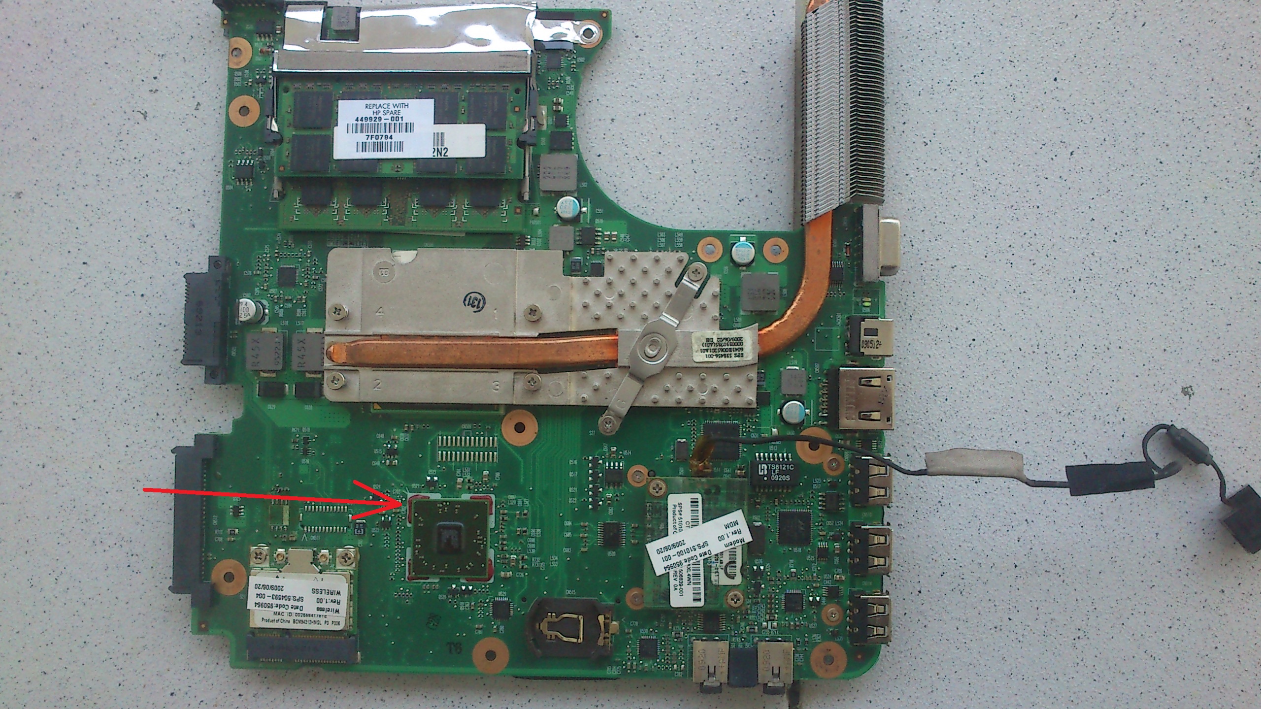

                      So, the problem must be in the Graphics chip. But. Which is the graphics chip?
                      Is it the one pointed by the red arrow in the photo?
                      • piernov
                        • Jan 2016
                        • 4437
                        • France
                        Re: BIOS file for HP Compaq 615
                        That's the southbridge.
                        The dead chip is usually the northbridge, under the heatsink next to the CPU.
                        Before you do anything crazy, do *NOT* attempt to reflow it. You can try to heat it a little bit (200°C MAX, no flux) for a minute and a half with hot air to see if it comes back to life. This is not a fix, it will fail again and it has to be replaced.
                                Well...it worked!!
                                I did heat it (no reflow, just heat) with a heat gun, reassembled and it works!
                                I didn't expect this to succeed!
                                Now, how long will this keep working, I don't know.
                                Maybe hours, maybe days, maybe months?
