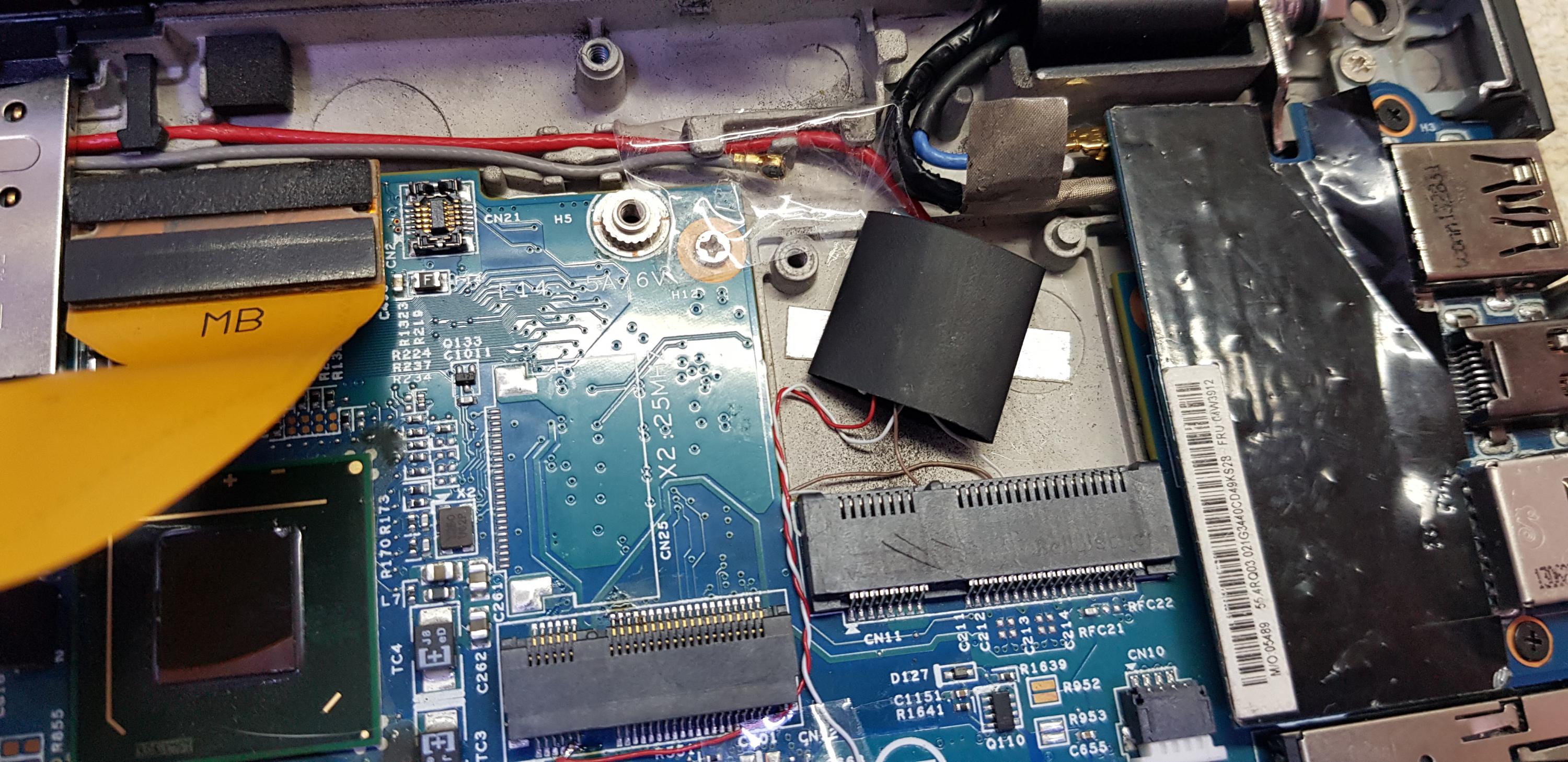

    Hello to all, need help with editing bios to remove whitelist and works with miniPCI cards. May upload dump if need.

      Post here bios dump or i need error photo.

        From start i byu this device without any wlan card . My error is to use standart minipci card in wwan slot, i edit bios and startup error with whitelist is successfuly passed but adapter not seen in device manager, than i think in other direction (schematic of mainboard very helps me) and use usb wlan module from poor chinese tablet (rt8188) by wiring it from cn12 usb and 3.3 / GND lines . In the end wifi works good without original wifi card . bios dump.

          that works normal, interested mechanism of wwan lock on hardware level or i not understand right?
