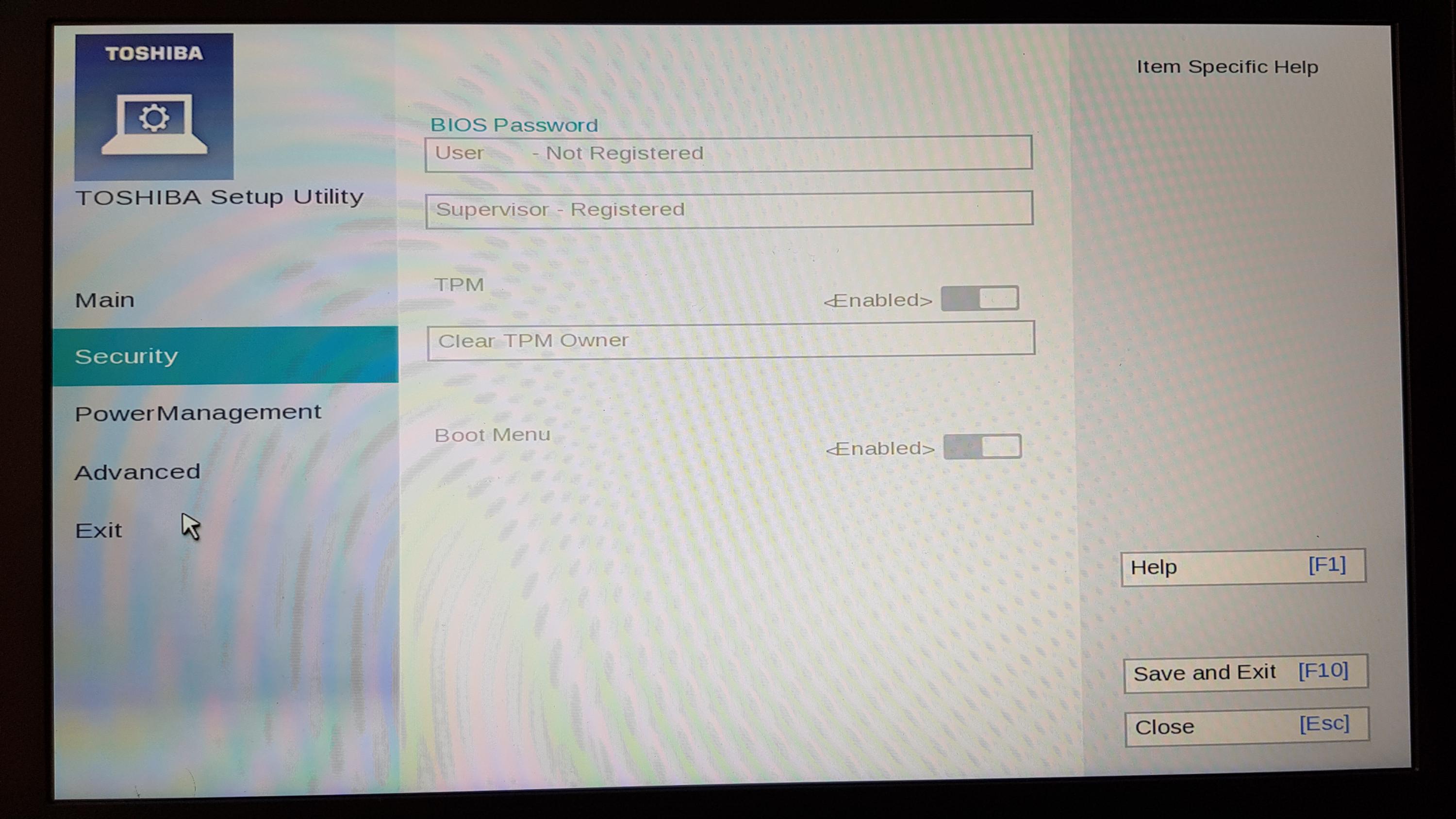

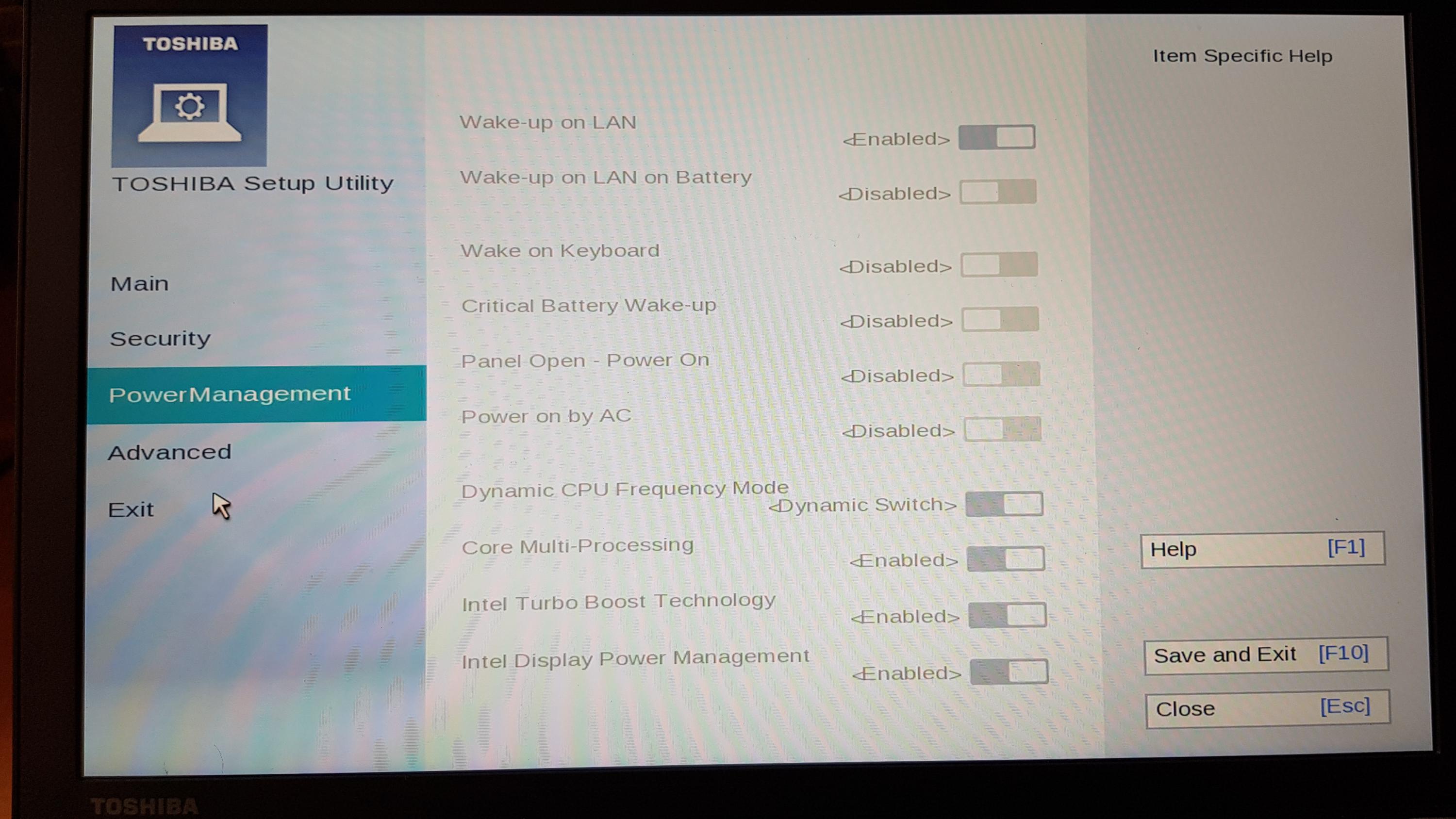

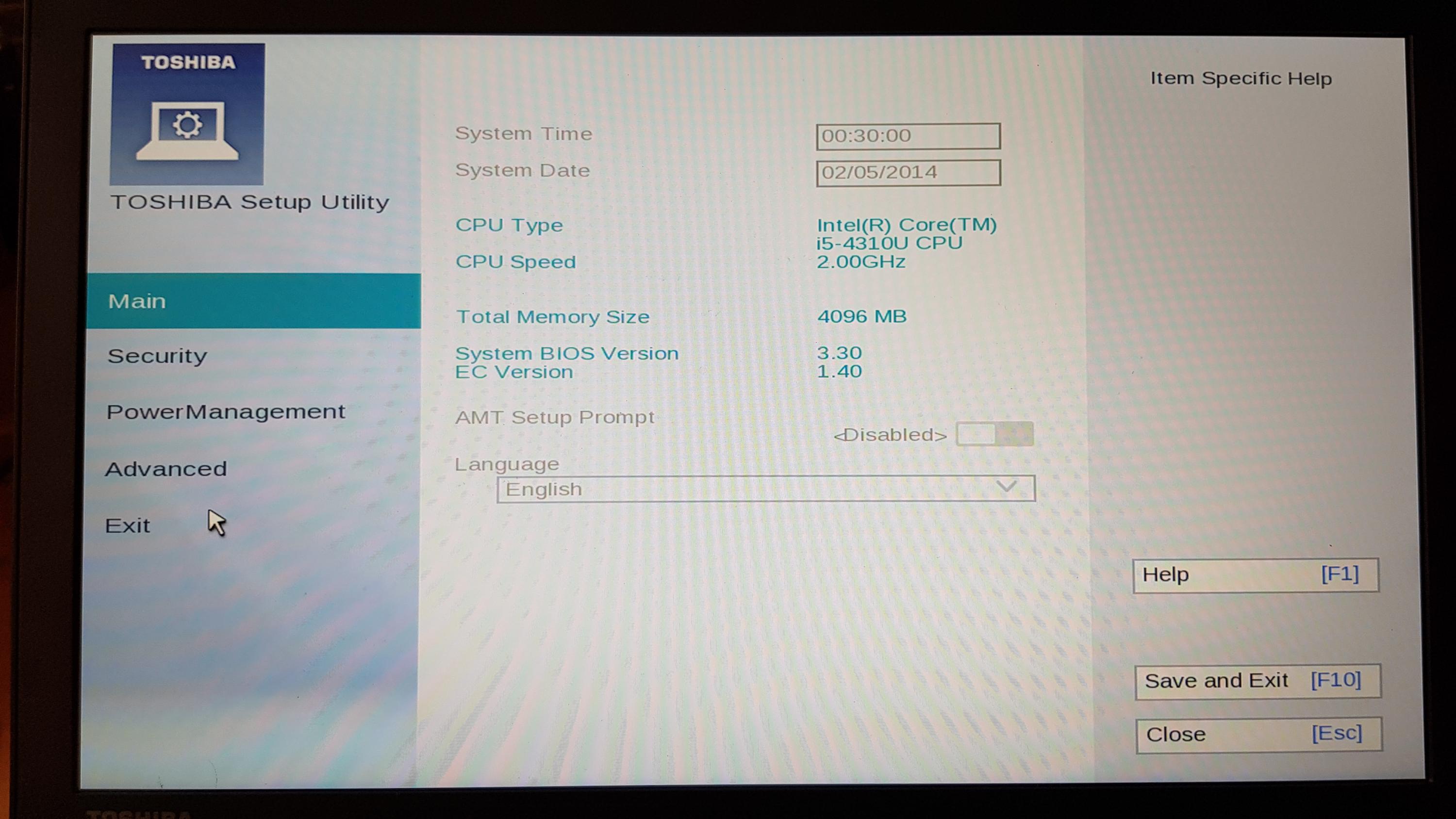

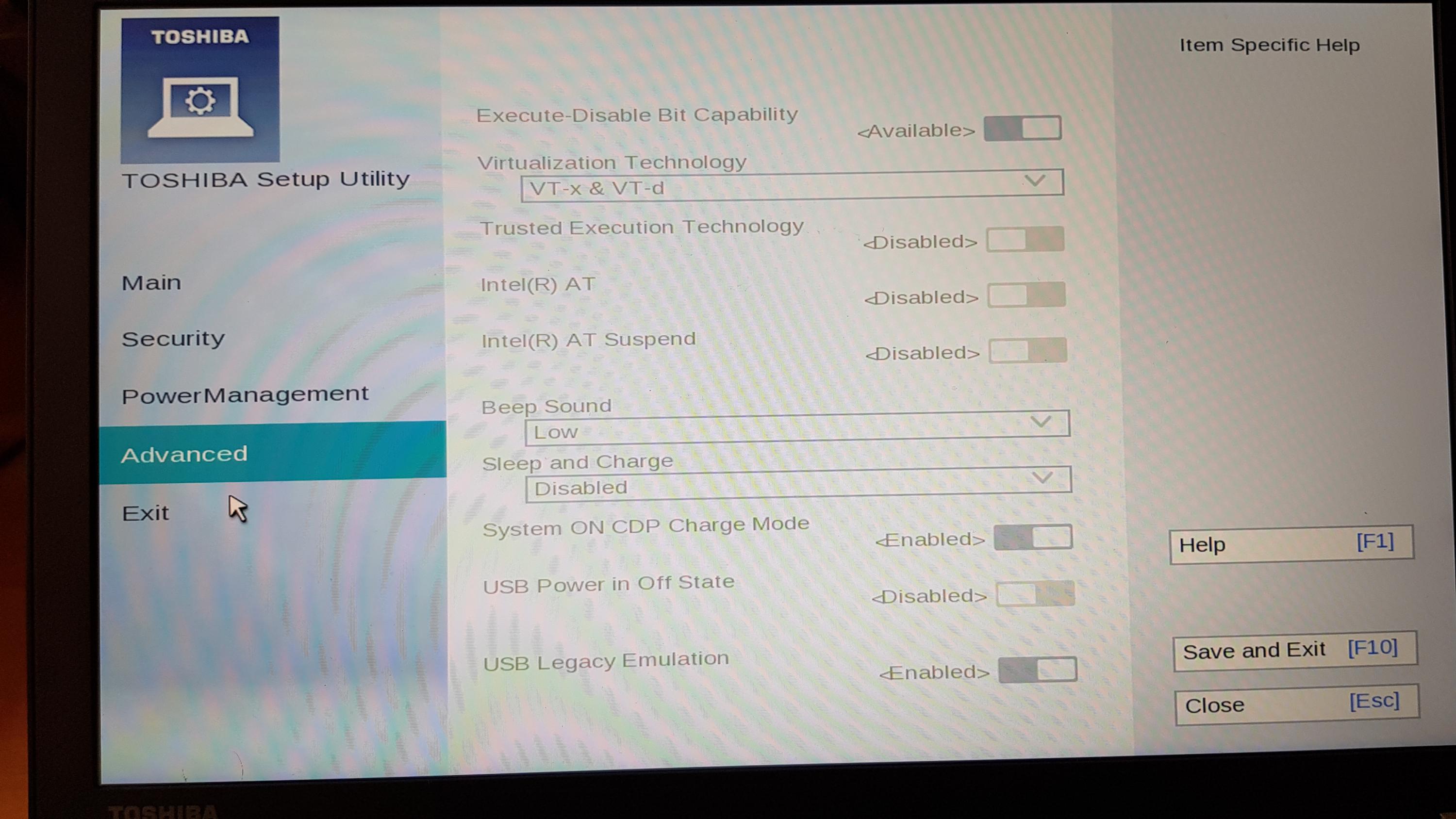

    Hi there
    I have Toshiba Tecra Z50 with supervisor active.
    Press F2, enter the bios, but everything is locked.
    I can't change anything!
    Any help please?

    Re: Toshiba Tecra Supervisor Password
    Any suggestion?
      • 20884
      The password isn`t stored in the bios, its in the SMSC chip. JTAG access is blocked,replace with one from a donor board ,or use the challenge code response if there is one.
        I know it's in the SMSC chip.
        I was thinking of a similar Lenovo solution ... but ...
        For challenge code ... don't ask for the password, enter the bios directly! Combination
        CTRL = TAB = CTRL = Enter not work!
          • 20884
          Try left CTRL - TAB ,right CTRL - ENTER
            I know, after multiple restarts, it worked!
            Serial: 4F020157H
            Challenge Code: GEVUE-D8N8Y-8C7F8-KDAVF-YDWKX
