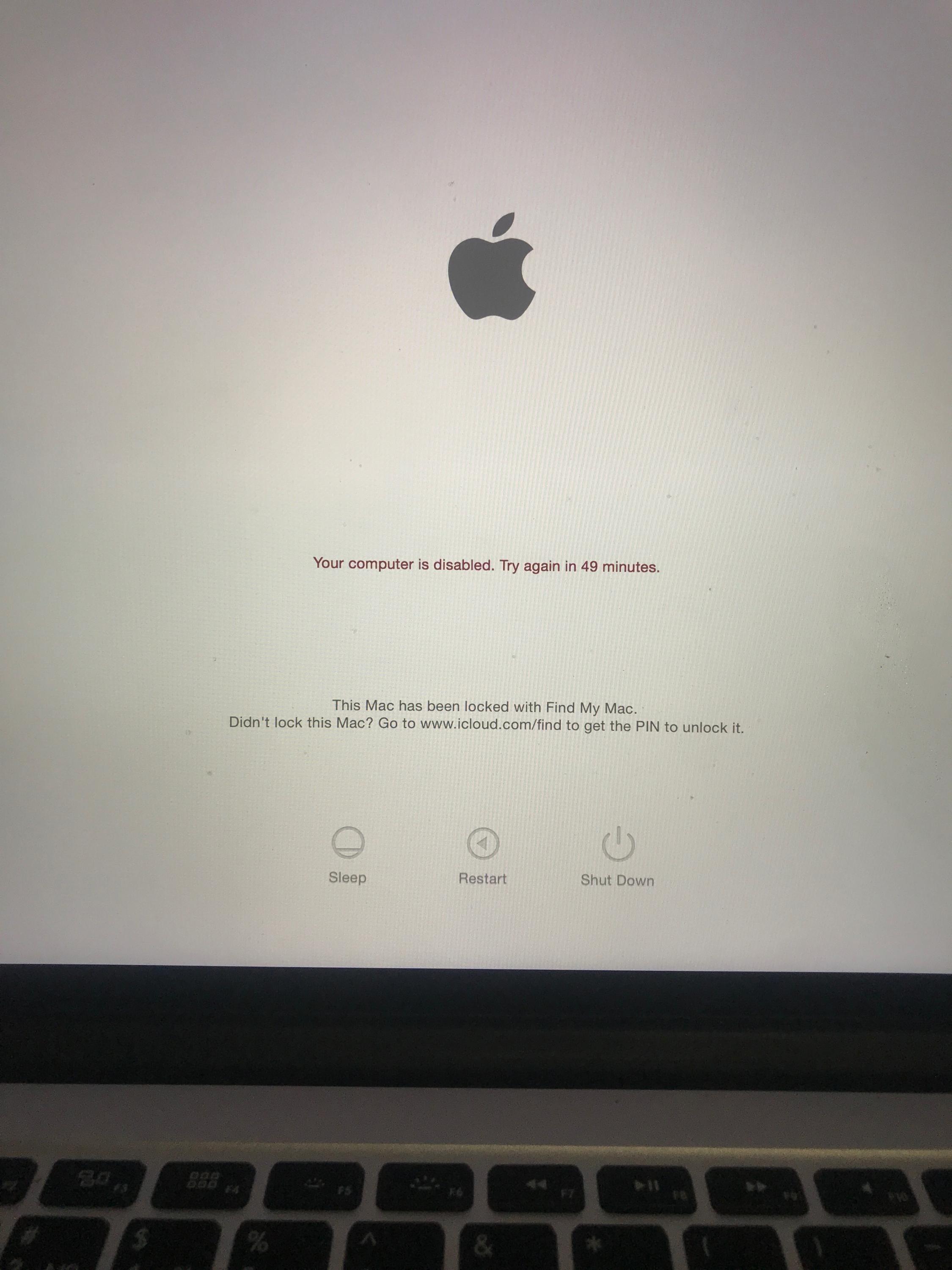

                          Macbook air a1465 password
                          820-3435-a
                          can you remove the password from the original bios?
                          • alihomee
                            • Dec 2012
                            • 1577
                            • malaysia
                            Re: Macbook air a1465 password
                            test and report
                              • bilen
                                • Aug 2014
                                • 638
                                • istanbul
                                Originally posted by alihomee
                                test and report
                                the initial password is gone but it gives this error. I can't install new system
                                • bilen
                                  • Aug 2014
                                  • 638
                                  • istanbul
                                  Originally posted by CammyTier1
                                  asks for password
                                    • 21100
                                    https://www.badcaps.net/forum/showpo...42&postcount=4
                                    3.2.2. 2012 to 2017
                                    For 2012 to 2017 machines, BIOS must be edited and reflashed to clear the password. There are 2 methods for this:
                                    Clear out the whole SVS store. There are other stuff in this store, no idea what they are for so better avoid doing this.
                                    Invalidate the CBF2CC32 NVRAM variable in that SVS store which contains the encrypted password. You just have to change one bit in its name, so like replace the C with an A or whatever. Note that strings are UCS-2 encoded, so in the hex editor it'll show up as 0x43 0x00 0x42 0x00 0x46 0x00 etc.
                                    If there is an iCloud pin, you need to perform 3x PRAM reset after removing password. If FindMyMac is still enabled, you have to reinstall macOS while being disconnected from the Internet, then reconnect after logging in and bind to a new Apple account.
                                    • bilen
                                      • Aug 2014
                                      • 638
                                      • istanbul
                                      3.2.2. 2012 to 2017
                                      thank you king
