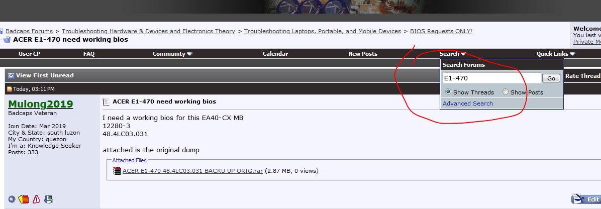

Use the forum search.....

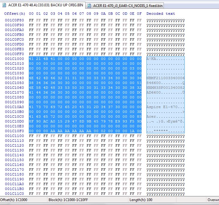

The bios posted by ala_borbe is tested good. If you want your original DMI info copy it from your dump with a hex editor.
1C1000-1C10FF
