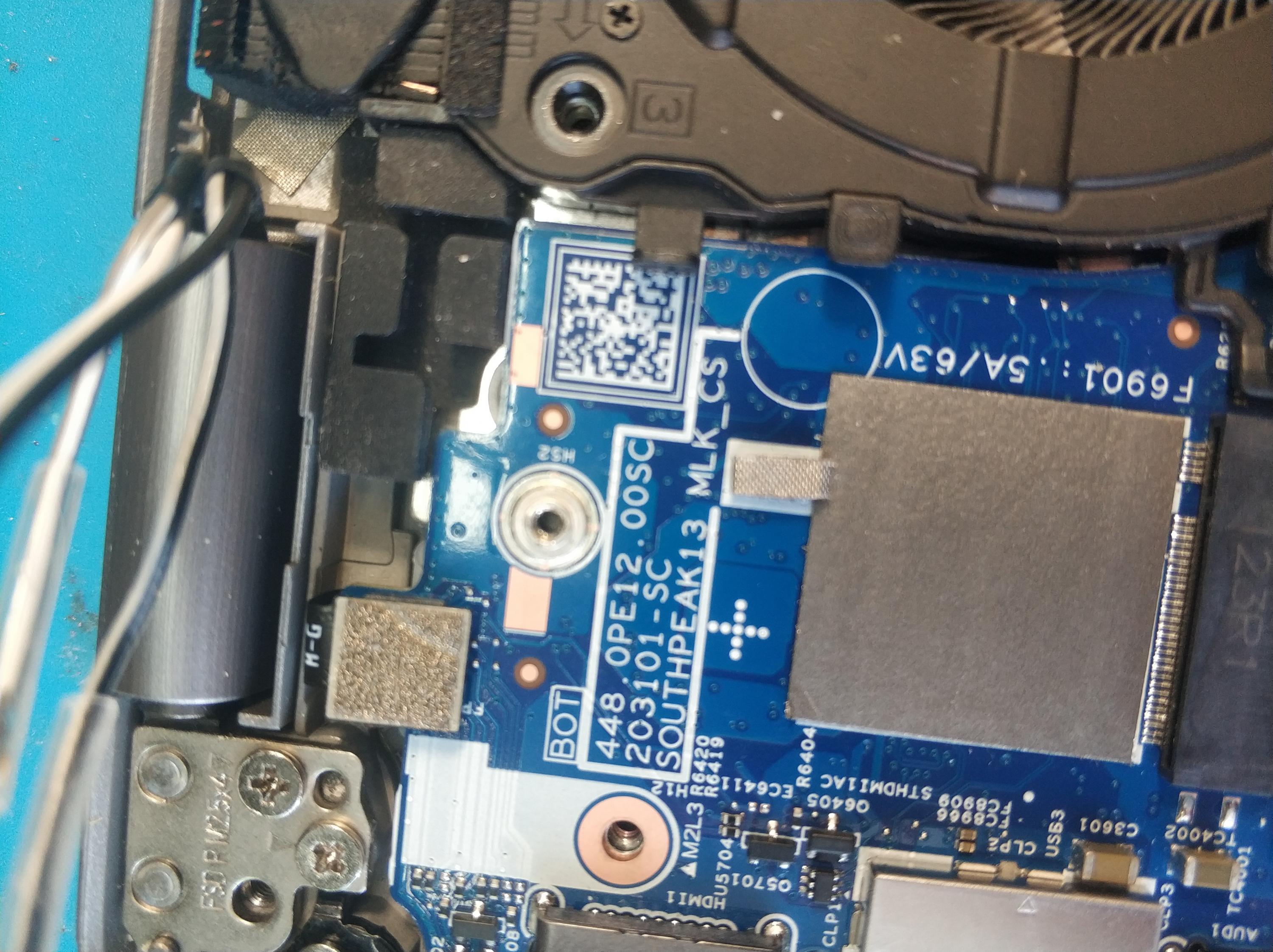

          Dell latitude 5330 Southpeak13 MLK_CS
          448.0PE12.00SC
          203101-SC
          With this Bios, there is a reaction to the inclusion, but there is no initialization. The problem arose after updating Bios for win11.

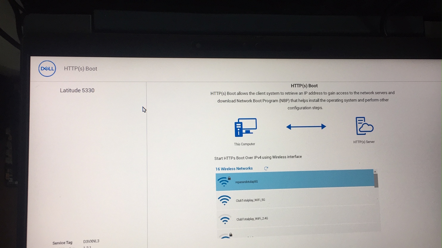

                          Greetings please help me with this bios locked both absotute and network lock

                                    Greetings, I have a problem with secure with dell safebios, my backups are correct, previously they had told me that they were not read correctly, but I have already recorded them on several occasions on the machine and if they work, please help me to eliminate that security
