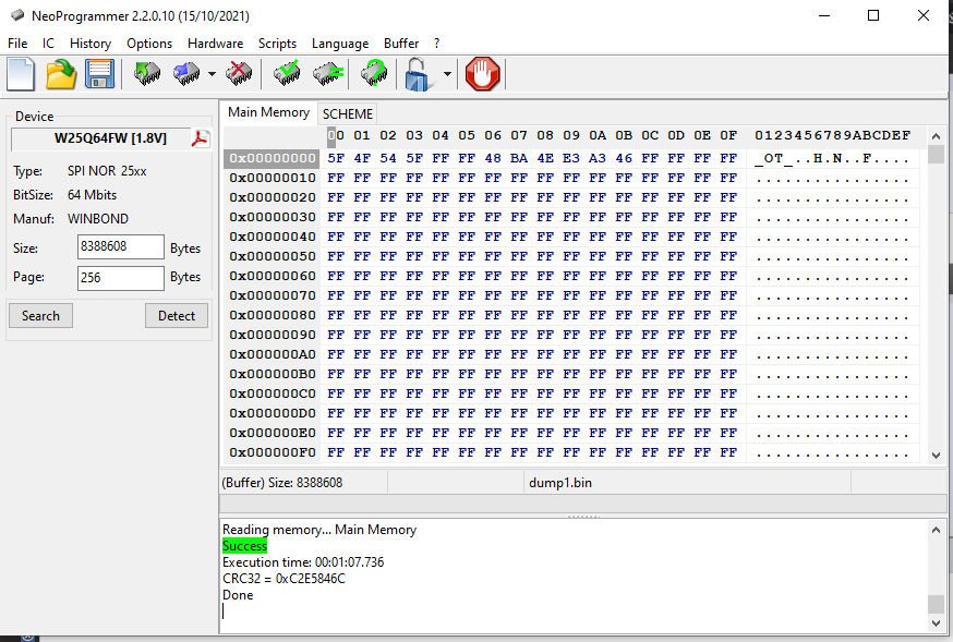

                Hi guys, I'm hoping it won't be a problem to post so long after the last message, if so, let me know and I'll open a new thread.
                I have the same laptop indicated in the first post, and by what I diagnosed the issue is most likely a corrupted bios.
                The information of the machine is as fallows:
                Model: 15-BW019NP
                Motherboard: CTL51/53 LA-E841P
                rev:2.0
                Bios Ver. F. 11
                SPI IC: WINBOND 25Q64FWIQ
                The symptoms:
                Pressing the power button, the equipment turns on, doesn't display logo, backlight stays on with no image. Shuts down after a couple of minutes.
                Pressing the power button and F9/F10 do their respective functions, althou I can't boot from any external device or disk.
                In bios there is an evident anomaly, with or without the internal disk plugged in, the name of the disk IS listed on the booting devices options. Pressing enter over the disk unit in the list shows the name of the disk but totally freezes the bios menu, once even giving a screen artifact that covered the whole screen.
                Trying Win+B Bios recovery with the image on the internal disk or a pre-prepared usb flash drive with the bios version on the official website both ends with the message "The system bios recovery failed to verify..." e.t.c.
                I do not have a programmer with me right now so I can't make a dump of the file and post it, but in the next 2/3 days I might be able to do it.
                I have a question before reflashing the bios, as this isn't one of the most common repairs I make, I lost some information which once had.
                I mentioned my SPI IC, the one I intend to solder on my programmer and reflash using one of the dumps available here, but some of the files available also have an EC file, that if I still remember from a similar issue I solved, is the part referent of control kb light, fan speed, special buttons e.t.c.
                But I can't remember how I actually done it. I kinda remember there being 2 ics and flashing both with their respective dump, but as far as I remember (I cannot check right now), there is only one ic in this board.
                I would say that I should flash the file "HP 15 bw series LA-E841P Rev2.0.bin" from "HP 15 bw series LA-E841P Rev2.0.rar", but if so what is "HP 15 bw series LA-E841P ENE KB9022Q.bin" used for?
                I apologize for the lengthy post. I will deeply appreciate it if you can show me the right way.

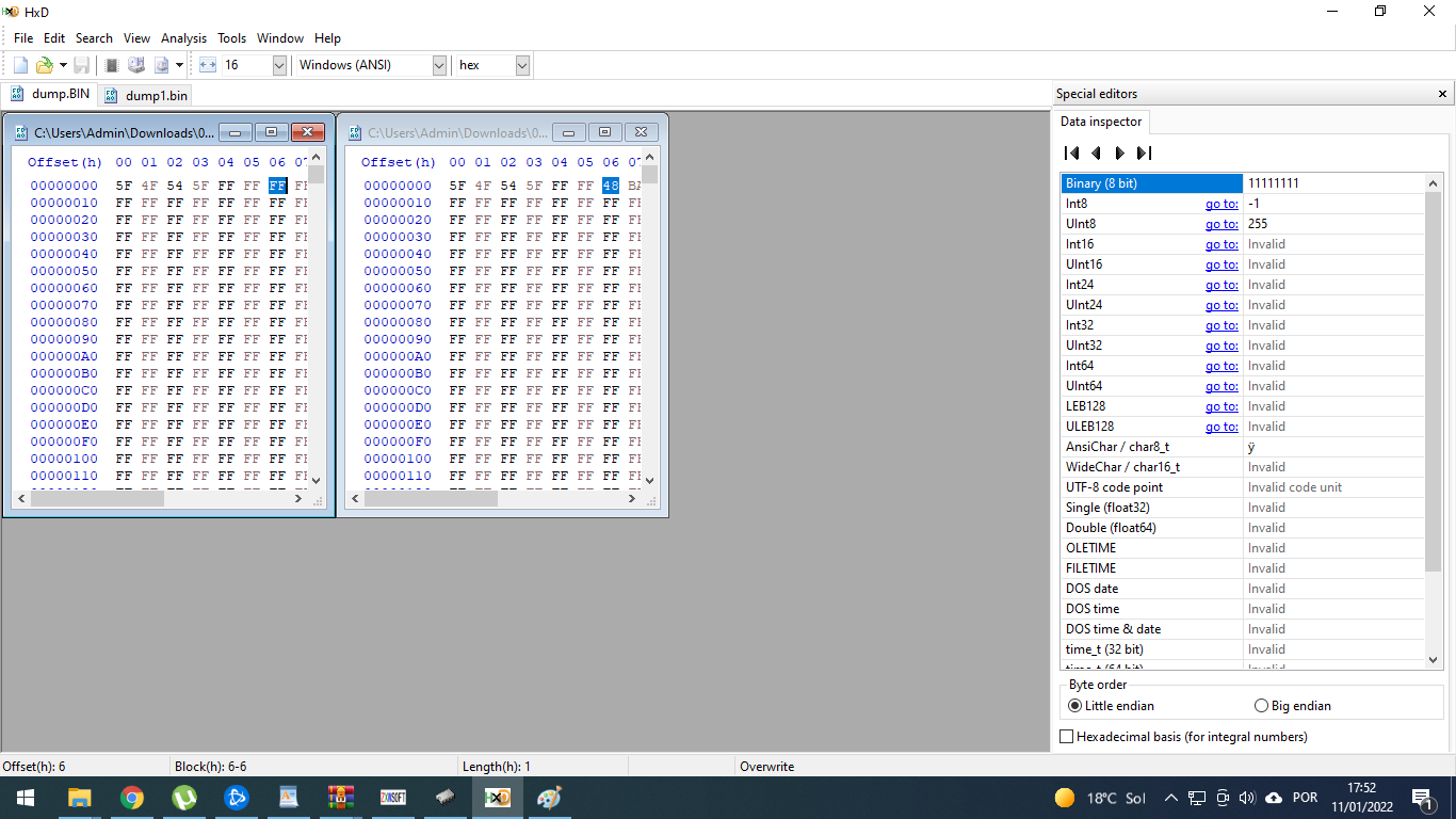

                    Hi, and thank you for your quick response. I have done a few dumps and compared them using HxD. You can find the dumps in the attachment.
                    When you say the EC bios is stored in the I/O chip, do you mean the big I/O 128 legs controller? I'm pretty sure I never had to program one of those, I don't even own a programmer for that or had in idea that it could be programmed.
                    I will assume it is not this ic, although looking at the mb from both sides, I can only find two other SOCs which I'm pretty sure ae there for other reasons.
                    Please let me know if I can supply any more information, and once more thank you very much for your help.

                          Hi. As suggested I flashed the .bin on post # 23. Unfortunately after soldering back on the motherboard, turning on the laptop gives me 5 long 3 short capslock code.
                          I made the mistake to solder the ic without removing the CMOS battery I don't think this is the reason for it not to work but I thought it would be best to report it.
                          Any other options?

                              I have just done that, and I'm now reading back to compare the writing to the reading.
                              I'll come back to you straight away to post the results.

                                Well you are totally right. Something didn't go well. After flashing I compared the memory in the flash with the file I used, and sure enough they ae different from the first line.
                                I added some images. Im using a CH341A MinProgrammer. Maybe is the software version I'm using?
                                *****EDIT***** I DONT WANT TO BE BLOCKED FOR MULTIPLE MESSAGES IN A ROW SO IM EDITING
                                This time I erased the flash and after writing and comparing it the files are identical.
                                I put it back in place and the pc is turns on, tries to boot from disk but something is failing so it reboots. Most likely a reinstalation of the O.S. wil fix the issue.
                                I do have a message as soon as I turn on the laptop which says: "Manufecturer programing mode is in unlock mode"
                                Is there a way to get rid of it?
                                And thank you so much for your guidance, you really were a star!!
