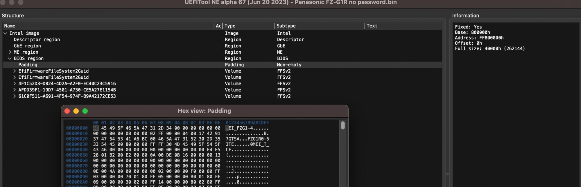

                This is a working bios, no password. I share it, it may be useful to someone else. Thank you Andrew_R and rioreno for your help.

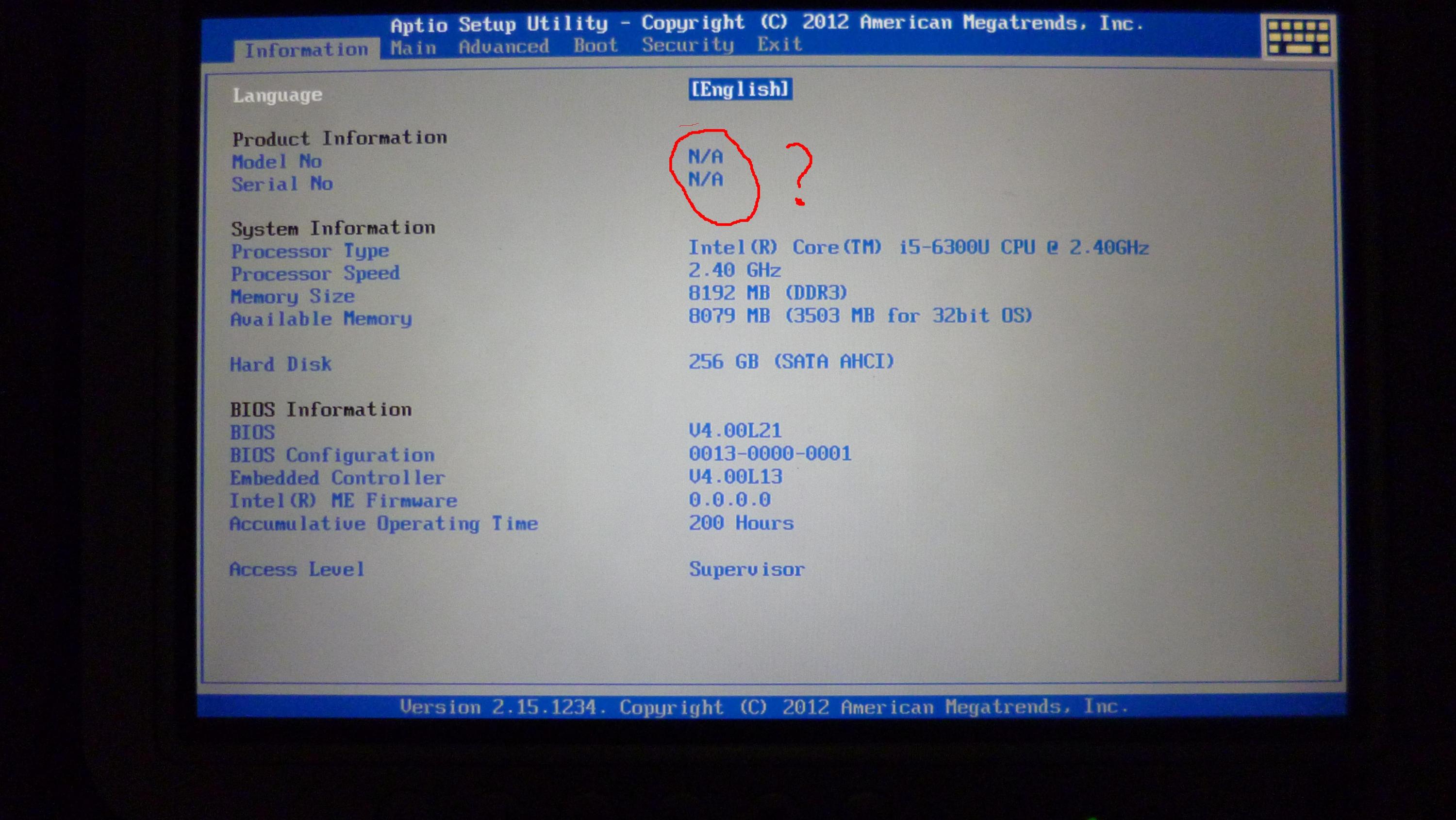

                  Hi
                  Anyone know how to enter model and serial number in this bios? And additionally, after starting the tablet it needs 15 seconds before the bios begins to load (bios clean region?)

                    Re: Need Panasonic FZ-G1R (mk4) Bios DHLB1030ZD/X1
                    By the way what is the best way to upload this bios, I'm using AfuWINGui Aptio V, but I'm getting a 43 error problems erasing FLASH
                        Originally posted by kicaj
                        Hi
                        Here

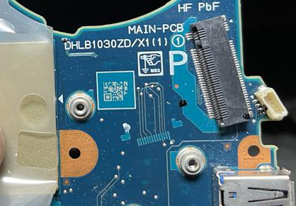

                                Another question, pals. I have two motherboards. 1st one have blue mark on BIOS chip, the second one have orange mark. The same boards, but just little bit different BIOS? The same sh..t with EC, color marks.

                                      Hi there! Recently got Toughpad FZ-G1P6-05VM After installing fresh Windows 11 it found various driver updates and "Panasonic firmware" update among others. It asked for reboot and after reboot tablet stuck on "Please wait..." screen. After waiting for a whle I've tried to reboot it, now screen is black and looks like I have bad bios. I feel that it is pretty much the same that speedbal dealed with. I would greatly appreciate if you could help me with flashing bios. Couple questions that I have so far:
                                      1. Where bios chip is located on DHLB1030ZD/X1 motherboard?
                                      2. Do I need to desolder chip from MB, or there is way to flash it righ on board with some kind of clip?
                                      Thank you in advace.

                                      Thanks to speedbal I fixed my Toughpad. So it is Touhgpad FZ-G1 MK4, motherborad model DHLB1030ZD/X1. I bought cheap CH341A programmer with clip adapter and made 3.3V mod. Using Neoprogrammer v2.2, made backup of BIOS chip and copied bytes from 0x00800000 to 0x008004B0 from original bios to this one. Then cleaned chip and flashed. Now device works just fine.
