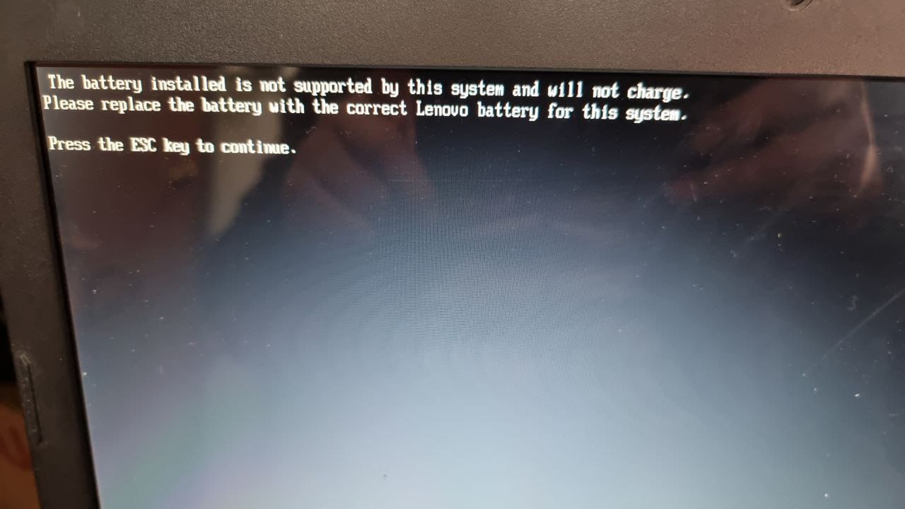

    I have a LENOVO B590 Ive replace it a new battery , but it says the battery installed is not supported by this system wand will not charge.Please replace the battery with the correct lenovo battery for this system.,
    If someone has this kind of problem, Ive read some forum they said its a bios issue that u need to upgrade its bios ..

    The bios has a whitelist for genuine batteries, you need a genuine battery or a modded bios .

          Try at bios-mods. https://www.bios-mods.com/forum/Thre...emoval?page=60
