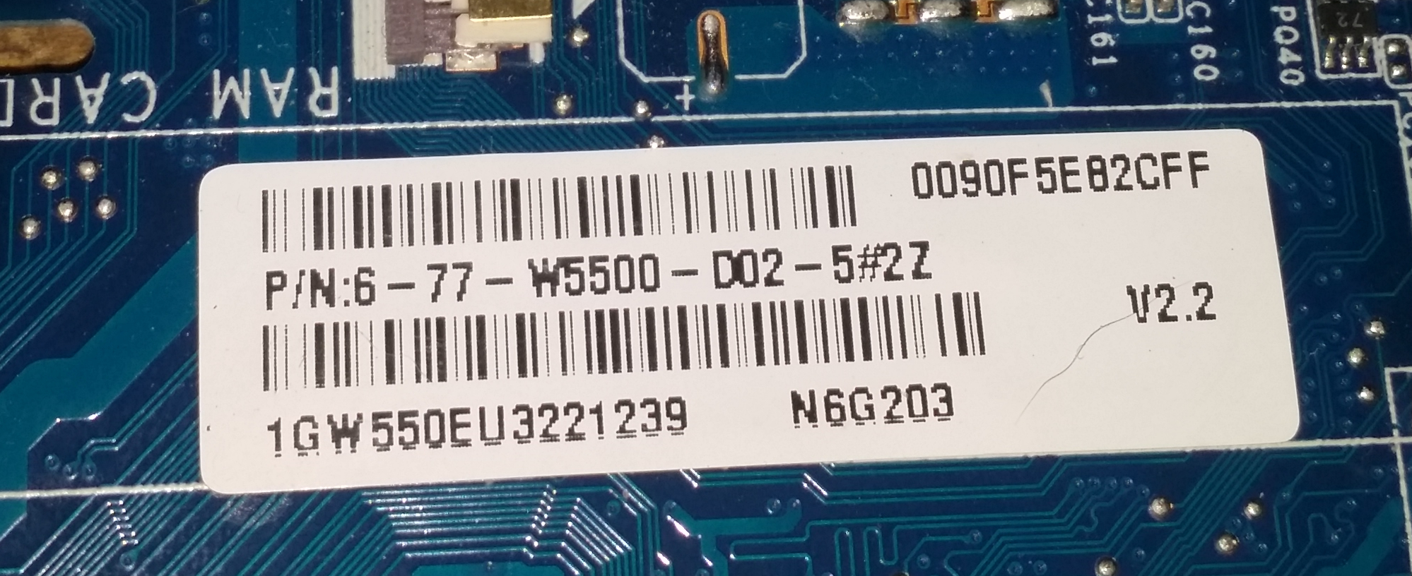

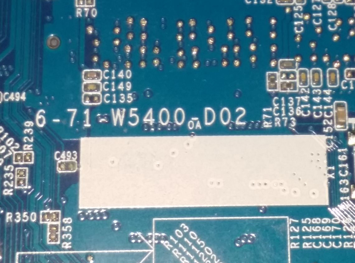

            6-71-W5400 D02 BIOS needed
            Hi, can someone help with proper BIOS for Bangho G01-I318, I think it´s a Clevo W550EU based on tag under RAM ..
            The problem is laptop stuck on bios boot logo "Bangho" press F2 - F7 screen and wont respond to any key press or boot from HDD or USB drive... nothing
            I aldo followed Winraid guide to clean ME region and reflashed image to chip with same results..
            I´m providing original Bios Dump if someone cares to check it´s in working order...
            Thank you!

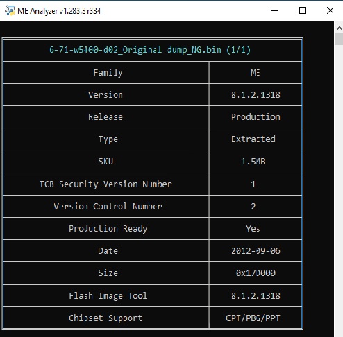

                Well, first place I found yesterday and downloaded latest W550EU yet ME version and SKU does not match original is SKU 1.5MB and repo is 5MB is that OK ??
                • abel2b
                  • Mar 2009
                  • 34
                  Re: 6-71-W5400 D02 BIOS needed
                  • abel2b
                    • Mar 2009
                    • 34
                    Originally posted by hoaca388

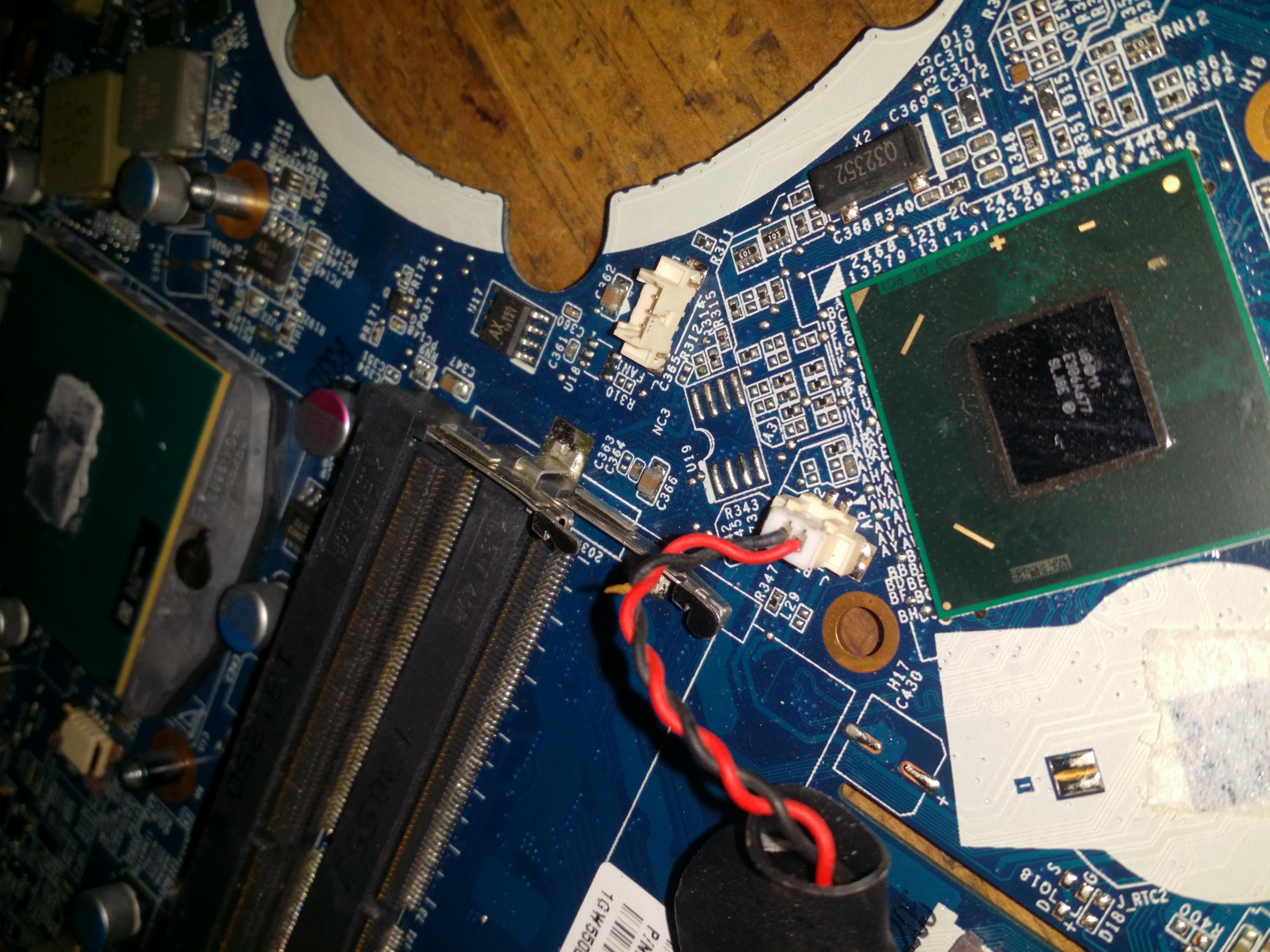

                    Also download from this repo, after I unpack file it has Bios folder and EC folder with .bin for each, yet my board does not have U19 chip corresponding to EC a per schematic and it not missing cause laptop was working as is ... see image

                      Hola...esta al lado del conector de la lectora de DVD el chipo bios en esa version de Mother
                      Hello...the bios chip is next to the DVD reader connector in that version of Mother
                      • Logica8
                        • May 2021
                        • 2
                        • Argentina
                        Perdon...el EC en esa mother viene a ser el CHIP ITE . no trae como tal un chip ec fisico viene el ITE
                        Sorry...the EC on that mother is the ITE CHIP. It does not come with a physical EC chip, the ITE comes with it.
