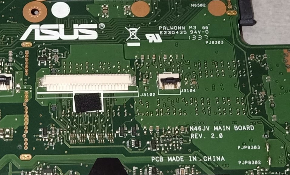

                  I'm new here and joined because I'm currently dealing with a black screen issue on my ASUS N46JV Rev 2.0 laptop.
                  I've already tried several BIOS .bin files shared in this thread (and from other sources), but unfortunately none of them worked.
                  I suspect the issue is with the BIOS firmware, and I'm looking for help to rebuild or repair the correct BIOS file for this model.
                  I have a CH341A programmer and I can provide the original dump file taken directly from the BIOS chip.
                  Any help or guidance would be greatly appreciated 🙏
                  Thank you!

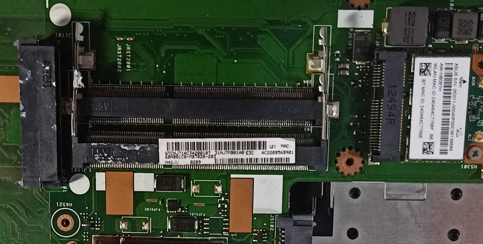

                    post S/N, full name and model, motherboard model, etc.
                    post the contents of the bios chip even if it is corrupted..
                    Take pictures of the stickers on the motherboard in the RAM area and post them here.
                    The bios chip must be unsoldered from the board before writing or reading..
                    do not use the clip, you may have errors..if you do not have anything to unsolder it with,
                    solder wires between the programmer and the bios chip..
                    you need an SPI programmer...here is a video for example..https://www.youtube.com/watch?v=DWWi...nnel=ThisIsHow

                      Here is the requested file. I have attached a picture showing the serial number, motherboard model, and the sticker located near the RAM area. I've also included the contents of the original dump file from my BIOS chip.

                        nothing is visible in the first picture...take a clear picture...and the S/N and the data key, write them with the keyboard here....don't post pictures of these things anymore..
                    • nduterz
                      • Apr 2025
                      • 4
                      • Indonesia
                      Hi, thanks for the reply!
                      I've typed the serial number, motherboard model, and the number from the sticker near the RAM slot, as requested.
                      Apologies for the unclear photo earlier — hopefully this one provides the details you need.
                      Serial Number
                      DAN0BC20784643H
                      (I've checked this serial number on the official website, and it matches correctly.)
                      Model Name
                      N46JV-V3026D
                      Motherboard Model
                      N46JV Main Board Rev. 2.0
                      Sticker on RAM area
                      QTCNJ71AC34200107 31NJ7MB01A0
                      L21 MAC
                      E3C AC220B56B01
                      60NB01C0-MB7020-203
                      N46JV 0209
