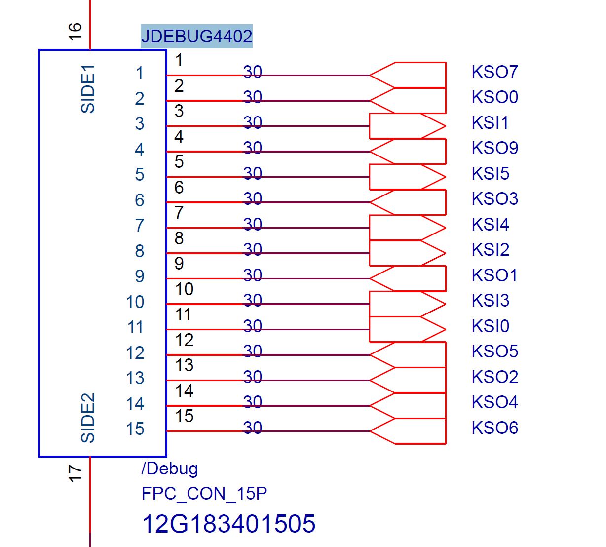

                                G752VY EC and BIOS
                                From the documentation I found on the net, there is some confusion about how to program the EC and if it is necessary. Furthermore, many make the mistake of identifying the w25q80 as memory for the EC while it is the firmware of the thunderbolt.
                                The EC firmware is also in the main bios, in these cases, it should self-program st the startup.
                                In summary,
                                1) keyboard connector is used to program the ITE of the keyboard
                                2) JDEBUG4402 connector is used to program the EC
                                3) W25Q64 is the main BIOS
                                4) W25Q80 contains a 1M alpine ridge firmware, thunderbolt
                                There is no scheme or boardview for the G752VY but the pdf scheme of the G752VSK is very similar.
                                I needed the bios and the ec to do other tests, the model is G752VT motherboard G752VY rev 2.0
