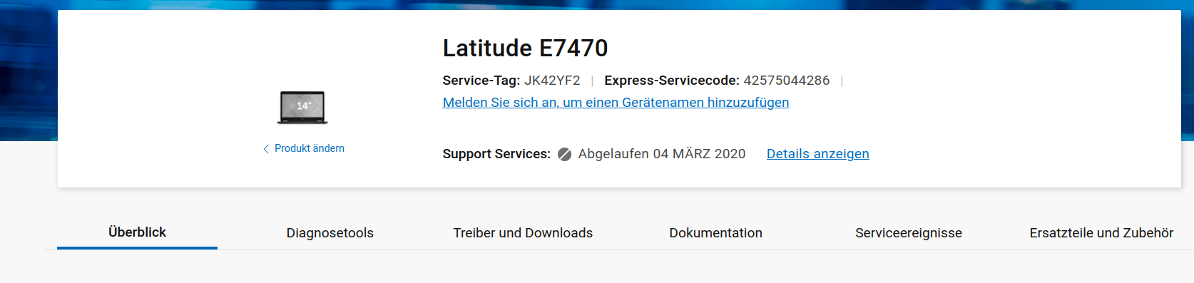

Re: dell latitude e7470
hello please i need the help to remove the password
Attached FilesComment
Try this password from this site ...
https://bios-pw.org/
JK42YF2-6FF1 = x8X2m0zb8HZ0Et6S
or
JK42YF2-BF97 = RkMPZP2N4Lx63dyLComment
