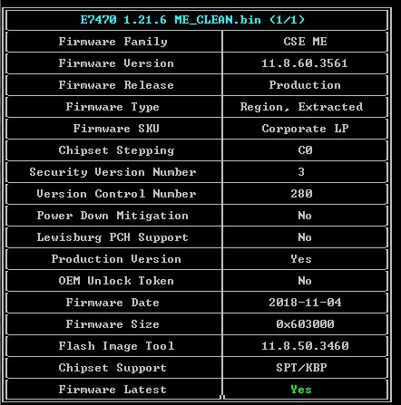

        • alihomee
          • Dec 2012
          • 1600
          • malaysia
          dell latitude e7470
          display comes very late ...need to clr me region...file is attached .....................motherboard code is:AAZ60 LA-C461P rev:0.5
          Premium supporters get full download access and other benefits.
          • peste
            • Dec 2016
            • 15059
            • ROMANIA
            Re: dell latitude e7470
            try...

            • alihomee
              • Dec 2012
              • 1600
              • malaysia
              totally no dosplay with this file......but thanks for ur effort

                • alihomee
                  • Dec 2012
                  • 1600
                  • malaysia
                  it works for me but it showing a error msg for service tag which i dont have on the back of laptop so is there any way to put that
                    • 23640
                    Try this bios,its your original with clean ME.

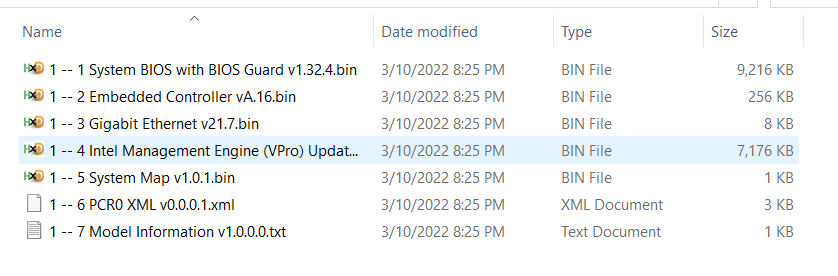

                                    • salawayon
                                      • Nov 2012
                                      • 584
                                      • philippines
                                      Dell Latitude E7470 bios repair
                                      board info:
                                      AAZ60 LA-C641P
                                      REV: 1.0 (A00)
                                      Main problem with this unit is i can't change the setting on LEGACY/UEFI boot option. and it won't boot on M2 with pre-installed OS with LEGACY nor UEFI boot setup on it. i tried already some posted bios but still the same... or maybe someone could share an EC file for this unit...
                                      backup attached... thanks
                                      • hoaca388
                                        Badcaps
                                        • Jan 2022
                                        • 12687
                                        Re: Dell Latitude E7470 bios repair
                                        Originally posted by salawayon
                                        board info:
                                        AAZ60 LA-C641P
                                        REV: 1.0 (A00)
                                        Unfortunately I couldn't find the EC file for you, in the unzipped file there is a file named "1 -- 2 Embedded Controller vA.16" but the size is 256KB.
