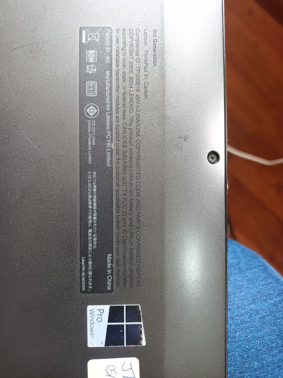

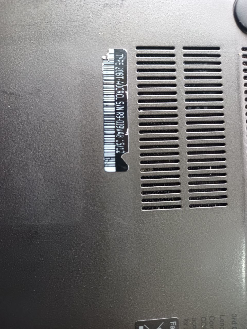

                                  Re: Lenovo X1 Carbon Lmq-2 Mb 13268-1 Bios Dum
                                  Hello, I need help to recover a Lenovo x1 carbon 3rd generation laptop. The BIOS ic was damaged and there is no copy, I already have a new bios with the same characteristics, but I do not have the file, I have tried several that I found and nothing, it does not give an image, I leave this is the serial R9-0J9VA8, If you can help me, I appreciate it.
