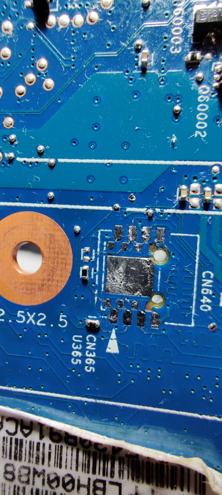

              Re: HP Elitebook 820 G3

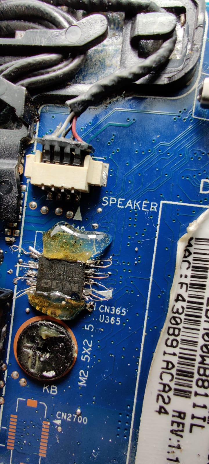

              It worked! Thank you a lot! Just look in what state the laptop came... I had to repair those 2 broken pads.

                  Hi guys. A few days ago, since the bios was in the password, I tried to renew the bios with the help of minipro programmer, but I did not get a backup, now my note does not open.
                  6050A2725001-MB-A01
                    6050A2725001-MB-A01
                    post the backup of the bios..remove the bios chip from the motherboard before reading or writing ..do not use the clip, you may have errors..if you have nothing to remove it, solder the wires from the programmer the cip bios..
