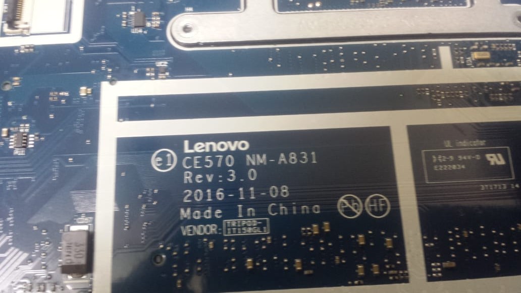

    hi badcaps friends ,, please need bios files for this laptop
    ce570 nm-a831 rev 3.0

        this one is working on Rev 3.0 but it loss power totally ( shuts down) after 30 seconds!
        the one for Rev 2 did not work, actually the last block of the bios doesn't seem to be OK.
        I will try to mix my backup file with your Rev 2.0 and will feedback if I got it working.
        Best Regards
        • due
          • May 2014
          • 52
          • ps
          Re: lenovo thinkpad e570
          Worked.
          I mixed both files together.
          i toke from the backup the first 0x280000 bytes into your file(replace for sure).
          thanks for sharing the backup file.
