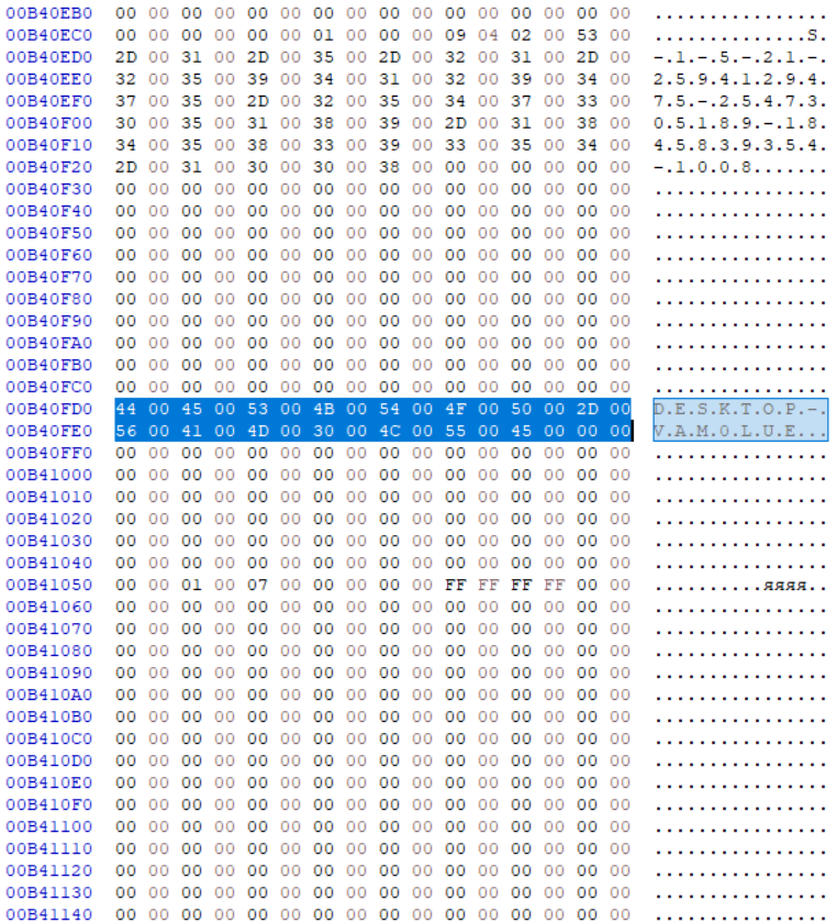

      Re: Hp Pro X2 612 G2 Bios Password unlocking
      Still requires a password
        #43
        Your case is a little bit different than usual admin pass, so the HPU didn't do the job.
        I did not pay attention, sorry.
        I've edited your dump manually, should be OK now.

                                Yes, you need to post your own original bios bin. It contains your password and sometimes it is easier to "fix" your bios so it will bypass the password nag or entirely erase it. You MUST make at least three readings, save each, do a comparison analysis with winhex, all should be identical, start from scratch at least twice. Do not rely on a clip, but if it gives good reading, it is ok. Your readings should be 16MB in size. Rar or zip it, and upload here using advanced menu.

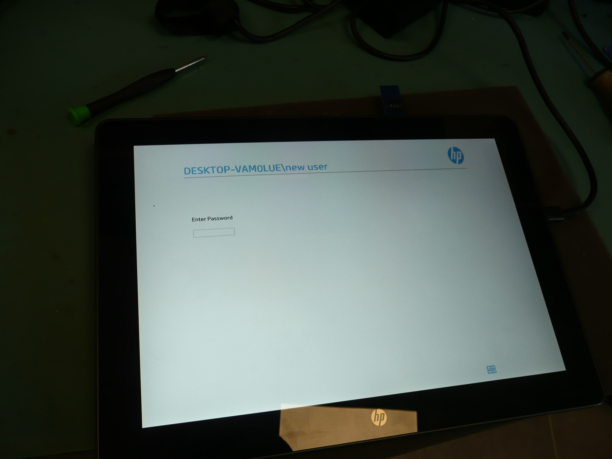

                                          I used HPUnlocker
                                          The password is still there
