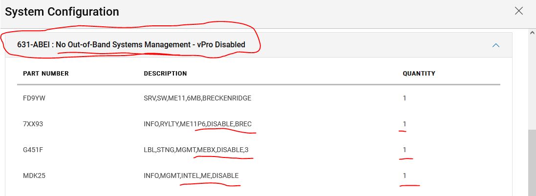

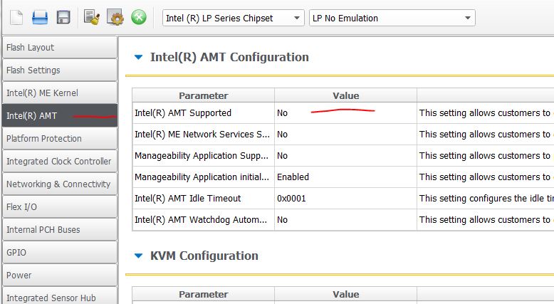

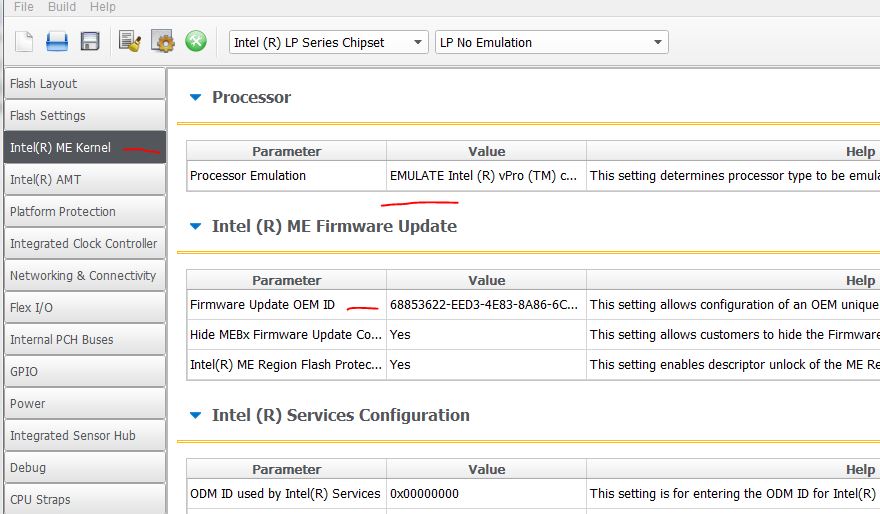

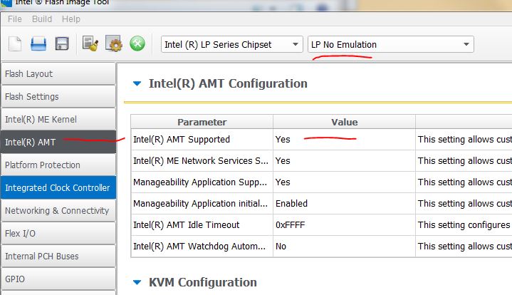

    Re: Dell Latitude 5580 (LA-E091P)
    Originally posted by danito
    Not working.
    The configuration of your laptop is with AMT disabled.
    The bios you tried has AMT enabled, look at some of the settings with FIT
    Compare with the bios at post #3
    The bios at post #3 should be ok,if you clean the ME firmware,as its initialised.
      Maybe I'll learn these once too.
      I will try #3 and come back.
      Thx
