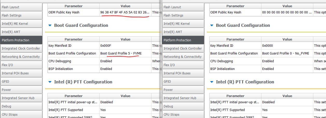

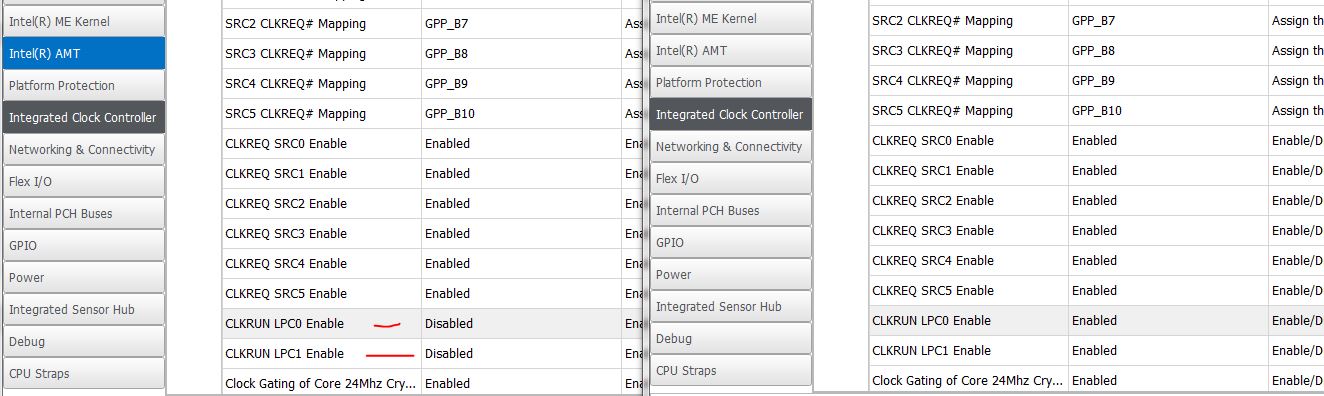

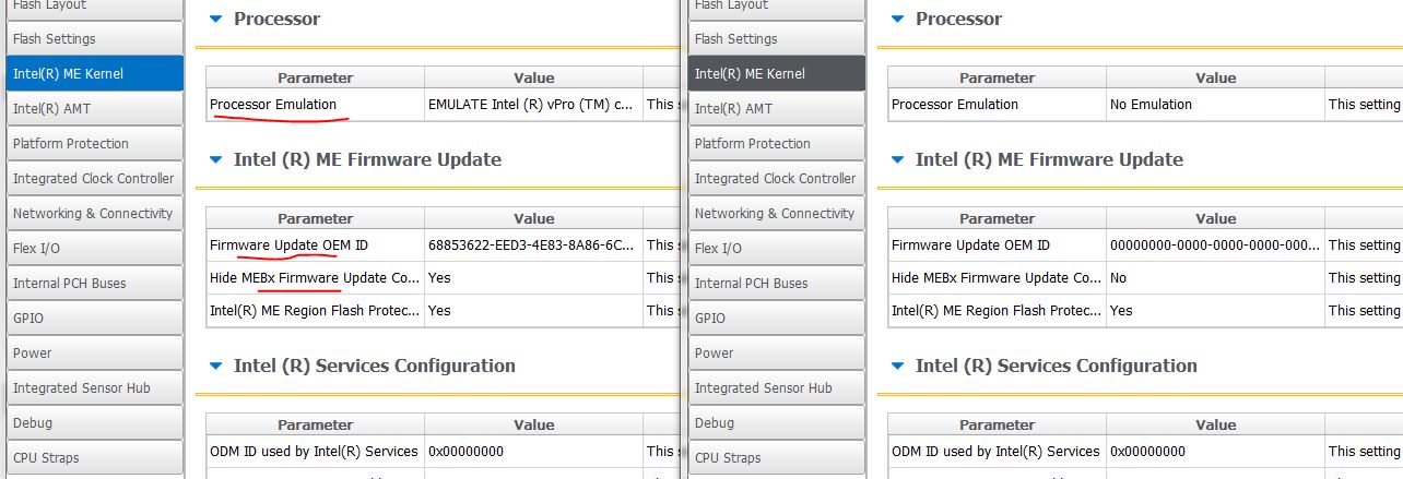

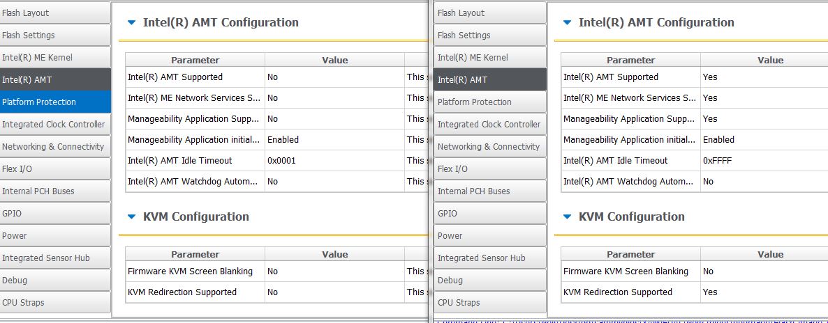

              clear me dell 5580 cdm80 la-e091p
              i have dell 5580 open after 1 min i need to clear me for my bin
              cdm80 la-e091p please help me thanks
              • hoaca388
                Badcaps
                • Jan 2022
                • 12139
                Re: clear me dell 5580 cdm80 la-e091p
                  • 21472
                  Originally posted by hoaca388
                  When you use flash image tool it should be keeping the OEM`s original configuration. Use a new copy of FIT every time and copy it into a seperate folder with the bios, or delete all files (ini,log,xml) from the working folder except for vsccommn.bin and fitc.exe
                  • hoaca388
                    Badcaps
                    • Jan 2022
                    • 12139
                    I can't keep the OEM configuration, the tool says "Loading new ME will reset existing parameters. Do you want to continue?" , unless all parameters are manually configured.
