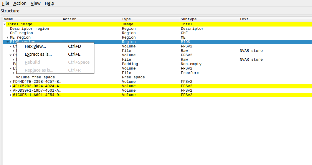

                            Dell has (purposefully ) changed the algorithm in newer versions of the BIOS, and the workaround with generated master password (by the service tag) no longer works.
                            That's why I asked what is the version of the BIOS.

                                Peste has simply replaced the bios region - 9216kb from the latest version (v 1.22.3 - 02/17/2020) in his original 16384kb bios file (v 1.20.4 - 5/20/2019 which is the version before the last one). That's all, there is no patching or editing in this case which surprised me too, but the method obviously still works. However, the master password does not work in both versions.

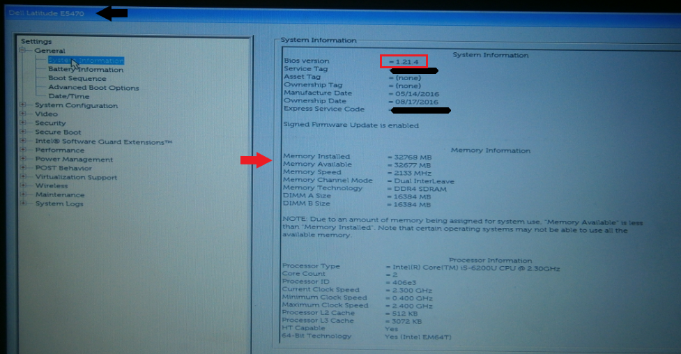

                                        Hi, I also have a E5470 in which the generated password from bios-pw.org does not work.
                                        Bios version 1.21.4
                                        With which tool do you replace the bios region? I tried "UEFITool NE", but the "Replace as is..." menu option is always disabled.
                                        Would any newer bios downloaded and extracted from the dell website work or use one as close as possible?
