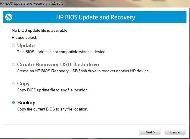

                                      Yes, I made a bios update to the latest version. Attached is the bios update. I do not know how to do to get a backup dump.
                                        • 22199
                                        Re: Probook 470G3-Your system is not fully configured - contact your hp customer supp
                                        You have the option to save the current bios to a file .
