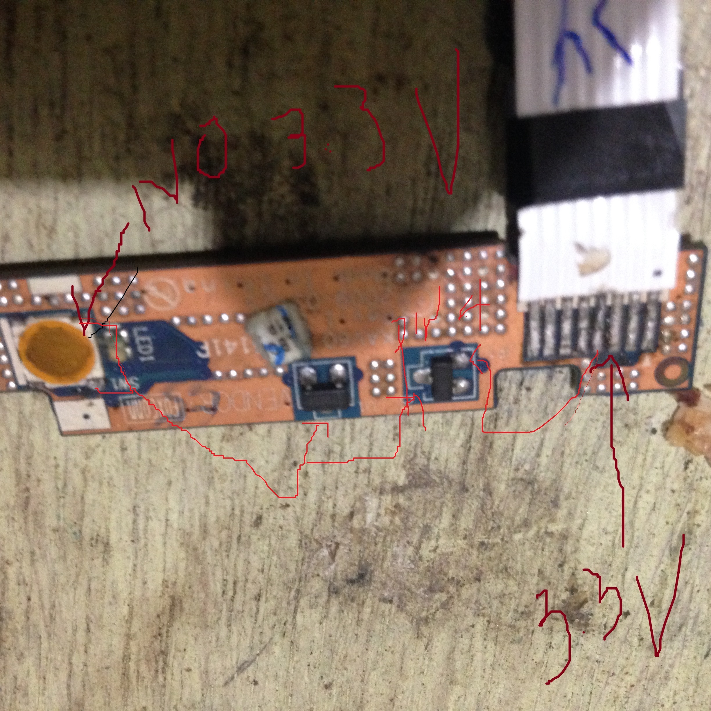

    The pin 1 has 0v and connected to the ground pin 2 and pin3 of that chip no continuity on the switch

      Re: Acer one KAV60 bios needed
      on the ribbon cable on the image i have uploaded here is the readings
      pin 1 = 5v
      2= 5v
      3= 3.3v
      4= 17.42v
      5= 0v
      6= 0v
      7= 3.3v
      8= 0v
      on the first chip pin 1=0v pin2= 0v pin 3= 17.42v
      on the second chip pin1 = 0v pin2= 3.3v pin3 = 3.3v
        Is pin 1 of the second chip connected to the switch? If this is the case, this chip is defective or the switch is short to the ground.
          thanks again for the response jarotech the pin 1 of both 1st and 2nd chip connected to the ground of the switch i have upload the image i put arrow on the connected of pin1 of the chip
            If pin 1 of the two chips is connected to one side of the switch to ground, the other side of the switch is connected to what?
              this is weird on the other side of the switch is not connected to any of the chip or to any resistor and capcitor downside of the switch board.i have upload image of the backside of the power switch board
                I think the best will be to replace the board with a new one.
                    But we don't know how the switch is connected to the ribbon.
                      The switch is directly connected to pin 4 (ON / OFFBTN #) of the ribbon, so if you have nothing on the switch, the trace is open somewhere on the board. I just found the schematic of that board.
                            i checked based on the schematics there is voltage on c3,r2,r3 and c1 the wrong voltage is on pin 4 on the ribbon cable which is giving 17.42 v
                              problem solved thanks jarotech for the response and help.I found on my scrapboard its acer one d250 same power switch i replaced it problem solved
