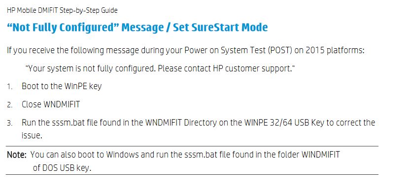

                  #88
                  Re: HP Elite book 840 G3 need bios urgently
                  Dear SMDFlea can you solve the problem
                  ((your system is not configure correctly contact hp support . ))
                  I have elitebook 725 g4 with board number 6050a2834801 or if you have clear bios dump Please upload it

                      • 21867
                      #90
                      Look at the attatched picture and read the NOTE part at the bottom.Run sssm.bat from the wndmifit folder. This link has nbdmifit 2.10 ,extract the folder and the wndmifit folder is inside.
                      https://www.badcaps.net/forum/attach...1&d=1524773712
                      • qadirandewal
                        • Nov 2017
                        • 11
                        • Pakistan
                        #91
                        Thanks SMDFlea it's work I tried in windows
                        Please can you tell me how to use in dos mode .
