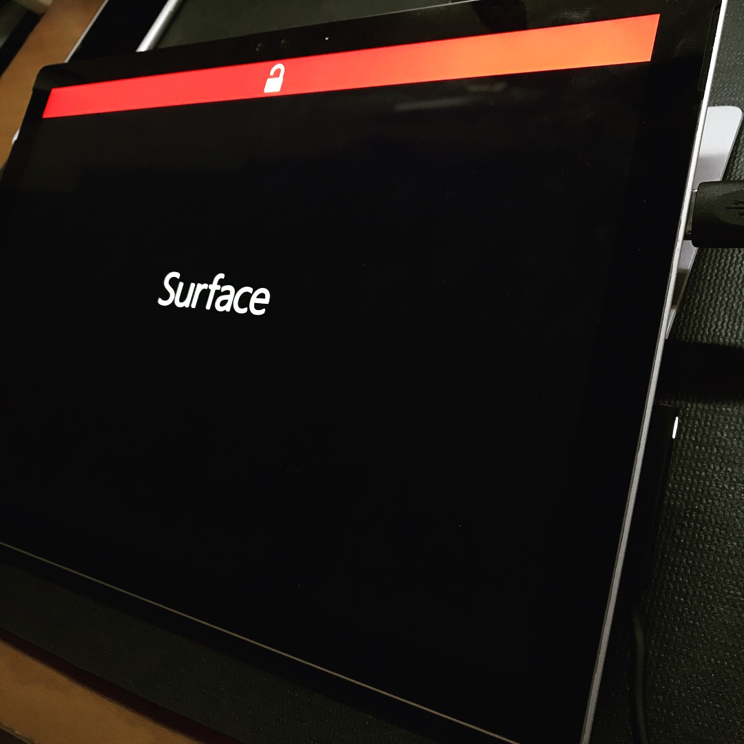

    I've a Surface Pro 4 after update (bios), blackscreen.
    There is any way to fix this bios?
    I try another dumps, but it's stop on Surface Logo with a unlock red stripe on top the screen (see the atach).
    Thanks.

    Another thing....i cannot access to UEFI menu or boot by the USB drive.

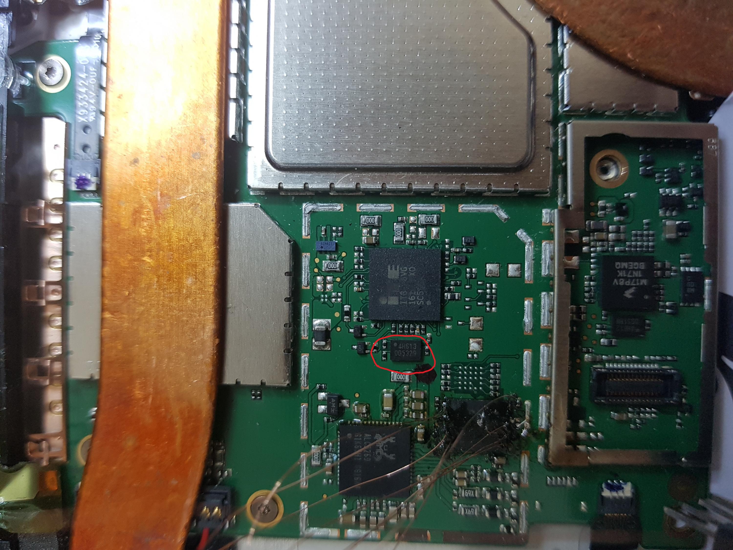

        i have the very same problem with 2 surfaces. the board p/n x911788-009
        i tried a lot of bios dump from different websites, some doesn't gives display. and some gives display,but only stays at surface logo. i tried to clear ME region, changed ME versions. all gives the same results. i think it's not only the bios that got corrupted during the surface firmware update. i think there are more firmwares that got corrupted. i have found an eeprom near the EC chip which is programmable, I have found any dump for it now where.
        i also downloaded the latest FW from microsoft, but struggled to use them to fix mine
        did anyone faced this issue? did someone was able to fix this?
