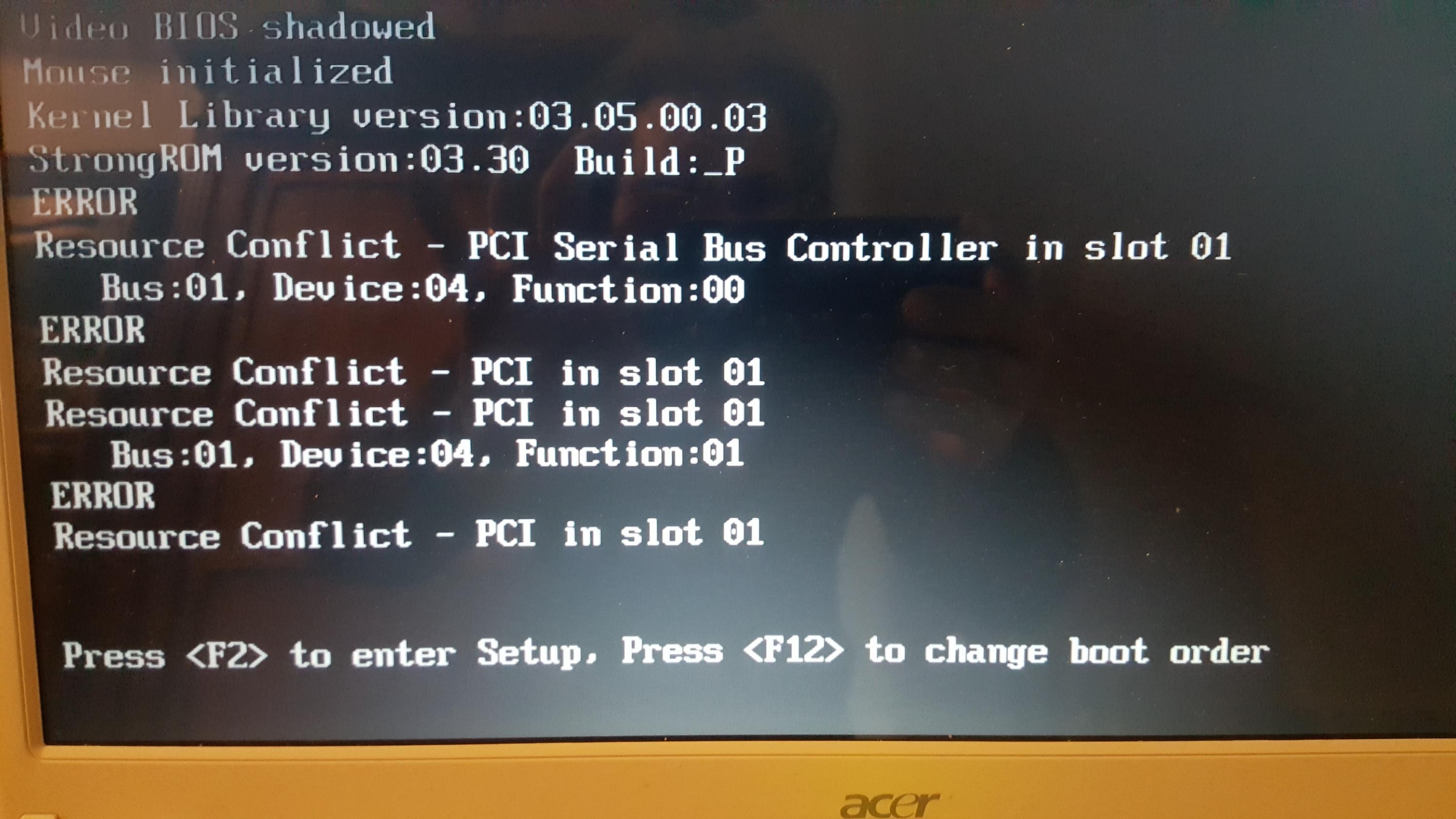

    acer 7520g no boot after bios post
    acer aspire 7520g:
    (I don't know well amd system)
    I can enter to bios, modify boot option, etc but after bios post , the system remain with cursor blink and no boot even with a usb boot pen or cd rom.
    I reprogram the bios
    and removed all unnecessary peripherals but the issue persist.
  • jasko_jacker
    • Oct 2014
    • 1140
    • italy
    Re: acer 7520g no boot after bios post
    A full bios post show:
    RESOURCE CONFLICT - pci serial bus controller in slot 01
    bus: 01, device: 04, function: 01
    etc
    The problem cames from this chip Ricoh R5C833
    I try to disable it
    • jasko_jacker
      • Oct 2014
      • 1140
      • italy
      after I removed that chip, the system behaviour is correct , I have not time to replace it but i think the culprit is NVIDIA MCP67 a common issue on these boards.
