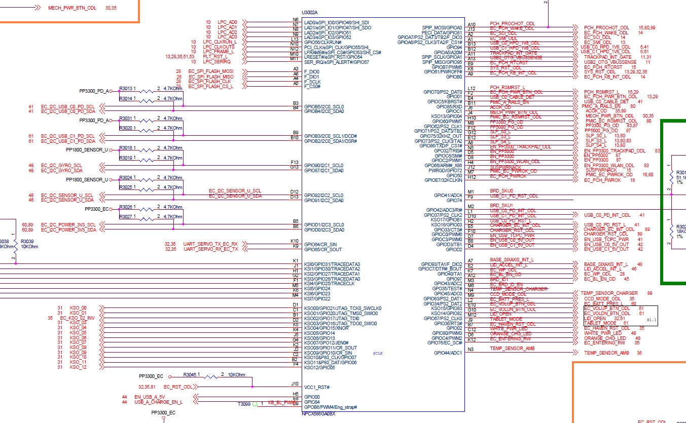

        EC Nuvoton NPCX586GA0BX programming or not?
        Does anyone know if this controller should be programmed or not?
        REF : Nuvoton NPCX586GA0BX
          • 22285
          #44
          Re: EC Nuvoton NPCX586GA0BX programming or not?
          Not sure. Whats the motherboard its on
          • seb68
            • Apr 2019
            • 44
            • France
            #45
            Asus Chromebook C423NA
              • 22285

                It has an external EC SPI rom ,page 28 in the schematic , U2803

                  Re: Programmable and non-programmable SIO list
                  Not programmed.
                  It's the Windbond which contains its program?
                    • 22285
                    #49
                    Originally posted by seb68
                    Not programmed.
                    U2801A has the bios.What exactly are you trying to do ?
                    • seb68
                      • Apr 2019
                      • 44
                      • France
                      #50
                      I must replace Ec Nuvoton.
                      It is in internal circuit shortet.
