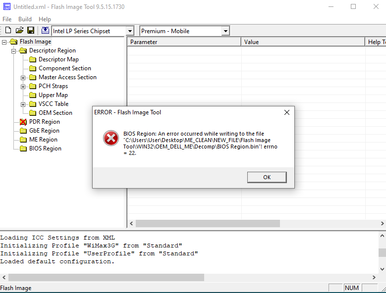

                                      Hi friends my bios dumpneeds a clear me region and is the bios issue that my wifi card is not working
                                        thanks
                                        To clean your BIOS you need two BIOS files 8MB and 4MB otherwise this error message.
                                        Win Raid Forum Post #101 picture happened to me too.
                                        https://winraid.level1techs.com/t/gu...lization/31277
