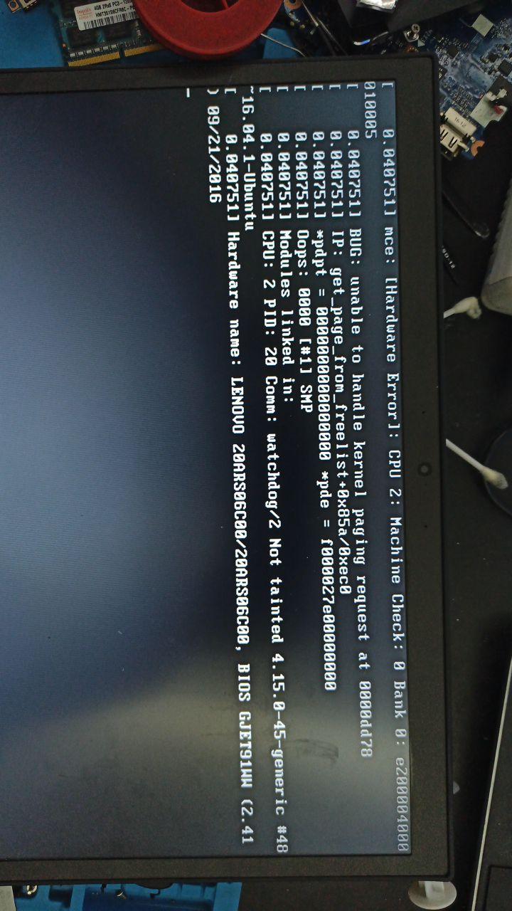

    i try to install ubuntu and show me this problem,please replay me if it can be fix?!!!!

      Overheating. CPU fan clean? Bios update https://support.lenovo.com/us/en/downloads/ds035965Motherboard serial no? For example:T440S
      VILTO NM-A051 REV: 1.0

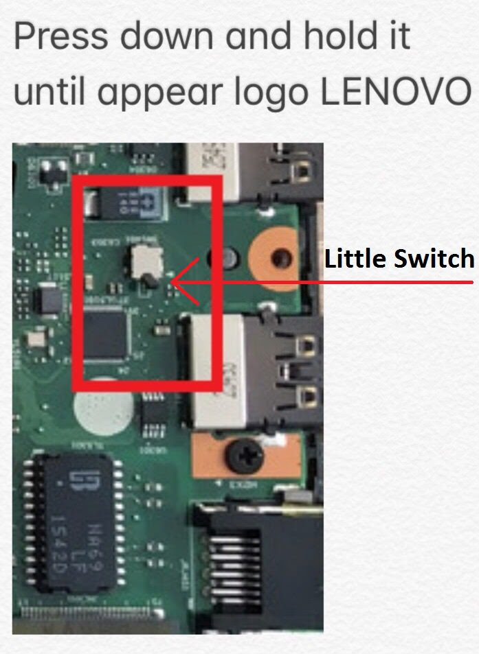

                                    Instrucion for everyone
                                    1. Remove The Battery CMOS . Also make sure laptop's main battery is out and disconnect the internal front battery if used (many new Lenovo may have an internal battery, the black box) by removing its connector from the motherboard. It is important that the laptop will have NO The main Battery attached and the NO Battery CMOS .
                                    2. Insert other LOCK HDD OR SSD M.2 ( by the way use another laptop set up password lock HDD and remember your password )
                                    3. ReFlash BIOS with patched file
                                    4. The First Step Let Press Down and Still Keep Little Switch ( picture attached ) long time and The Second Step Let Plug in the AC adapter and wait for a few seconds, the laptop will start by itself (if not, press the Power button and start it). You may hear some beeps then you will see the Lenovo splash image, press F1 to get the SVP password prompt and enter "1234" for SVP and press Enter. Next page will showing "Press any key..". Wait about 10 to 12 seconds before pressing any Key. Next it will display the warning message and the laptop hardware ID. Do not disconnect the AC during this process!
