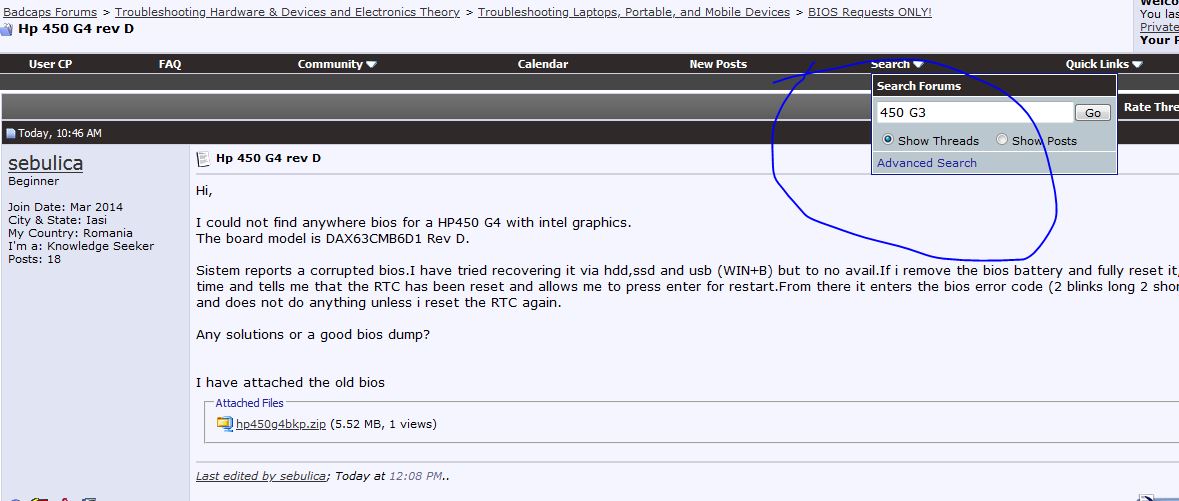

                    #29
                    Hp 450 G4 rev D
                    I could not find anywhere bios for a HP450 G4 with intel graphics.
                    The board model is DAX63CMB6D1 Rev D.
                    Sistem reports a corrupted bios.I have tried recovering it via hdd,ssd and usb (WIN+B) but to no avail.If i remove the bios battery and fully reset it,the sistem starts 1 time and tells me that the RTC has been reset and allows me to press enter for restart.From there it enters the bios error code (2 blinks long 2 short,2 beeps long 2 short) and does not do anything unless i reset the RTC again.
                    Any solutions or a good bios dump?
                    I have attached the old bios

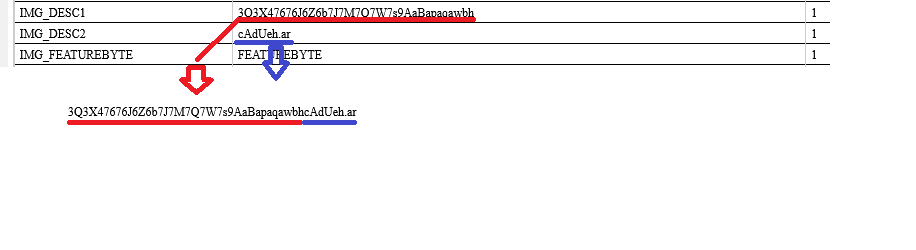

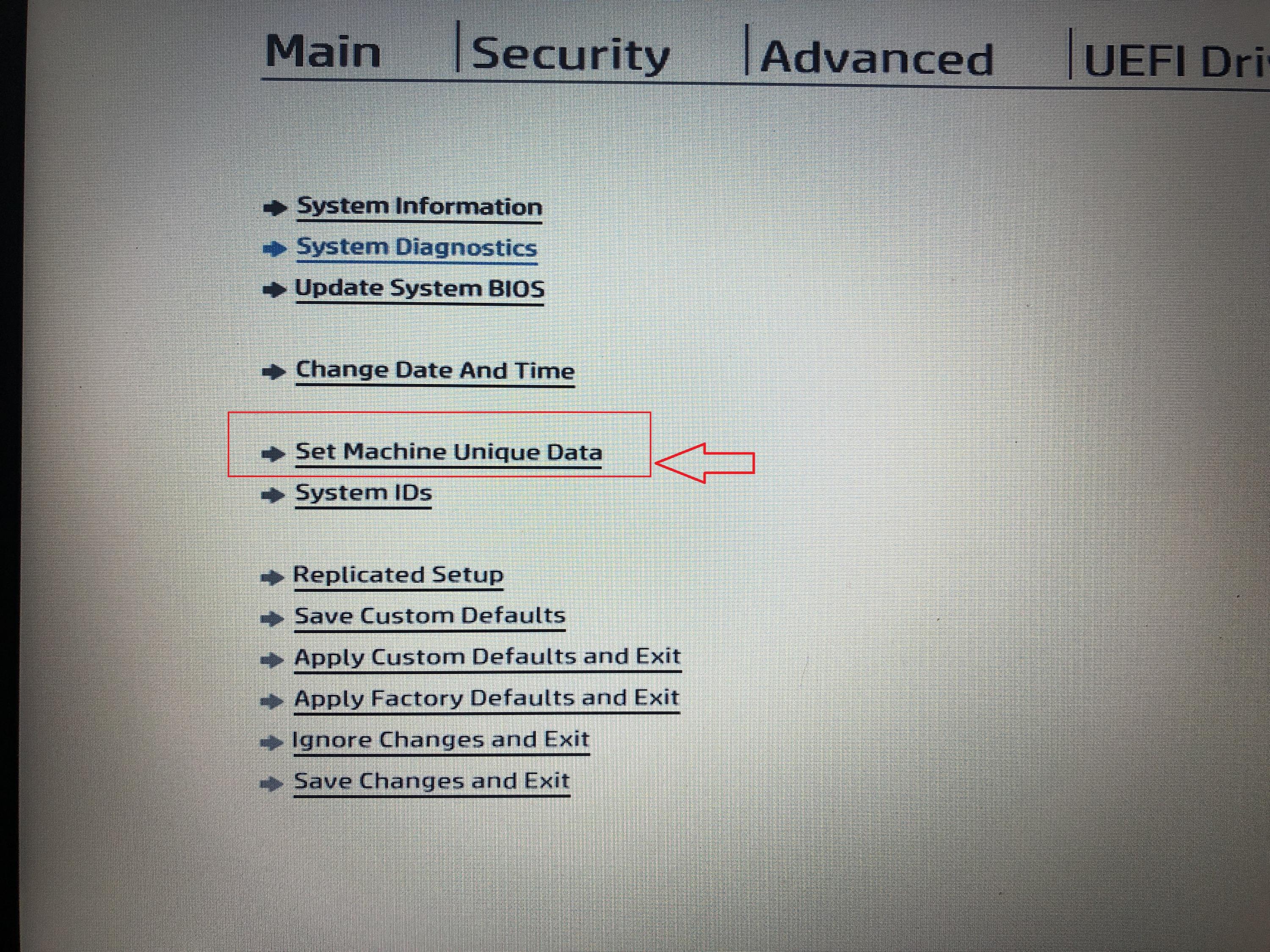

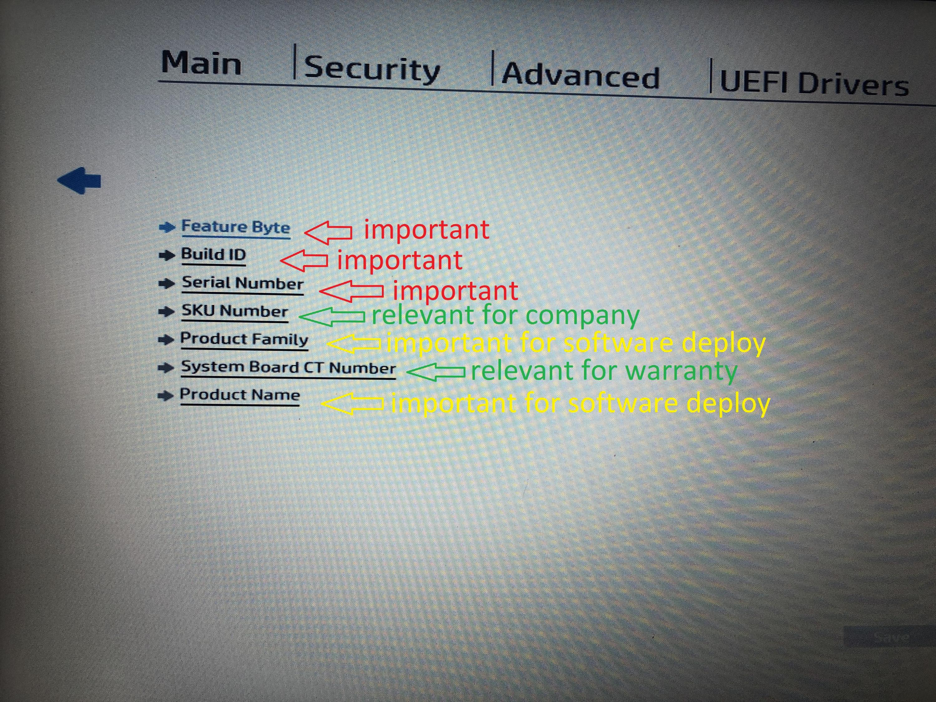

                                          I found a "factory bios" and i am posting this to help other in case they need it
                                          After you flash this bios it will be in "Factory mode".From there you must program the bios with apropriate information obtained usually from HP PartSurfer using the SN of the machine.
                                          FeatureByte,BuildID and SerialNumber are required in order for the machine to function properly.The SKU Number (Storage Keep Unit) is only relevant for a company to track the device or sometimes for the seller to track the warranty,but you can set the PN of the unit there.The Board CT Number (Commodity Tracking) is required for HP to identify and associate the board with the SN of the equipment in order to issue the warranty;this way they can tell if the board was swapped or tampered with.You can find the CT number on the board as a sticker or sometimes as a QR code.Product Family and Product Name are required for large companies to deploy software based on that info.
                                          To get past the factory mode you can use the HP service tool wich (DMI) ,or you just restart the unit until the counter reaches 0.
                                          The tool can be used on other hp equipments.
                                          Part Surfer : https://partsurfer.hp.com/Search.aspx
                                          Hope this will help others
                                          Cheers!
