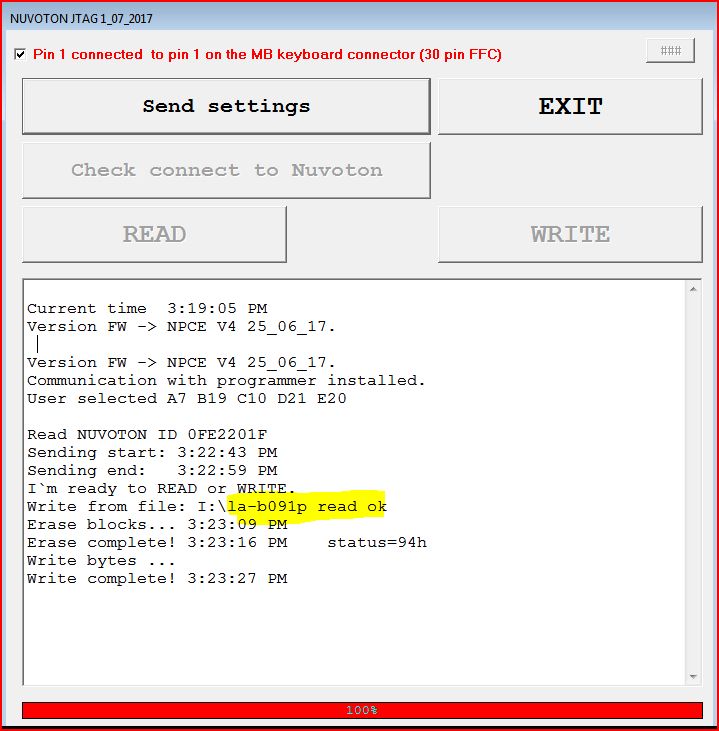

          Hi, there's only one bios inside the rar file, and as I commented at the begining, I've also reprogrammed the Nuvoton embedded controller NPCE288N with a file from another website.
          Thanks.
          Pd: this is the file programmed to kbc:

              There is no difference with this nuvoton 288 file, it behaves the same.

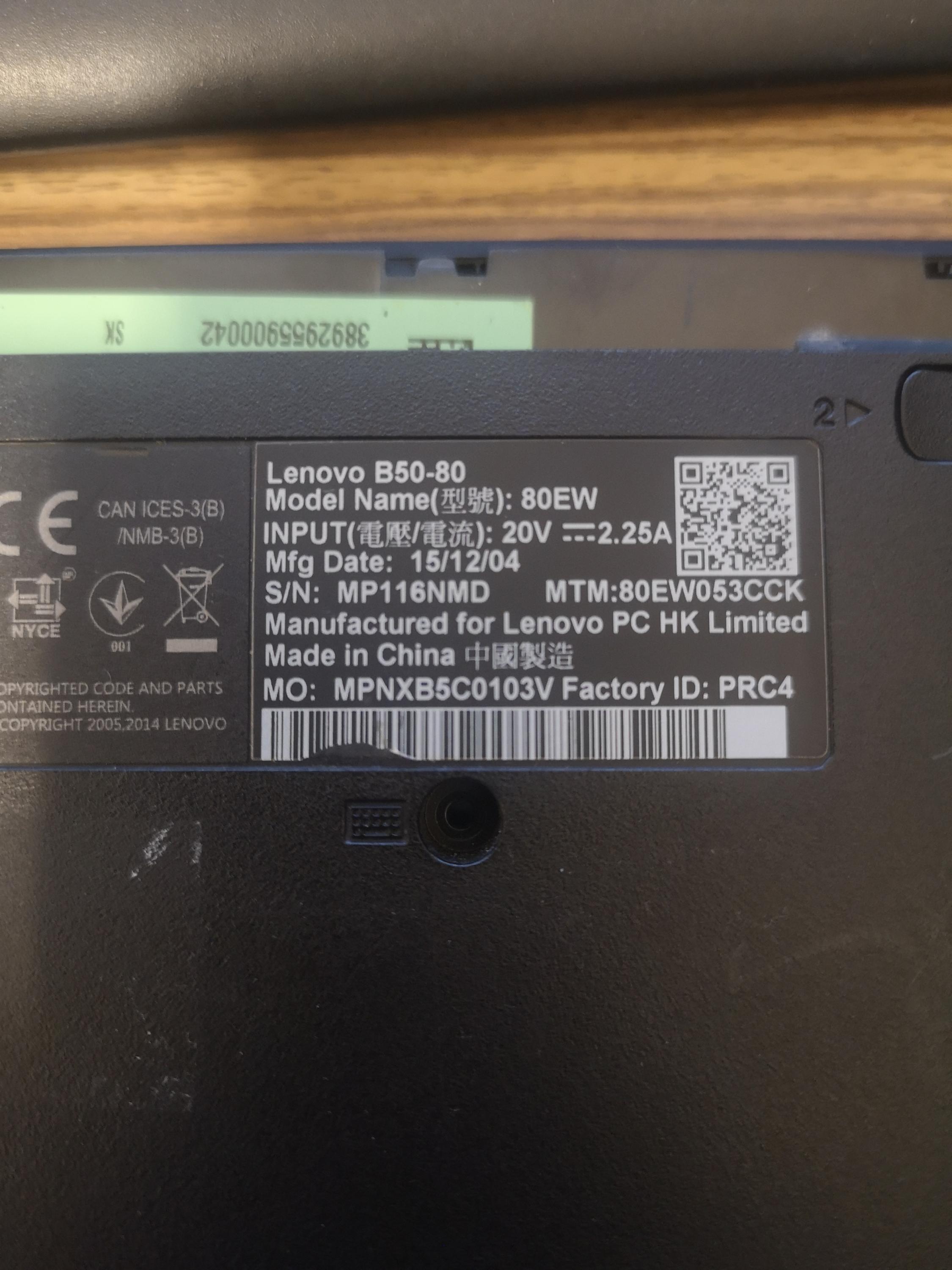

                          hi,please help dump bios,ec lenovo B50-80 model name 80EW mainboard LA-B092P rev3.0 date 2014-12-22 cpu i3-5005u
                            Re: Need bios for la-b091
                            Picture mainboard
