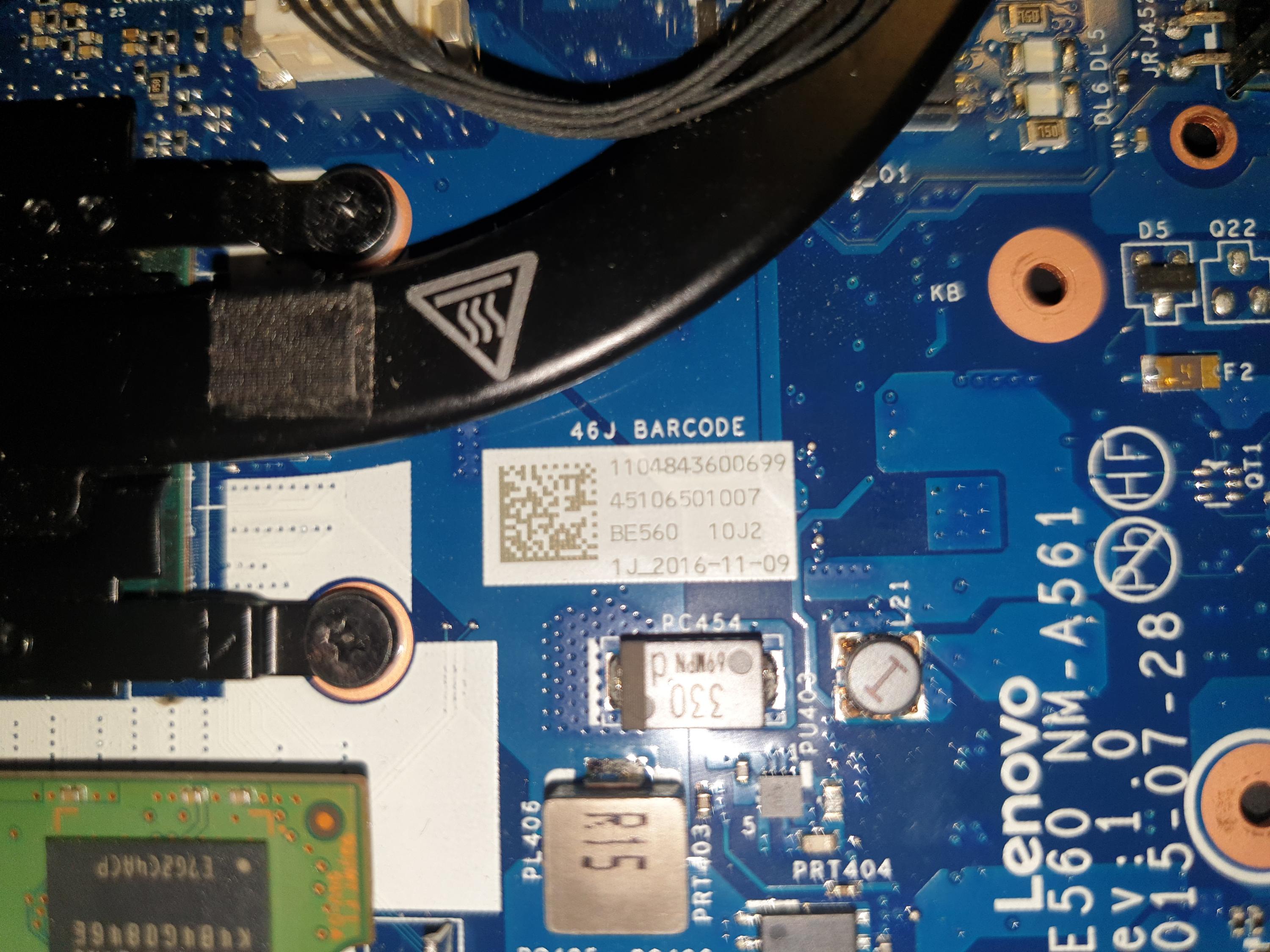

        i have motherboard
        BE560 NM-A561
        REV 1.0
        2015-07-28
        tried this one, but nothing on screen.
        previous bios i have has some issues with ACPI (windows installer going to BSOD with every version of windows, but Linux is working fine)
        anyone has a versione ofr the "BE" version? or is the same? ( the think pad is reporting E560 on the chassis)
        this is the one i found on the machine..but i prefer to have another not derivating from this one.(worried about some corruption related to the ACPI BSOD)

          i have motherboard
          BE560 NM-A561
          Provide the full machine model number, serial number (or Service tag, SNID) and the board model number (see https://www.badcaps.net/forum/showthread.php?t=88758 )

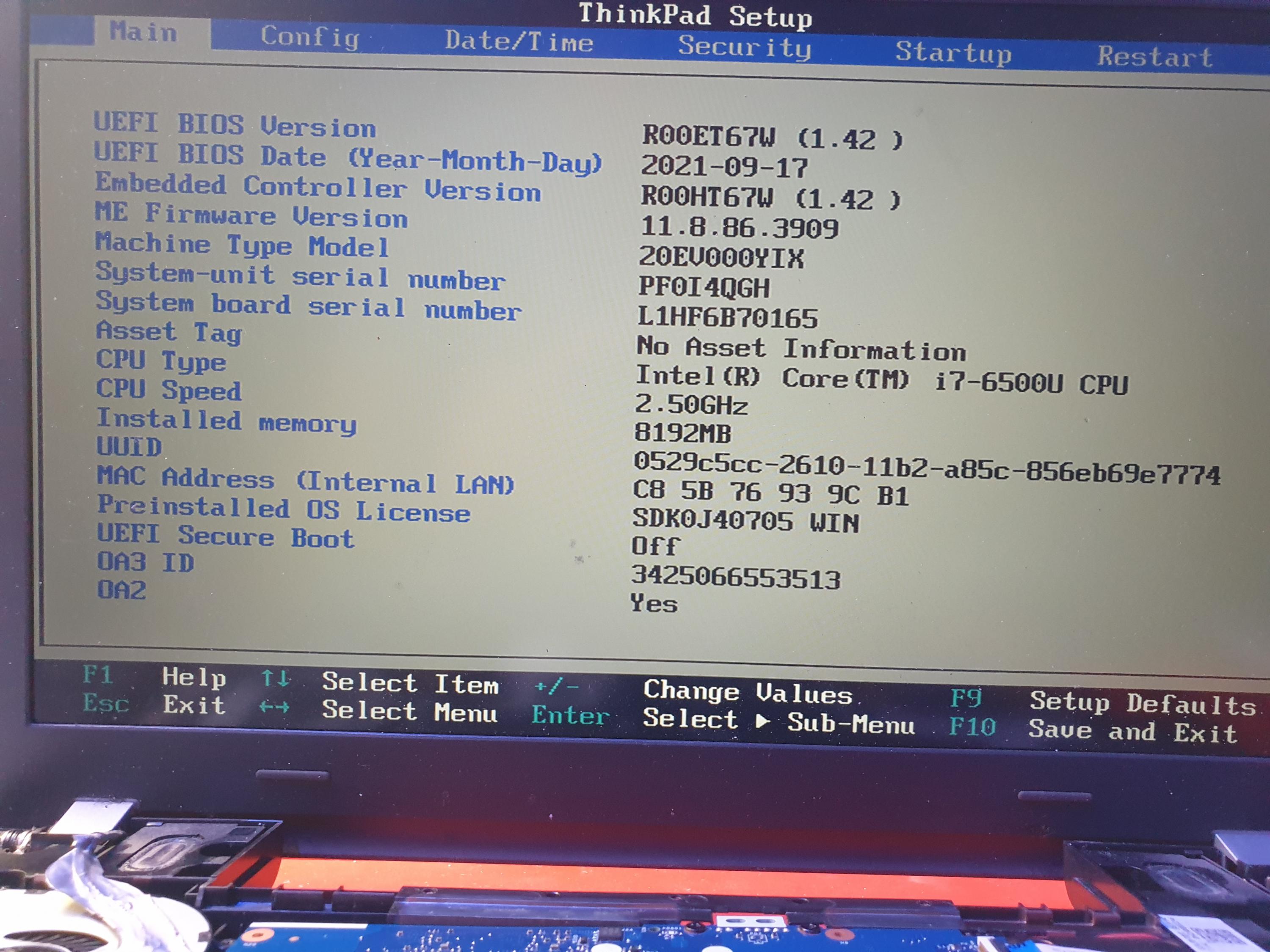

            hi SMDFlea, here the infos:
            Lenovo ThinkPAD E560
            on the mainboard:
            BE560 NM-A561
            REV 1.0
            2015-07-28
            serials and model:
            machine type: 20EV000YIX
            SystemUnit serial: PF0i4QGH
            board serial: L1HF6B70165
            UUID: 0529C5CC-2610-11B2-A85C-856EB69E7774
            other infos are in the picture
            very thank you for any help, i can also provide images of internal stickers

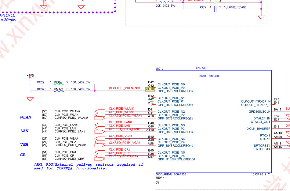

                Try the bios at post #31.
                ACPI errors are usually harware related
                https://www.badcaps.net/forum/showth...highlight=ACPI

                  OMG, you point me on the right direction!, thank you, finally "fixed", the issue come when the operating system is trying to switch from UMA tro discrete .. or doing some checks on this...
