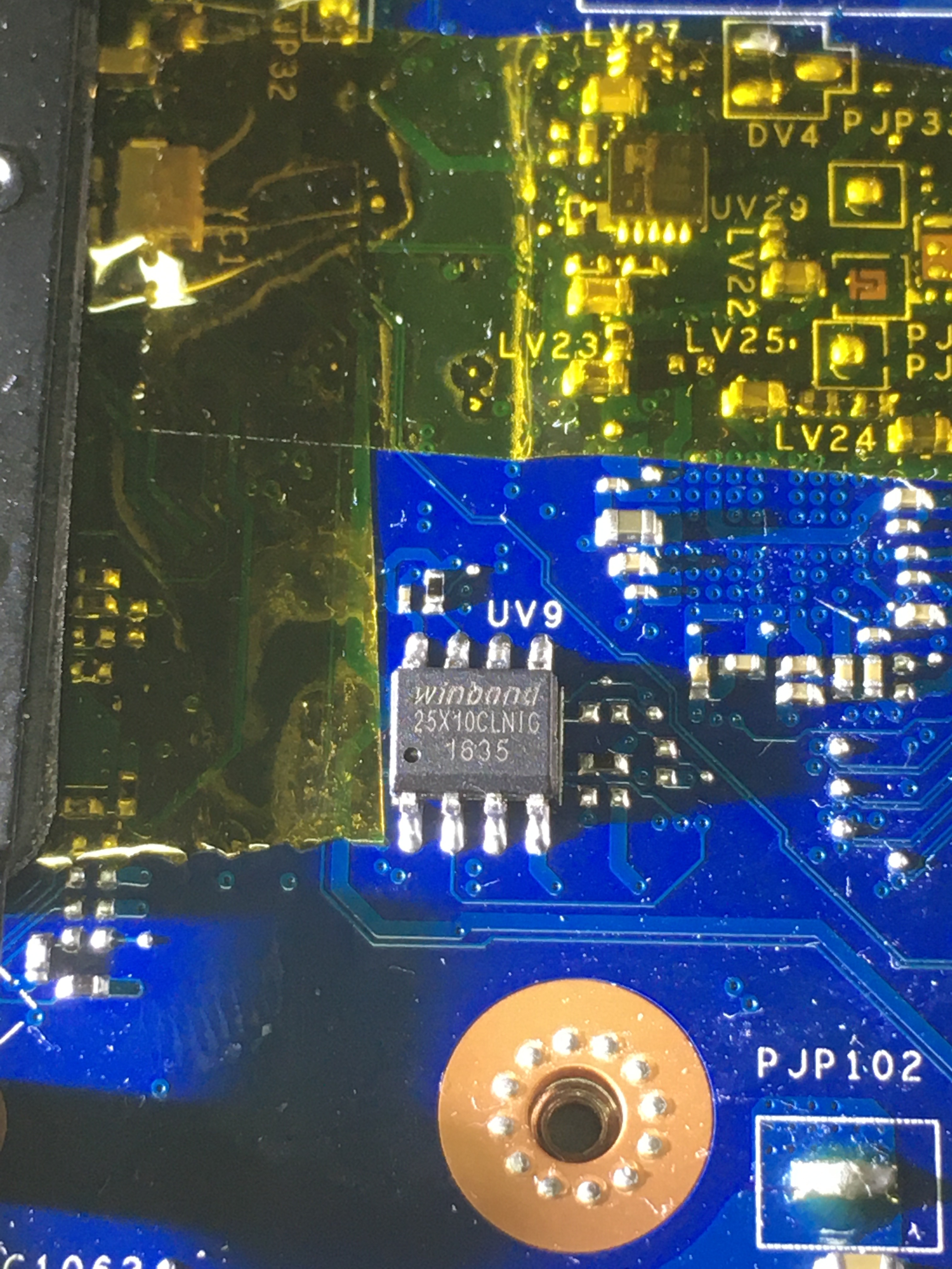

    Why UV9, but try this two files file UV9 + BIOS Me Clean file Good luck ...

      Originally posted by ulrichvachon
      Furthermore, I managed to decompile the latest version of the BIOS found at DELL (Latitude_E5x70_Precision_3510_1.34.3.exe) and the :
      “1 Latitude_E5x70_Precision_3510_1.34.3 -- 1 System BIOS with BIOS Guard v1.34.3.bin” and ‘1 Latitude_E5x70_Precision_3510_1.34.3 -- 2 Embedded Controller vA.24.bin'. I thought I could flash my two chips with these files but the size of the file “1 Latitude_E5x70_Precision_3510_1.34.3 -- 1 System BIOS with BIOS Guard v1.34.3.bin” is only 9 MB. And when I flashed with this file nothing happened on the machine. I am lost.
      Thanks SMDFlea for your reply. I guess there is a way to merge this partial bios in my backup (UC 6). I'll look into it. Is the file for EC (1 Latitude_E5x70_Precision_3510_1.34.3 -- 2 Embedded Controller vA.24.bin) also partial according to you?​
        Thanks Markus1741 I'll try that faster !
            Hello Markus1741 SMDFlea
            It works! Thanks again for bringing the machine back to life. But I'd really like to know how you did it? I've tried all kinds of files and combinations, but to no avail for days. I don't know if this is the right topic to talk about this but as a Software Engineer I'd like to know how you were able to find/generate the right files ? Is it something to do with the "Service tag" or something else? What software or code did you use?
            Thank you very much.
            PS : I've flashed the two files.

              #106
              nice to hear that it worked.
              First of all, research where the BIOS chip is located. Only then start reading.
              You can look for a circuit diagram in your case Dell LA-C641P can also be found in this forum.
              If you have the opportunity, it's always a good idea to unsolder the BIOS chip.
              CH341A with clip is always a gamble, I don't like doing it.
              It is very important to create a good backup of the original BIOS.
              I usually make three backups.
              I unsoldered the UV9 chip from my notebook and read it three times and then compared the contents with md5sum.
              The main BIOS was a BIOS from a notebook that I have here.
              You should just do an ME Clean of the Intel firmware before making it available to others. Everything else can be found here in the forum or on the Internet.
              Good luck continuing
                Thank you again Markus1741 took time for unsoldering your chip for me ! I knew that using climbs is not the good idea but I wanted to test with them before to buy more material. Indeed I did two backups of UC6 and forgot to backup the UV9 (big mistakes!).
                I read more about ME Clean and I understood the goal of this operation now Probably that they were a corruption in the region...
                Have a good evening.
