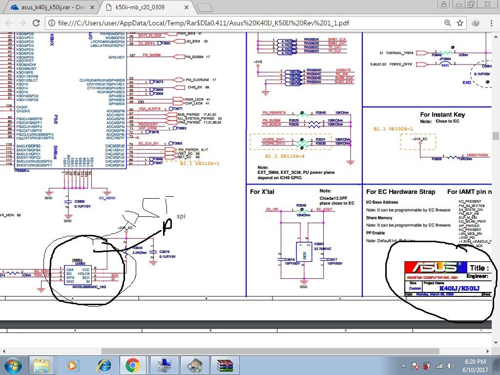

        didn't worked also i found a schematics for this board and it says the file is 8mb not 4mb or 1mb how's that?

          Re: NEED ASUS K40IJ bios dump
          mx25l8005 is 1bm size
          look at datasheet

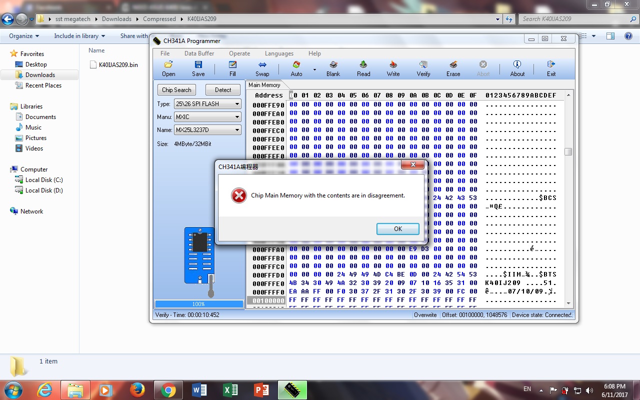

            this is the error i get when i try your bin file
            is it possible that the ic is defective? sorry im kinda new at this
              you select chip name 25l3237d your bios 1mb you select chip 25l80.... uper upload bios 1mb.
