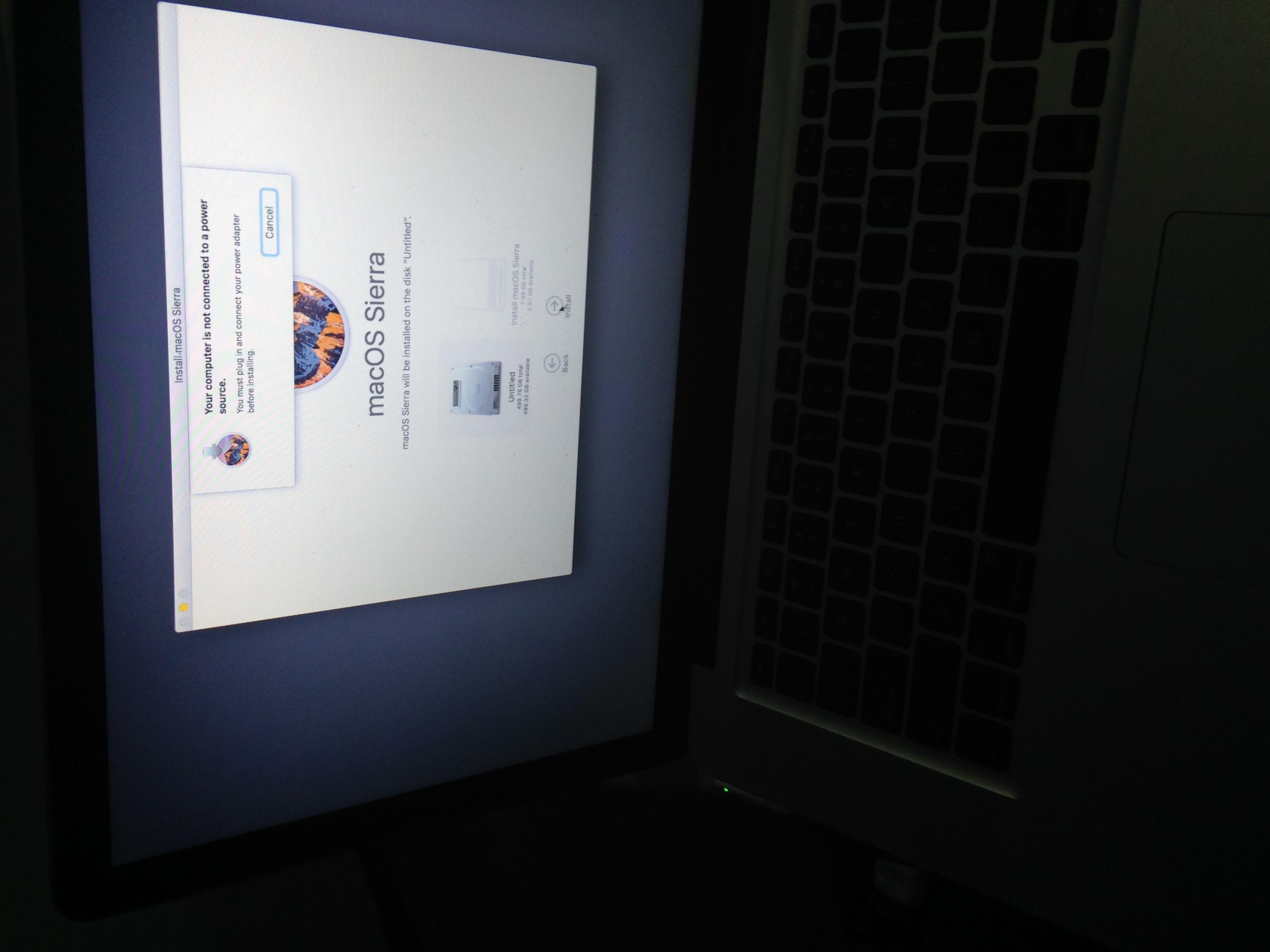

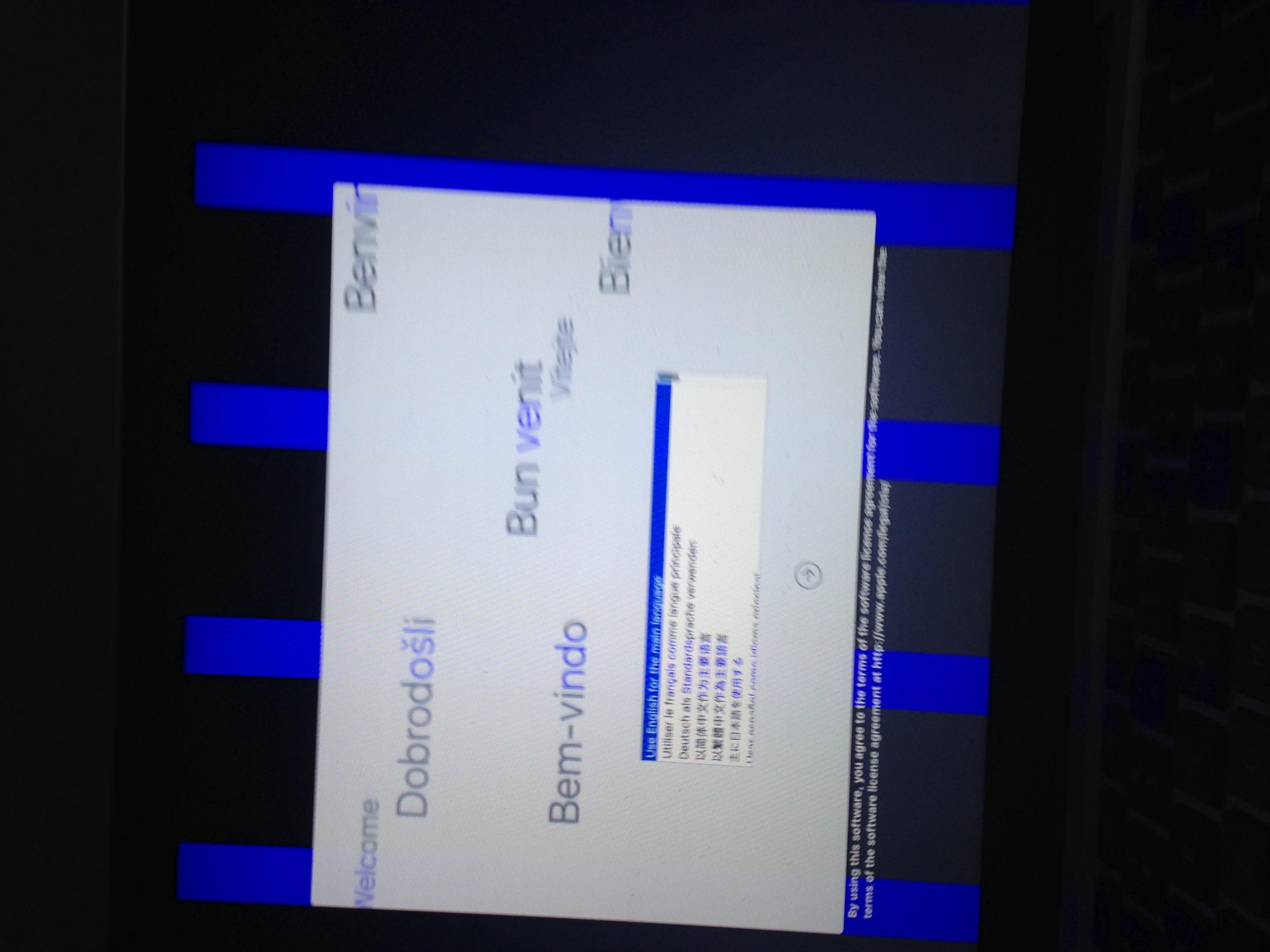

                        Thanks ala borbe i think maybe gpu problem with this but if i press power button for 5secs and plugged in charger and release power button it starts the fan at full speed and i can continue install the os but there is problem it says charger not detected and there is blue lines attached is the image.and also battery not charging magsafe light green even battery is plugged in.any help please

                          update:thanks for the help ala borbe I slight reflow the AMD gpu now macbook starts installing the mac os but i notice that is very slow. what could be the prob with this?
