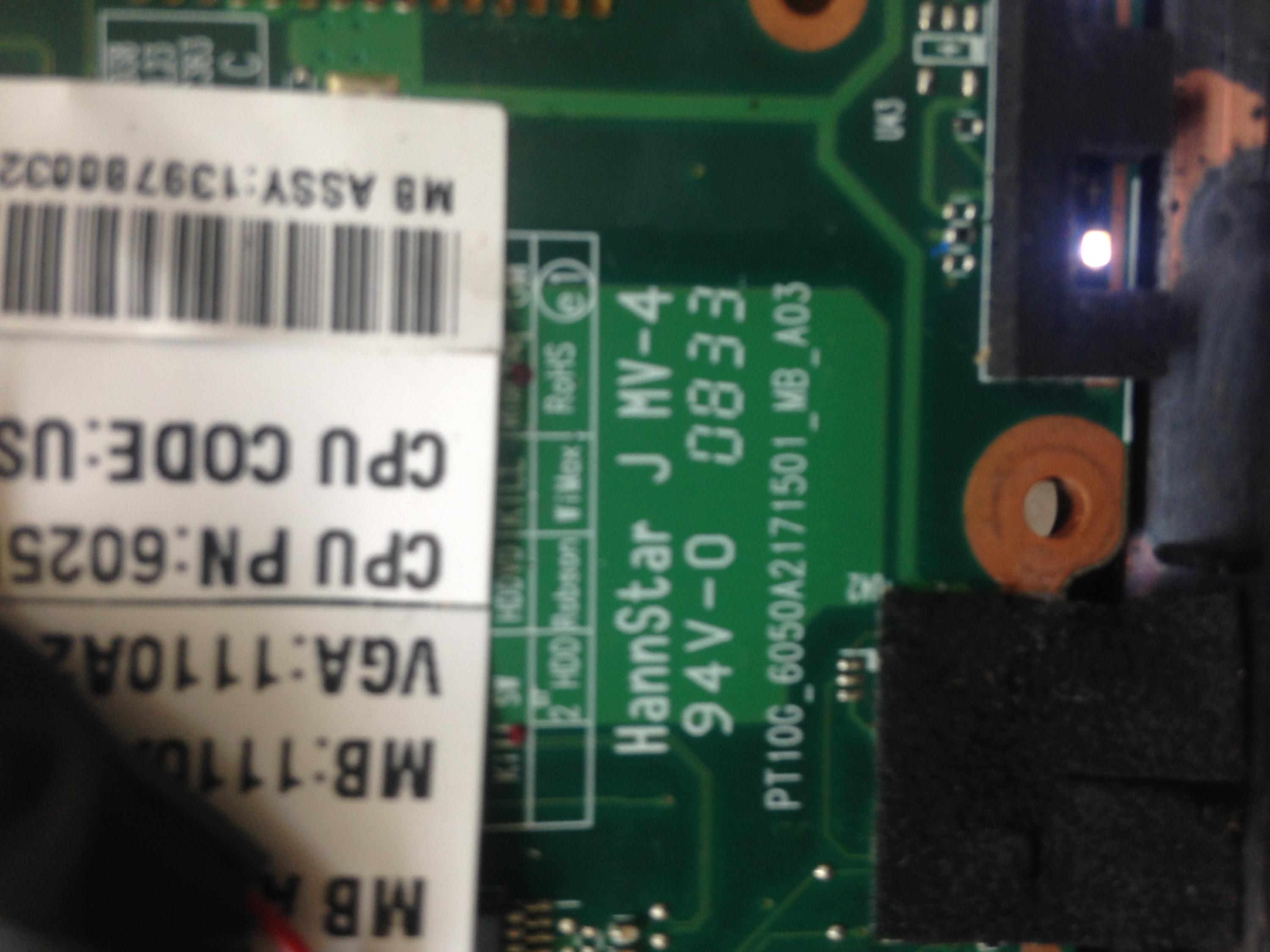

    Hi everyone need a working bios for this model Toshiba satellite A305-S6898 model:Psagcu-05601S.attached is the board id image.Problem is laptop turns on all led lights presents fan spinning but there is no display.I already tried change nec tokin to 6 tantalum 330UF and tried reflow ATI chip and also tried change memory with good one and connect to external display still no luck laptop no display.Can anyone share a good working bios dump file please I need this urgent.Thanks in advance

            I have attached the original dump bios file can someone please fix this alaborbe or rioreno please fix this bios file please. laptop turns on all led lights present but there is no video.I already change good memory, reflow ATI chip and connect to external display still no display.

                this your bios,
                http://support.toshiba.com/support/v...tentId=2502904
                extract update exe, find .FD file.
                btw..your old bios ver 1.50

                  I tried above bios still no display laptop turns on with led lights ok but there is no display I reflowed again the ATi chip but still the same can anyone please help me

                            I confirmed the culprit it the Ati chip because when i removed it from the slot it shows gray screen.does anyone knows where can I buy for replacement?i have attached the image

                              I tried remove the ati video.slot laptop has display but gray screen so the culprit is the ati chip i have attached the image
