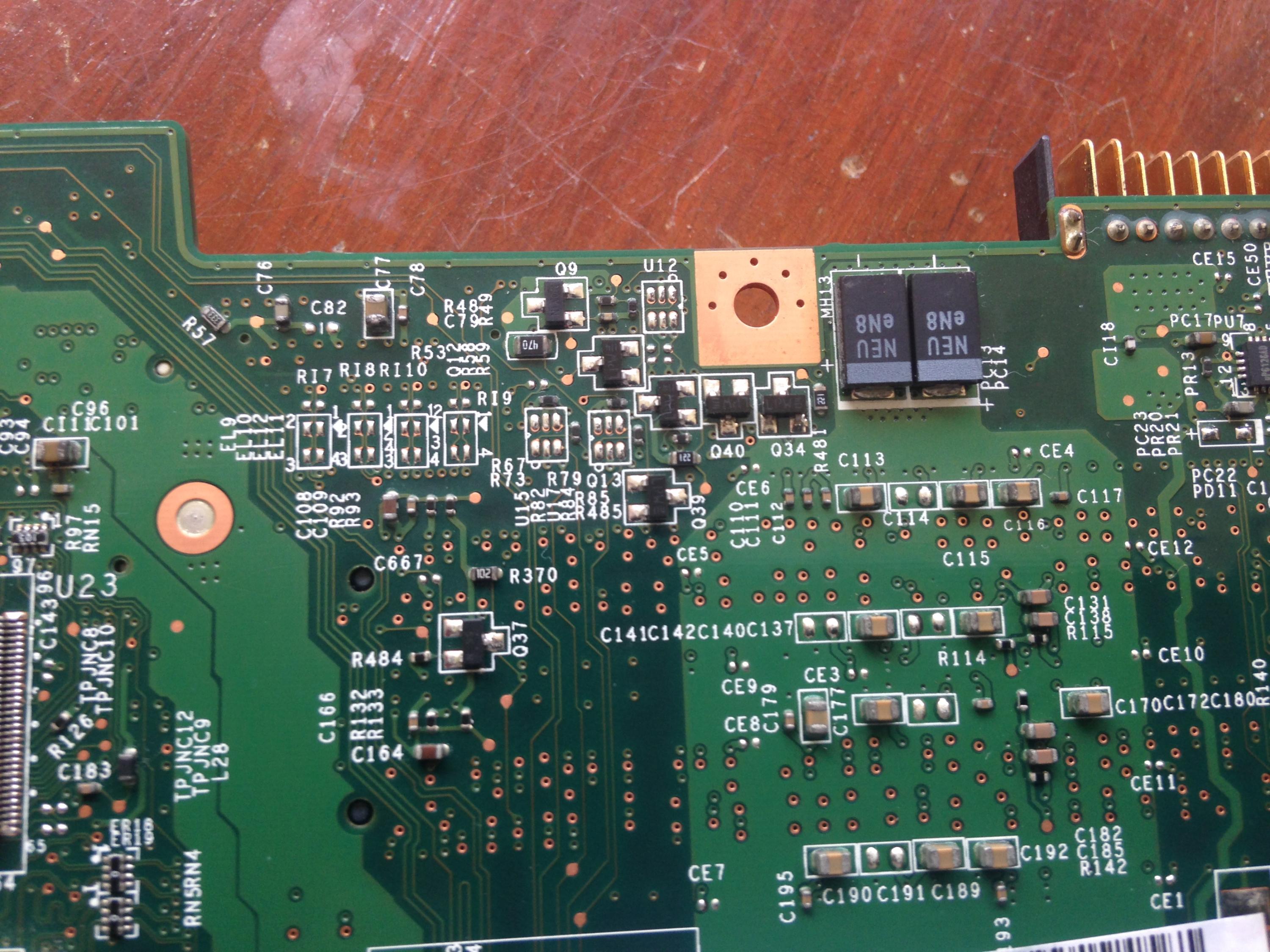

Hi everyone please help!I need a working bios dump file for MSI CR420. thanks in advance
Msi cr420 bios needed
Tags: None
Re: Msi cr420 bios needed
try, and please confirm working or notAttached FilesComment
bios above working thanks for the file sir rioreno laptop now working I change the nec tokin caps to 4 330uf tantalum caps and then flash the bios chip with your file laptop now working fine thanks againComment
update: after 1hour of testing when I Shut down the laptop after a couple of minutes when I turn it back on turn on but no display I notice fan spinning very fast then shuts off then turn a second again but the led light still present no display. I have attached the original bios bin file can someone fix this or clear me. Thanks in advanceAttached FilesComment

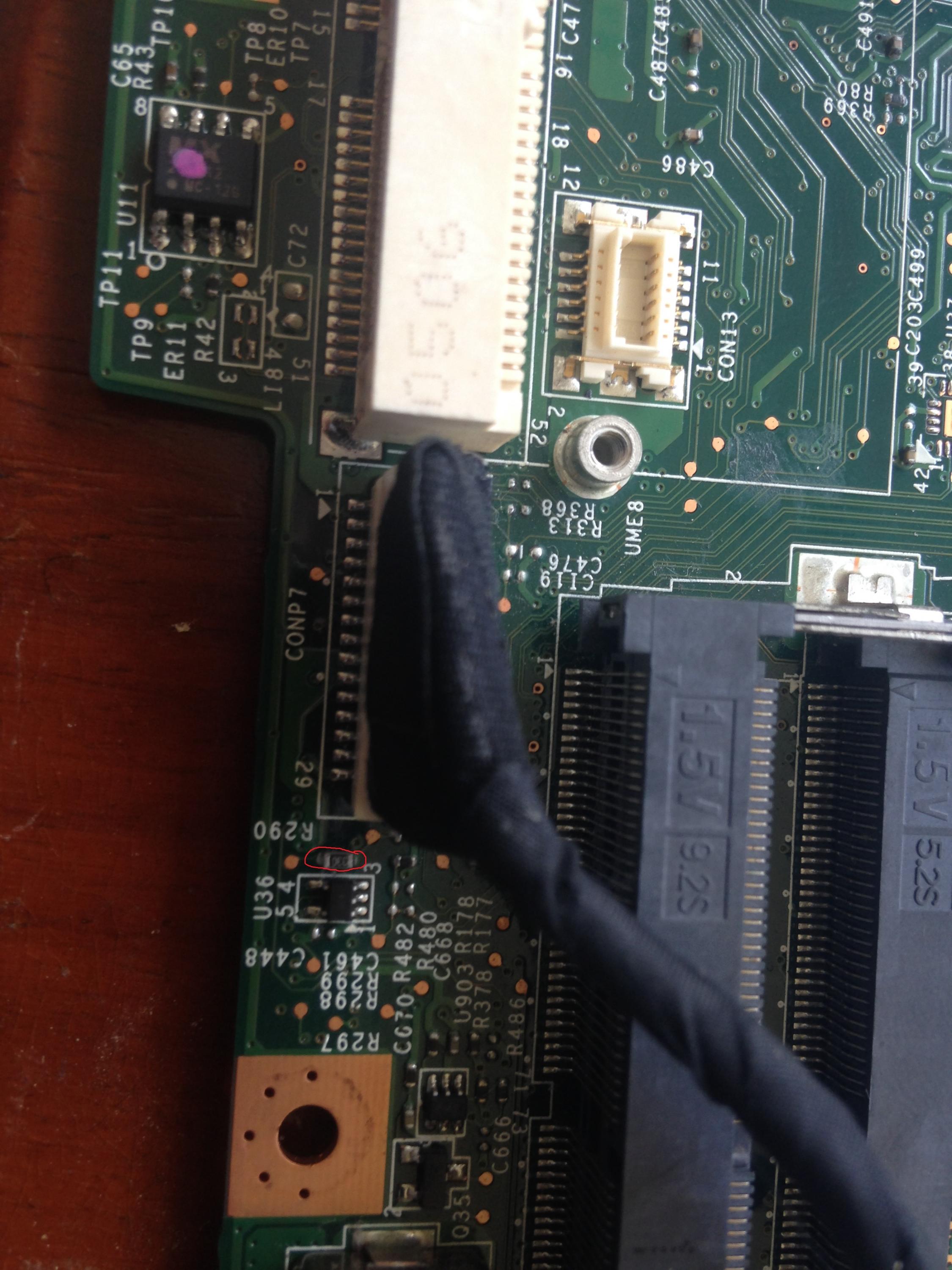

Ive change the bios chip and flash again with the file above it works but I have one problem there is no back light on the screen but when i plugged in hdmi cable display is ok . Ill tried changing the screen still there is no back light.Ive found a fuse near lvds connector its 330 .should i remove this fuse?Please help me.I had attached the image of the board and the fuse near the lvdsComment
