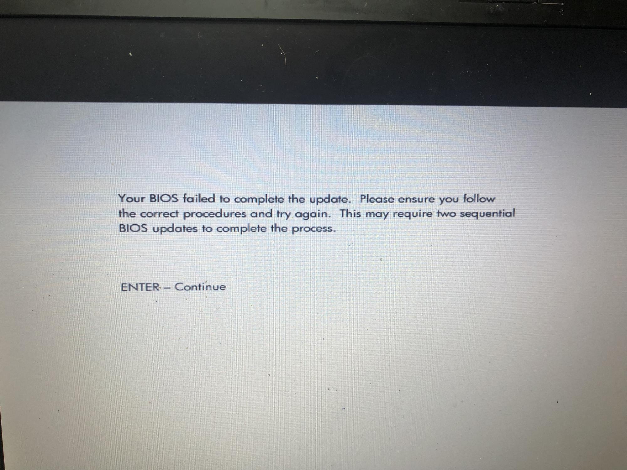

                            HP 8460p bios fix
                            I'm in this section because of my thread : https://www.badcaps.net/forum/showthread.php?t=84702
                            Please can someone check my bios file, fix it , clean ME region or something witch can maybe help with my problem? Thanks!

                              Re: HP 8460p bios fix
                              something which...
                              I try clean ME region using Intel Easy Clean Me software. Laptop with this dump POST, but shutdown problem is still here. After 1-2 sec laptop turn off by itself.
                                Different Firmware Repository beteween your 2 dumps !
                                Use Flash Image Tool better Than Intel Easy clean ME.
                                The firmware of your first bios is : 7.1.3.1053 ,SKU 5MB.
                                the second is : 7.1.10.1065 , SKU 1.5MB.
                                  Try this one .
                                    I try it. Laptop post but with some Message About bios update and problem is still here.
                                      • 20848
                                      2nd try
