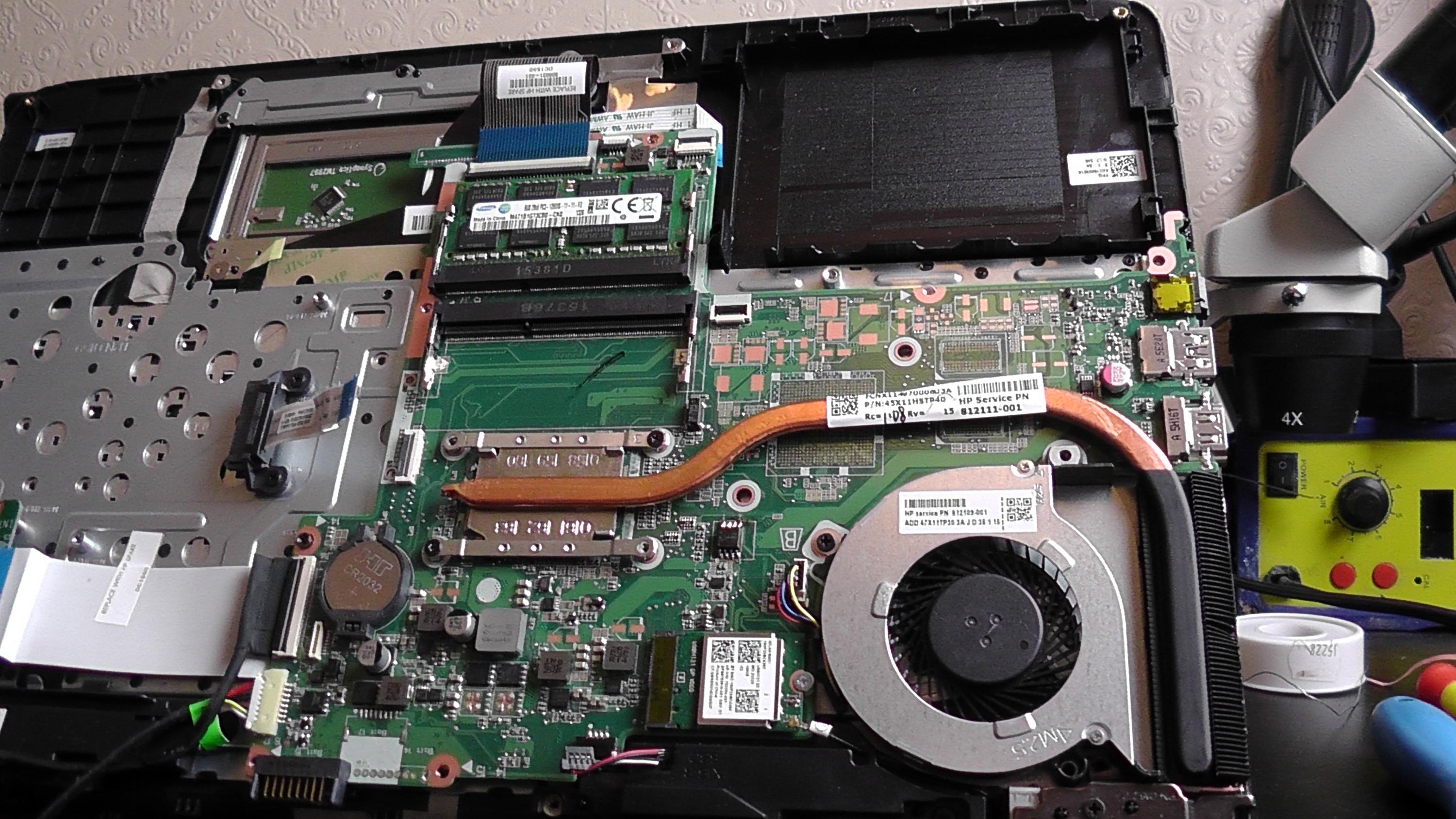

    can someone help me with this bios?
    i got charging led on white charging the battery to OJ, tough it does not trigger to switch on.
    3.3v from power button does drop. 0 activity on bios and for some reason no voltage on the bios.
    3.3v its present on the battery socket, eliminating the fact that the 3.3v not present.
    Charging and DEAD at the same time. Schrodinger Cat FFS

          so it powers up and it blinks 3 long and 2 short
          3 / 2
          The embedded controller has timed out waiting for BIOS to return from memory initialization

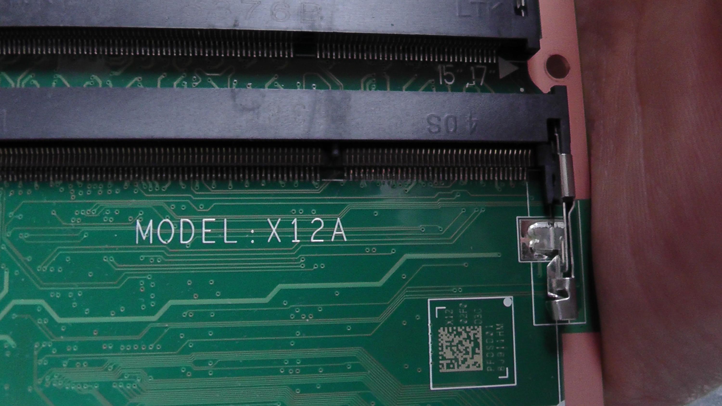

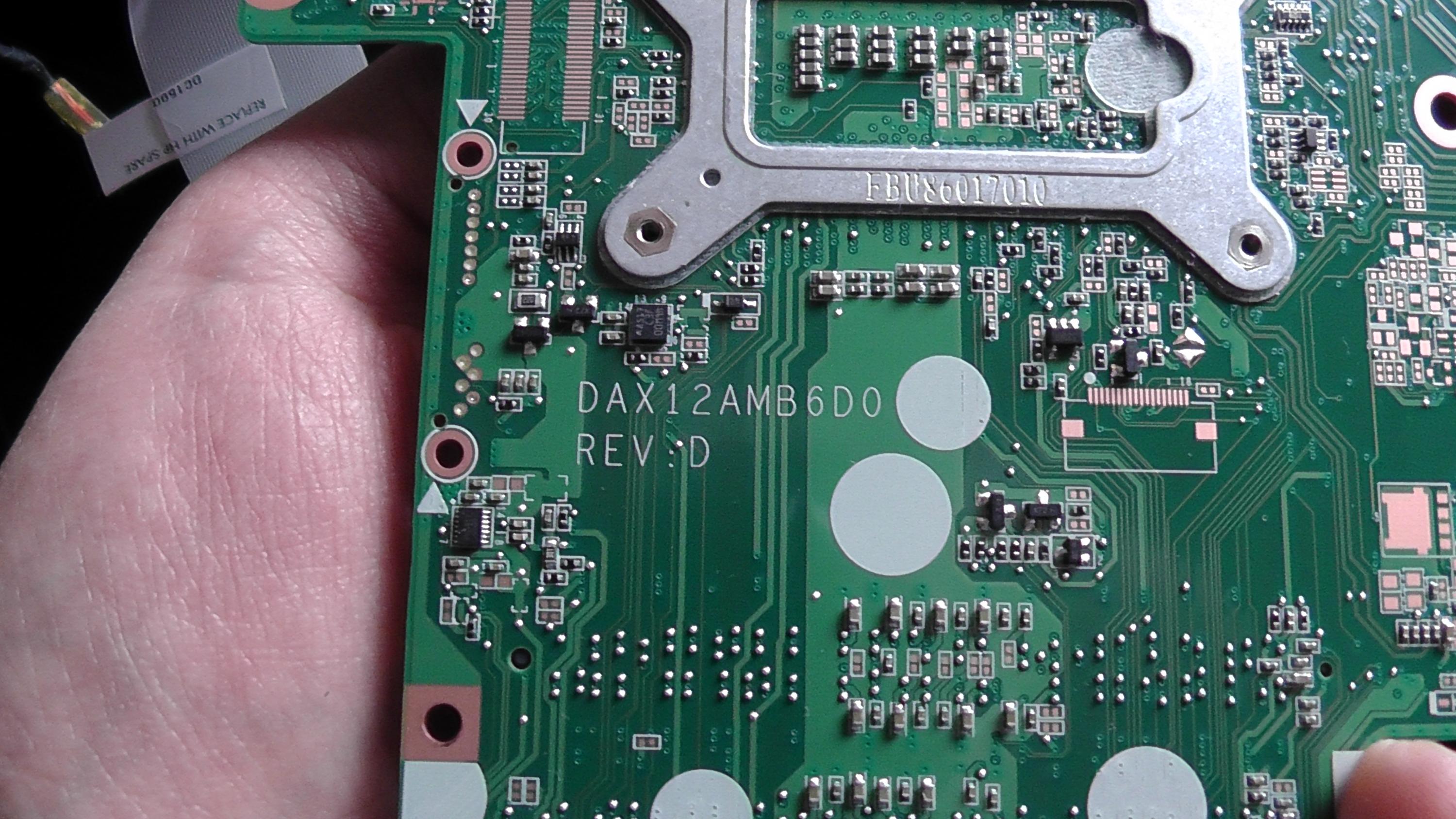

            what is the board code ? can you post a picture ?

              the screen goes black from that green tone.
              no display ofc
                Re: 15-ab219na bios help
                Well since this is a soc system which is starting and the memory controller is in cpu i would try to reflow or reball that cpu...
                  reballing its not a option for me.
                  making this a class hobby and having all the tools except the bga station.
                  got this notebook from a friend who gave quite a lot of free stuff, so i kinda own him this board to fix.
                  reflow i will do.

                      Hy.
                      Back again to this HP.
                      I reflow the CPU and I'm up and running.
                      Now there is no info in BIOS .
                      Nothing no serial no ID
                      Can someone help me infuse the serial nr ?
