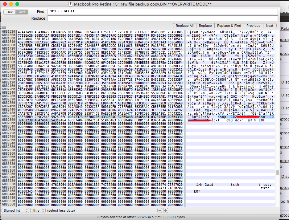

          Hi I have a Question:
          I have a couple (Macbook Pro's, Air's and Retina's) all with (EFI firmware locks)
          I'm pretty good with component level repairs and programming etc... I generally use a
          (MiniPro TL866 Programmer) to program the EFI bios chips and I have a question in regards to editing a locked EFI Chip on the mac's
          After desoldering a Macbook Bios chip placing it in the (MiniPro) reading
          the chip then opening the Bin File with a Hex-Editor is there a way to delete the Serial Number from the file Bin file so that I could use that same Bin file on multiple MacBooks of the same model ?
          For instance when I ordered a EFI Bios chip from China all I had to do was solder it to the
          macbook book and i booted without having any (Serial Number) imbedded..
          If anyone could help it would be much appreciated
