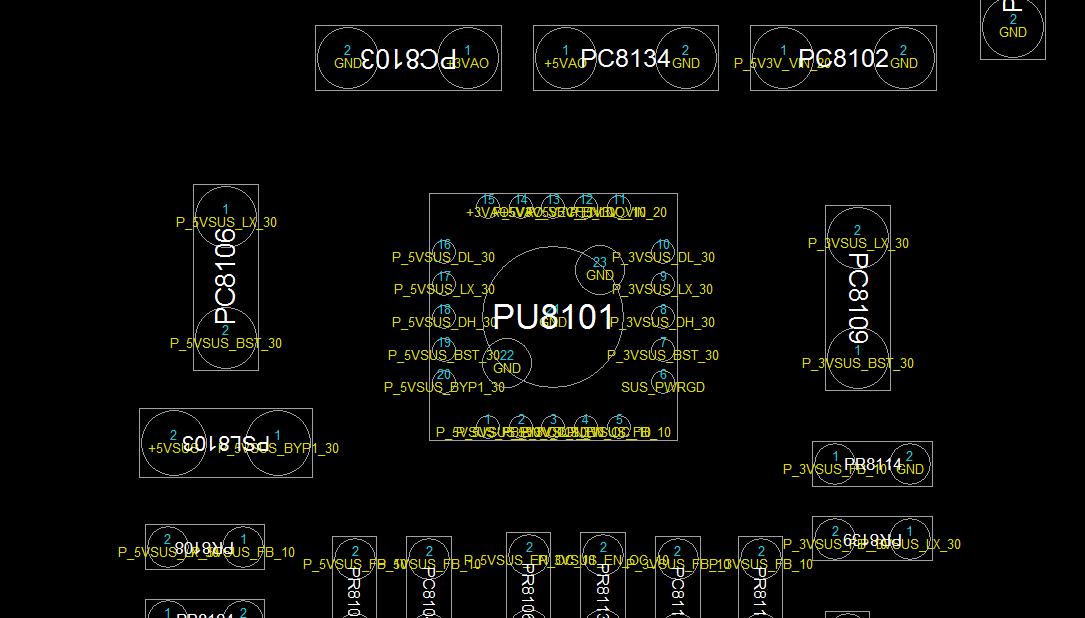

                    frenz i got heated up on RT8239BZQW in pictures is PU8101. not easy to get replacement this ic. its imposible this ic problem cause by electric static?

                        sasser , chek coils for output of that regulator , also chek LDO if present or not .
                        and if it stoped working after ram reaplcement ?? humm have you removed batery before this action ?..does asus and they bios are a pain in the ass ehhe
                        but make sure the regulator got the EN and ldos present , some asus both 3.3 and 5 v are S5 so that mean they will only show up after pressing the on off button :P
                        chek that before and flash EC
