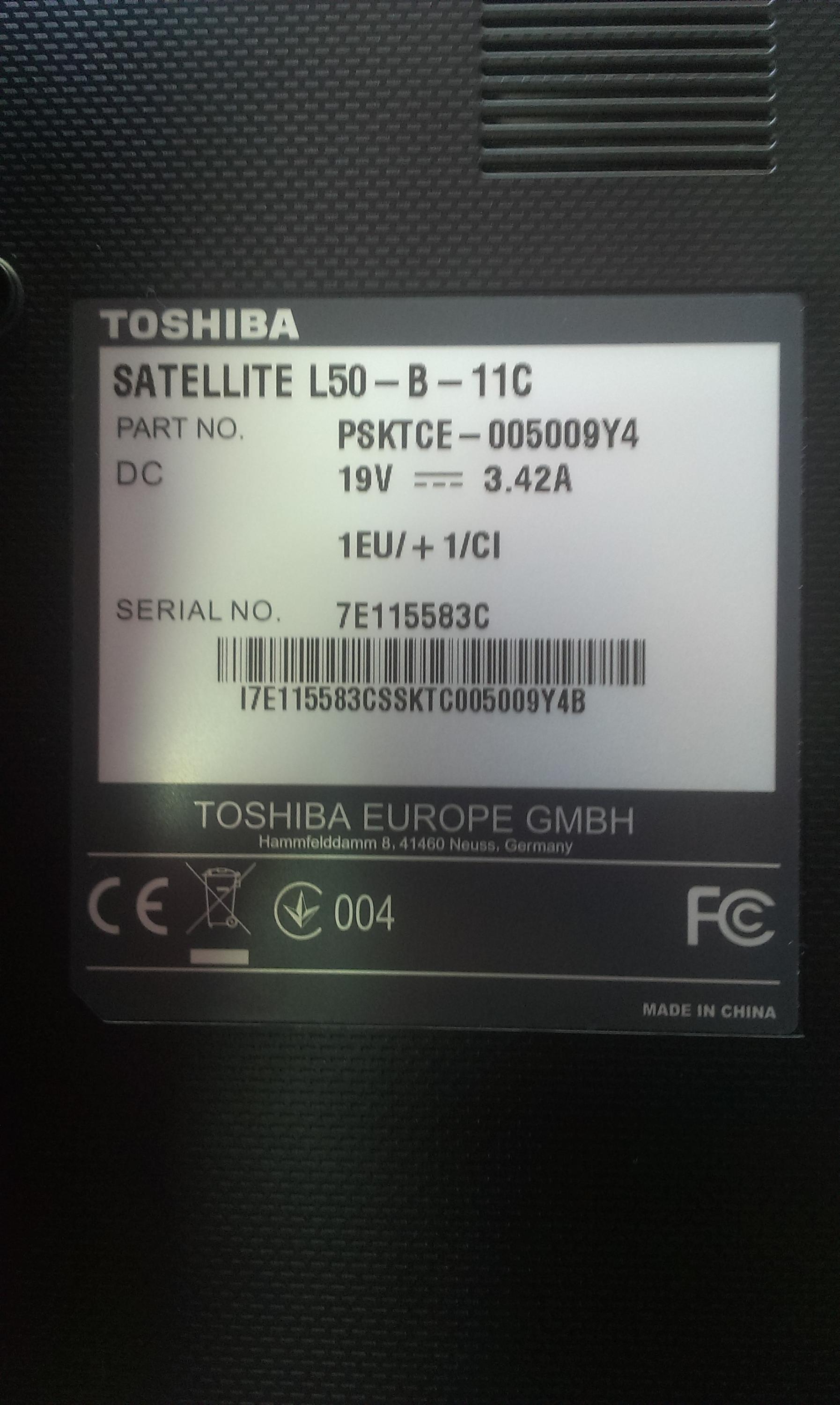

    toshiba sattelite L50-B-11C
    how to reset bios password on this model or if any have bios bin file for seeprog please upload here !!
    thanks advanced

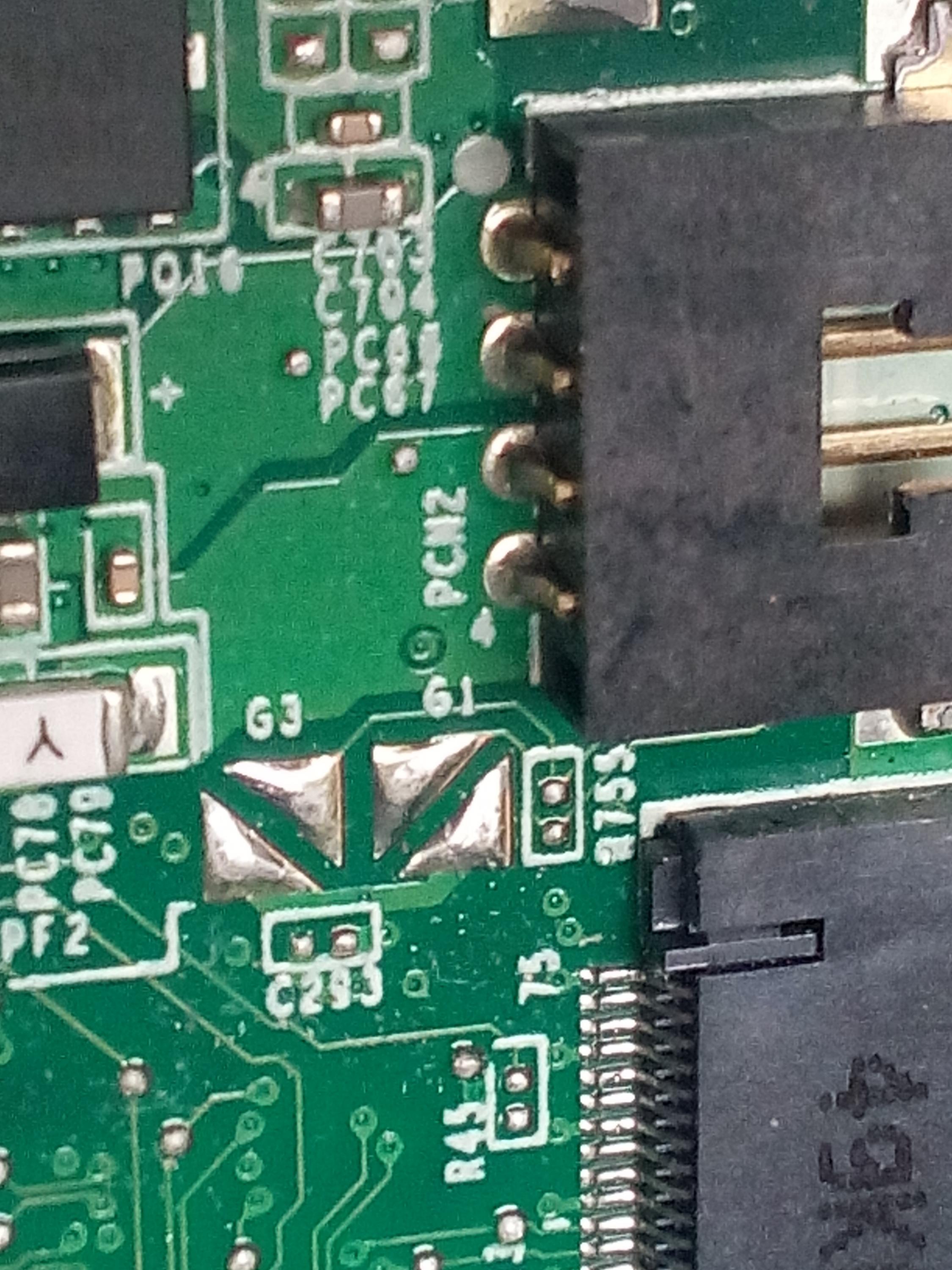

                  • bluestar77
                    • Apr 2015
                    • 57
                    • sudan
                    Re: toshiba sattelite L50-B-11C
                    Hi ,
                    If you want to reset password for this model you have to short G2 jumper it's near the CPU plug the ac adapter short this jumper and power it on don't remove the flat scrow driver form the G2 until you see the password had gone if you fail redo it again

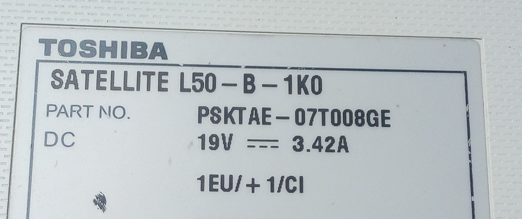

                                    • johnnie boy
                                      • Jun 2018
                                      • 2
                                      • Greece
                                      hi guys attatched is 2 photos but i cannot see the G2 only G3 ? isit marked as G3 on this particular model ? as i see that some people see G3 ?
                                      this is located directly behind the power connector
                                      thankyou
