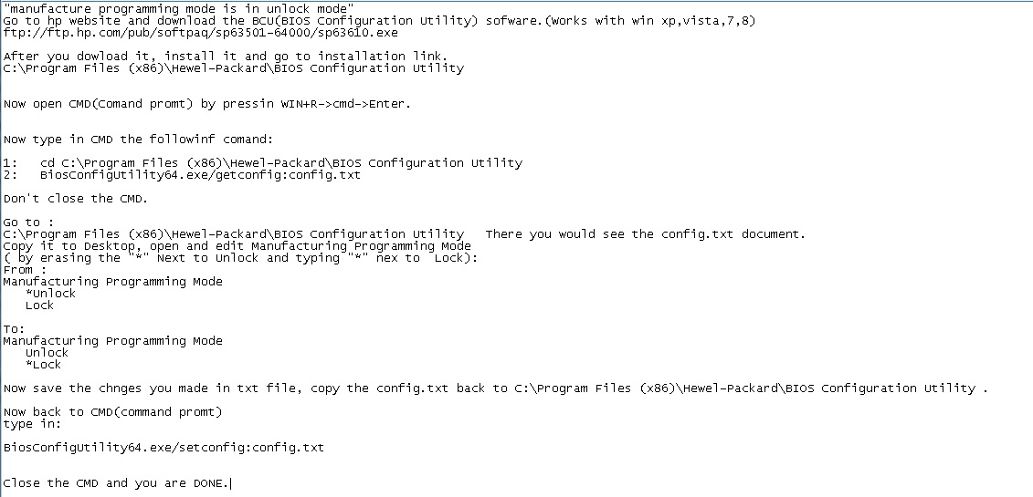

                                      Try this..
                                      Thanks, worked fo me.
