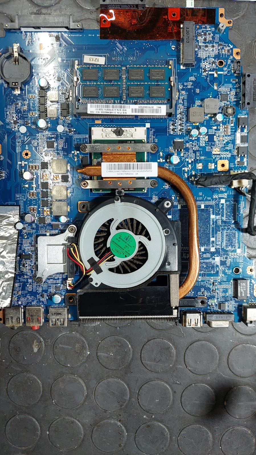

                I am asking for EMERGENCY help,
                Sony Vaio,
                MB: DA0HK5MB6F0 REV: F MBX-269
                Bios ME bios me version unknown
                The laptop turns on or off for 30 minutes.
                I'm sending my org. bin if anyone wants to fix it ..
                Thanks in advance

                  • piernov
                    • Jan 2016
                    • 4437
                    • France
                    #89
                    Re: DA0HK5MB6F0 REF R version B MBX-269 bios please.
                    With HM70 PCH, CPU cannot be Core i3/i5/i7, must be Pentium/Celeron.

                      #90
                      For me, this was a good announcement.
                      Resolved .....

                          • pronet58
                            • Apr 2019
                            • 3
                            • Los Angeles
                            #93
                            Sony Vaio,
                            MB: DA0HK5MB6F0 REV :F (B) MBX 269
                              • 21231
                              #94
                              Sony Vaio,
                              See post #89 ,what CPU do you have ?
                              • pronet58
                                • Apr 2019
                                • 3
                                • Los Angeles
                                #95
                                sr0n1

                                    • 21231
                                    #97
                                    sr0n1
                                    The sr01n is an i3-3110M .Please read post 89 again, the i CPU`s will not work,thats why its showing ME as unknown. The bios can`t be fixed,it will do nothing, change the CPU instead to a Pentium or Celeron that is compatible with the HM70 PCH chipset
                                    Ref : sve1513b1ew
                                    sve1513b1e specifications
                                    https://www.sony.co.uk/electronics/s...specifications
                                    Chipset
                                    Intel® HM70 Express Chipset
                                    Processor Name
                                    Intel® Pentium® Processor 2020M
                                    https://www.cpu-upgrade.com/mb-Intel...0_Express.html
                                      • 21231
                                      #98
                                      Re: Vaio with corrupted ME on Bios
                                      have this laptop that show on bios ME : UNKNOWN
                                      Tried to update bios from windows, doesn't work.
                                      Replaced Bios chip, still can't update bios.
                                      Ref : sve1513b1ew
                                      Can anyone please please fix my ME on my bios dump ?
                                      More proof
                                      cpu upgrade leads to 30 min shutdown
                                      https://winraid.level1techs.com/t/cp...shutdown/31790
                                      Quote:
                                      plutomaniac
                                      The Platform Controller Hub (PCH or chipset traditionally) is a chip which is soldered to the motherboard and has nothing to do with what BIOS/SPI chip you buy, reflash etc. The HM70 PCH supports only Pentium and Celeron processors and the restriction is hardware coded/enforced at the PCH itself. Nothing you do at the cpu, SPI chip or the latter’s firmware will change that fact. So the SPI image regions and/or ME firmware in those have nothing to do with this restriction.
