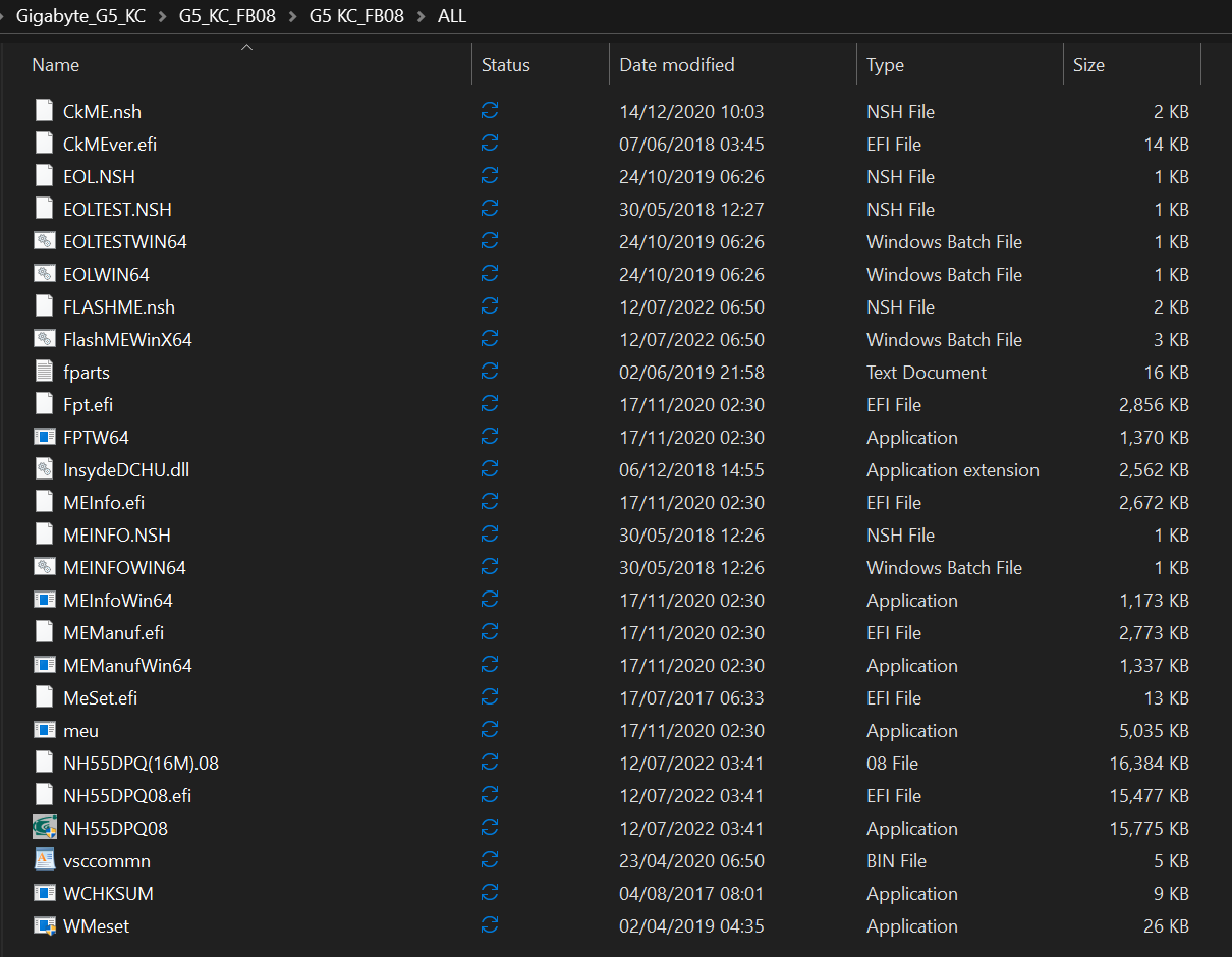

    Got my hands on this Laptop Gigabyte G5 KC (RTX3060 I5-10500H) SN2137J001149.
    The laptop starts up can see the keyboard light up and the fan spin but dosent give any image, no bios screen or anything, have tried with a external display to.
    I think what happen is that someone tried to udpate the bios but briked it in the process, does anyone has a known good dump that can send me so I can try to flash it with the programmer please?
    I have dumped the one I have at the moment in case anyone wants to check it.

    Is there a full bios image over at Gigabyte support ?

      there is, however the download is a folder with a few exe and a bunch of files, there isnt a bin one so not sure wich ones is the actual bios file.

      Any idea wich one it is?
      ty

        NH55DPQ(16M).08

          Thanks mate, will try that one
