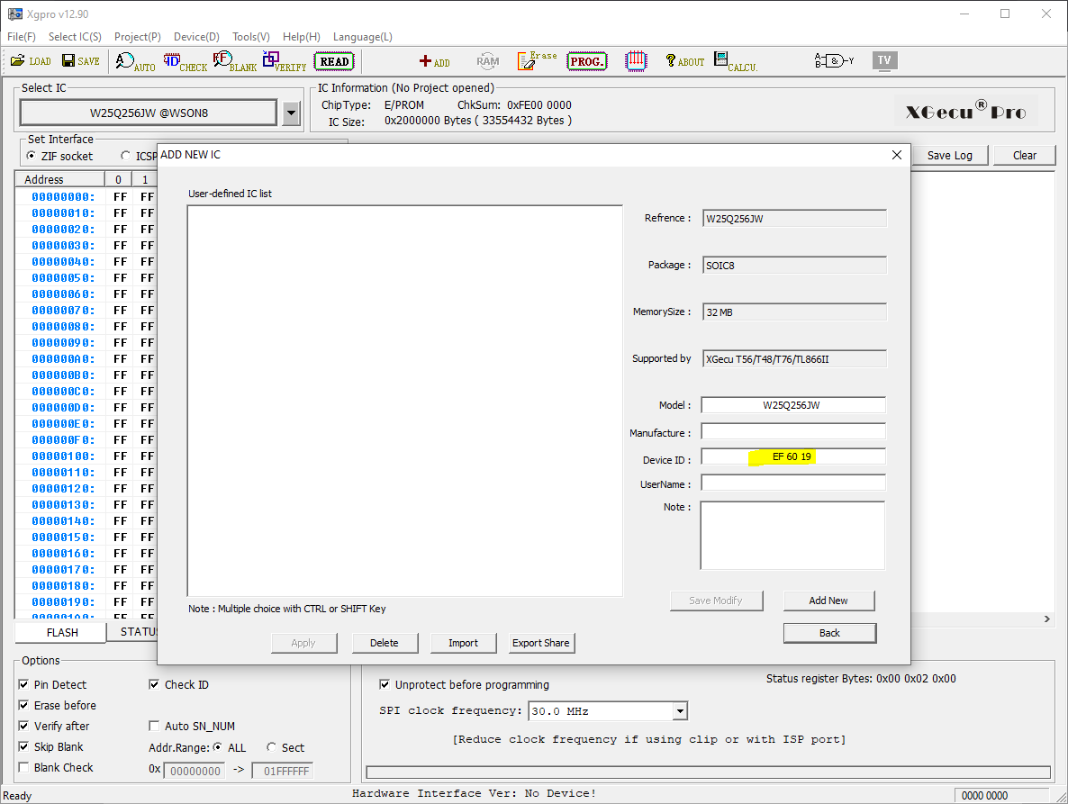

                  For the T56, I think the W25Q256JW is close enough, it may work

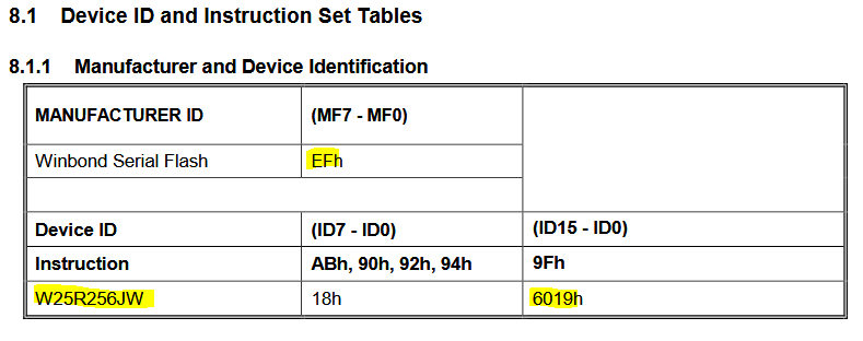

                  According to W25R256JW datasheet the device ID is the same EF 60 19
                      yes, that worked.

                        Noted, as I have T48 programmer
                        W25R256JW == W25Q256JW
                        Same should also work for W25R128JW, select W25Q128JW
