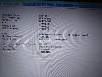

      Thank you brother.. 🙏 my laptop is back on but I found the problem of invalid mtm, invalid lenovo sn, invalid uuid number
      Can you help me again?
      Click image for larger version  Name:	17466913319842392448706273208452.jpg Views:	0 Size:	4.82 MB ID:	3632214

        I copied the DMI block to the new file already ?
        Click image for larger version  Name:	2025-05-08 15_07_38-HxD - [F__V14 G2-ALC Laptop (Lenovo) - Type 82KC.bin].png Views:	0 Size:	1.67 MB ID:	3632220

          This is a non_DMI bios.
          To add DMI, find on forums keyword " Golden key ".

            It's not really important, I'll study it later.. thank you very much for helping me 🙏😊
