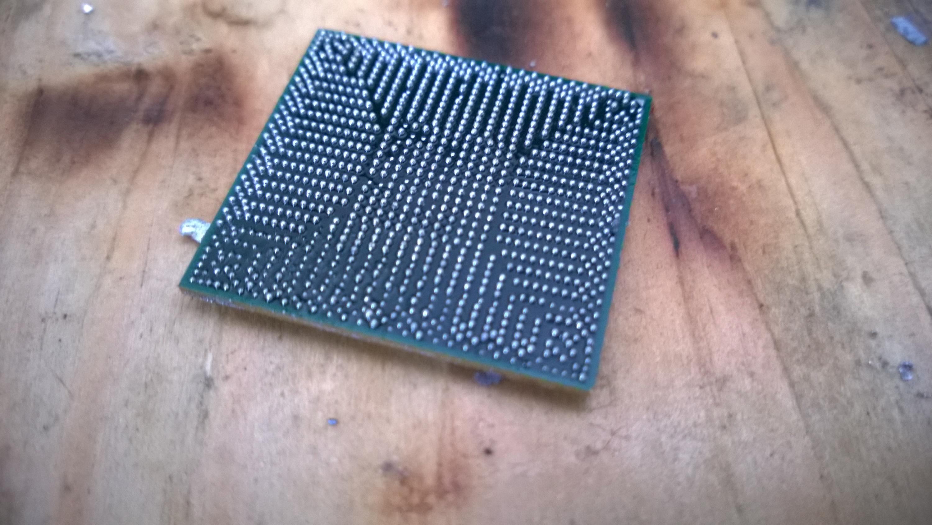

    ok, as almost all the time, i have a friend hp with no screen problem. i see it has a intel i3, and ati gpu. after open it it had lot lot of dust. cleaned it all, cleaned also board with ipa as always. plugged some cable, power on and pc just started telling me it has no wifi and no cmos battery. i turned it off (removing ac power cable instead of powering it off by botton). reassembled and then pc just do nothing on pressing power botton. after try a bios reflash as shown here
    but i think bios rom was too big. now pc start with fan at max speed, but no post. it power off after some times. and when i repower on it keep on but no post and fan stop after a time even if it get hot.
    does anyone got a bios dump ?
    do i need a bios dump from you guys because vendors didnt make them public on their site?
    edit: just pluged in keyboard and caps lock keep blinking. ram coil has 1.5volt.

    reballed vga and still the exact same problem :S
    edit: all voltage are present at coil....

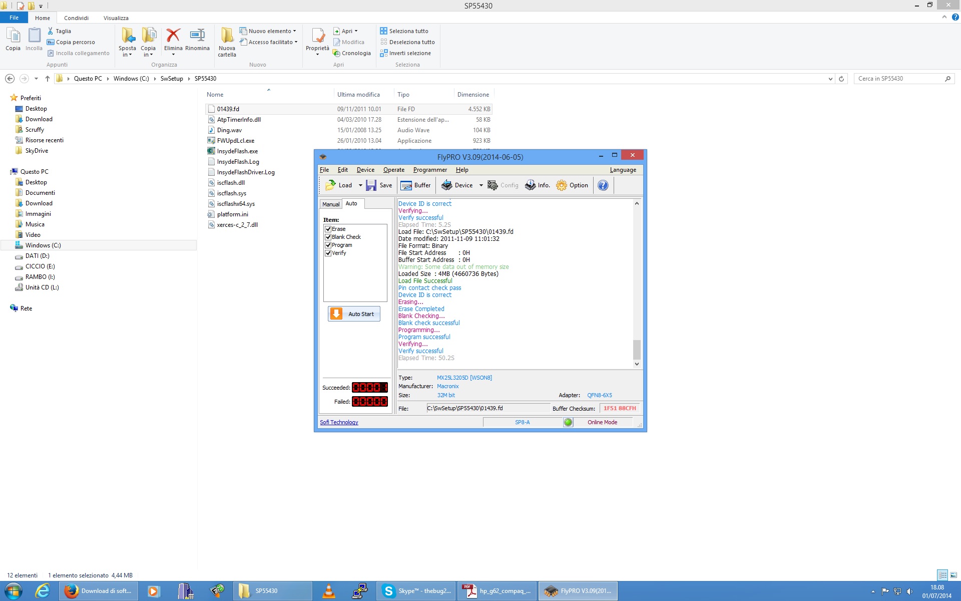

        tnx for reply. as the attached picture ive gone to hp site, downloaded and extracted. then with a usb programmer, i desoldered bios chip, and flahed like whown in the picture, but somewhere i read that i need a proper bios dump file to program some kind of bios chip, as mine in the image told me it was bigger then 4mb space.
        how ever before doind that pc wont even turn on. now turn on... and after some 20 seconds it tutn off, then on again but no screen. tried a reball of the vga but still nothing.

          Re: hp g62-a022sl bios dump.
          if the file its bigger then its not the same!
          I did a few weeks ago a cq and there still is the post around here.
          nvm I use the file from hp; the only down side is that it got no serial.

            tnx, as far now pc power on fan and led blink, my bios is ok.
            just i dont hear hard disk spin, so can be the ec chip that need to flash too ?

              what size do you have on bios?2,4?
              do you got another chip like that with 512kb?

                bios chip is 4mb. yes it has another rom for ec chip.

                    ok, flashed ec file (i suppose is for power light indicator and some staff like that maybe already working) and laptop do exactly the same
                    strange thing is that if i remove ram... it do still the same.

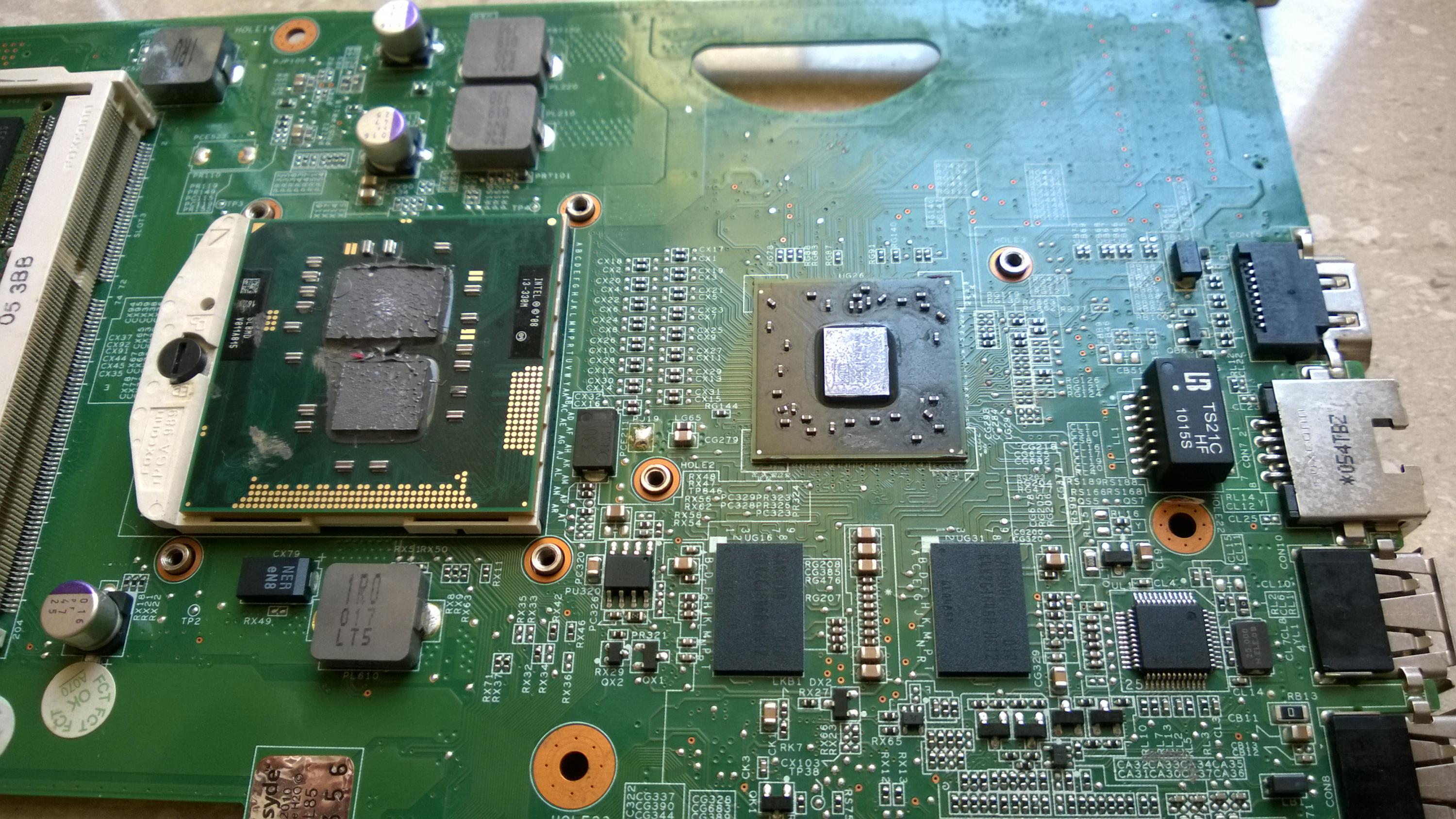

                      can you post a pic without heatsink?

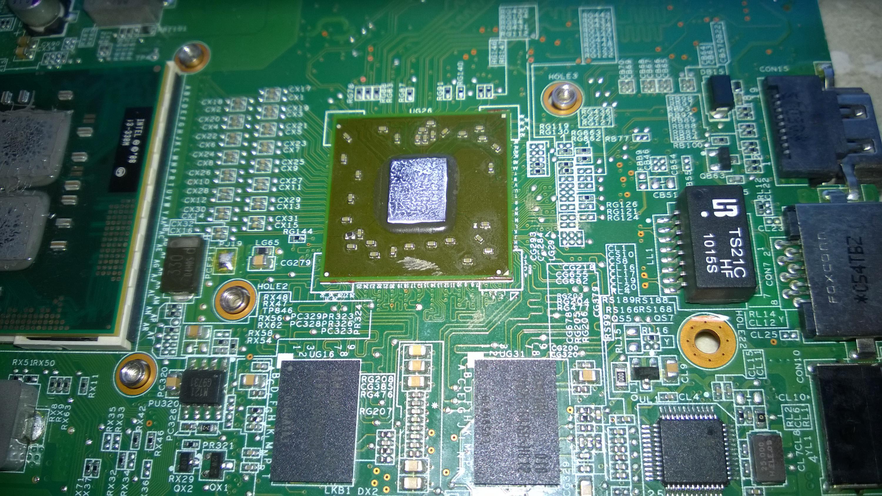

                        the not good positioned resistor up vga chip is now ok.

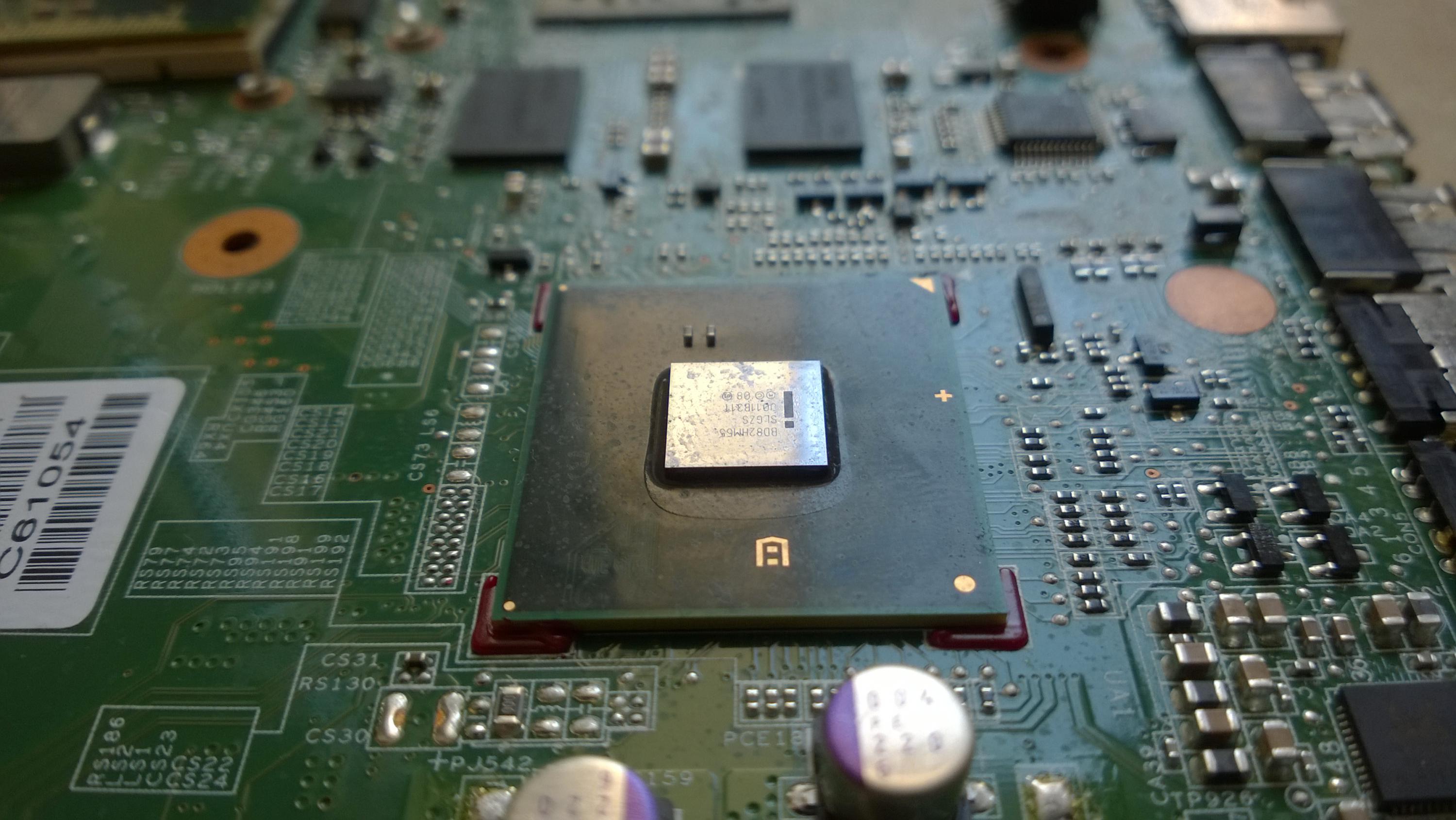

                        the last thing to do is try a sb reball.
                        the strange thing is that notebook started ok once. after cleaning with ipa and mount it again wont start annymore.
                        maybe some bad solder joint....

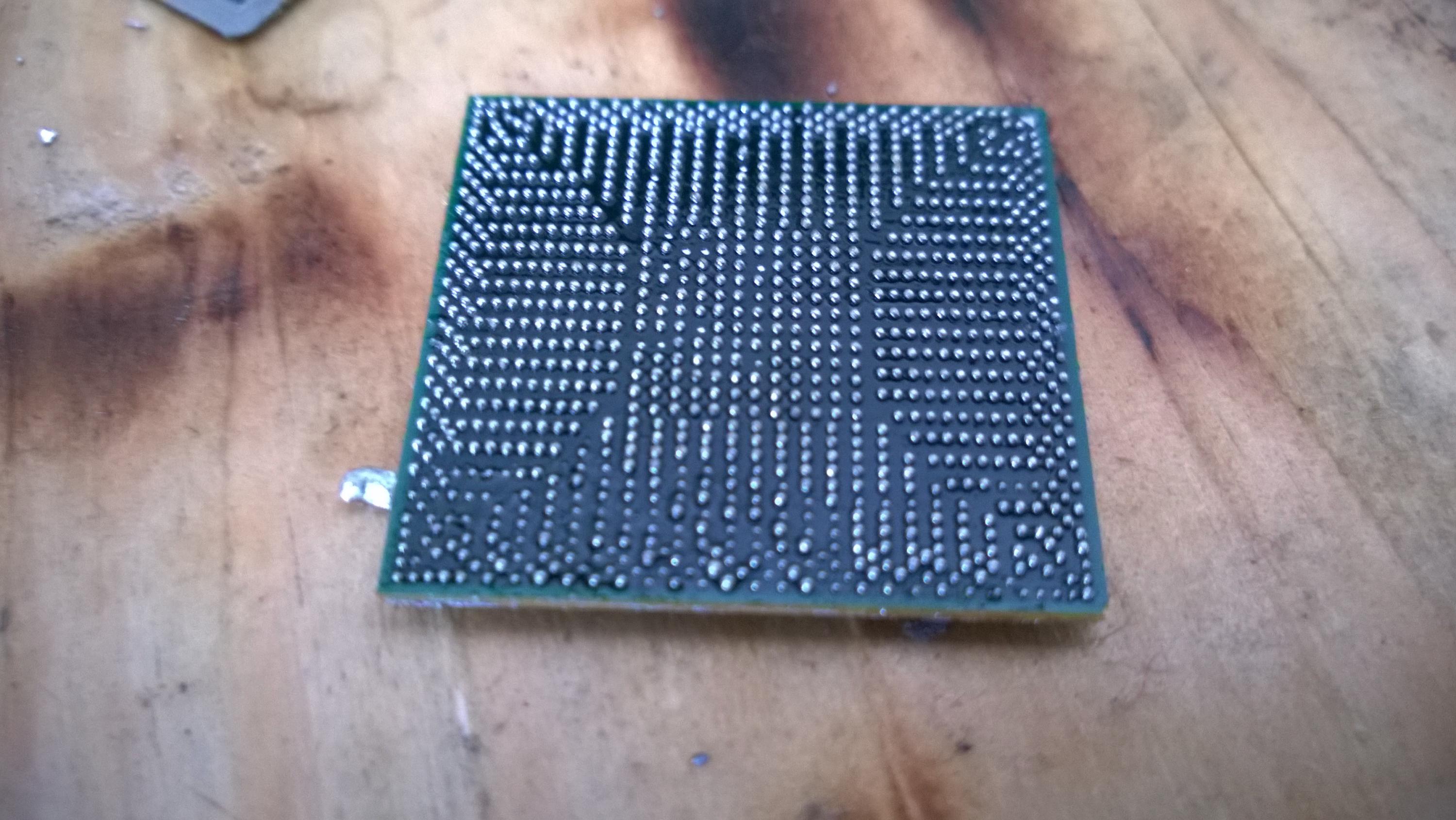

                                doing that....... just let's see if it works. my question is ... i reballed vga... maybe that wasnt the problem
                                https://www.youtube.com/watch?v=IgH98o3cu0A
                                here some talk about bad solder on mainboard, some that is vga problem... but if it's vga problem then my reball has gone bad ?
                                edit: tryed that toast and didnt work. reballing for the second time gpu...
                                  edit2: ok did a new reball of the gpu and still the same....
                                  hit quote insted of edit...
