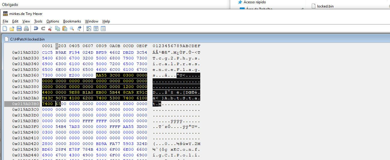

    I have performed all the steps and tried several times, changing the name only to locked without the .bin, I tried all the scripts, none of them work.

      You havn`t posted any information, nothing, can`t help you without that..
        You're right, when I published it seems there was some kind of damage since it didn't finish uploading the information.
          did you copy your main bios into the DMICOPY folder, and rename it to locked.bin (with only 1 file extension .bin ,not .bin.bin) .If the full script doesn`t work try the seperate ones. Which model is it etc ?
